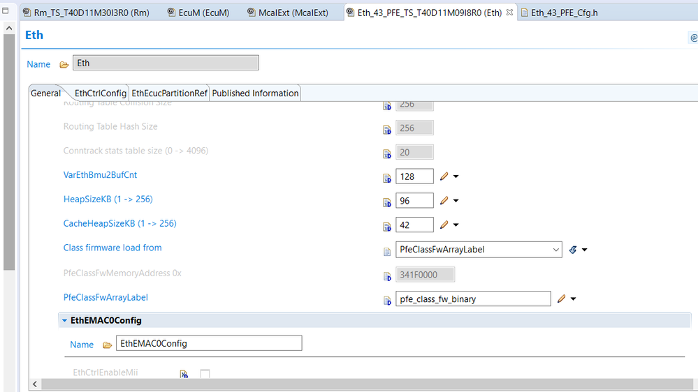

The issue that I mentioned earlier has been resolved. The issue was related to MCU Clock Configuration. Now we are facing other error while trying to read the pfe version from pfe_platform_init. You can see the images. While trying to read the pfe version , bus fault exception is triggering from the Os. we are not using the core partition and we don't have a memory mapping in the linker script at the moment, as we are in the beginning stage of  the project. Is the issue is related to missing of proper memory mapping? you can see the screen shot from lauterbach  and tresos configuration below.

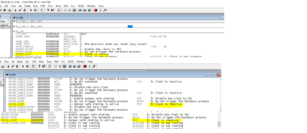

Imsiya
Thanks for the detail updates. Unfortunately, our issues are not resolved. Still Eth_43_PFE is not initialized.
We are facing issues in MCU PFE Partition clock. Only PRTN_STAT0 Clock is active PRTN_STAT1 and PRTN_STAT2 are Inactive. Below the register value of PRTN2_STAT is zero. How can we set this to 1?
We have done MCU configuration. Any Port configurations are required to enable these clocks?

Please see the tresos configuration below.

Daniel-Aguirre
It is said on the S32G2 Reference Manual [Chapter 28.12.7, Page 1079, S32G2 Reference Manual, Rev. 6, 11/2022] that to enable the partition clocks, you should use the corresponding "MC_ME_PRTNn_PCONF[PCE]", is this being done inside the application? Image below:
Please, let us know.
3,843 Views
Imsiya
MC_ME_PRTNn_PCONF[PCE] for Partition 0 is enabling from CMM script. We don't have application SWC component to enable the partition clock at the moment.
We tried to enable the Partition 2 clock (MC_ME_PRTN2_PCONF) from the CMM as similar to Partition 0. But still the clock is not activated.
Also we couldn't see the registers for enabling core 0 for partition 2 as similar for Partition 0. Could you please tell, can we enable the partition2 clock from the cmm ? If yes what is missing in our cmm?
