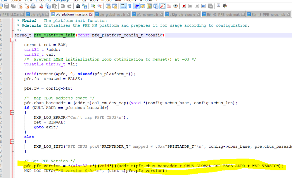

The issue that I mentioned earlier has been resolved. The issue was related to MCU Clock Configuration. Now we are facing other error while trying to read the pfe version from pfe_platform_init. You can see the images. While trying to read the pfe version , bus fault exception is triggering from the Os. we are not using the core partition and we don't have a memory mapping in the linker script at the moment, as we are in the beginning stage of  the project. Is the issue is related to missing of proper memory mapping? you can see the screen shot from lauterbach  and tresos configuration below.

Thanks for the information. We will provide this additional information to our internal team to confirm if the memory mapping inside the linker file is needed for this situation.

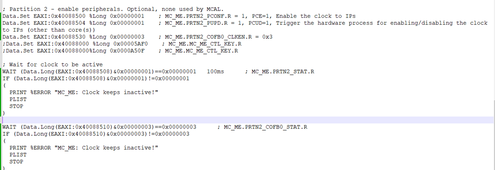

MC_ME_PRTNn_PCONF[PCE] for Partition 0 is enabling from CMM script. We don't have application SWC component to enable the partition clock at the moment.
We tried to enable the Partition 2 clock (MC_ME_PRTN2_PCONF) from the CMM as similar to Partition 0. But still the clock is not activated.
Also we couldn't see the registers for enabling core 0 for partition 2 as similar for Partition 0. Could you please tell, can we enable the partition2 clock from the cmm ? If yes what is missing in our cmm?
