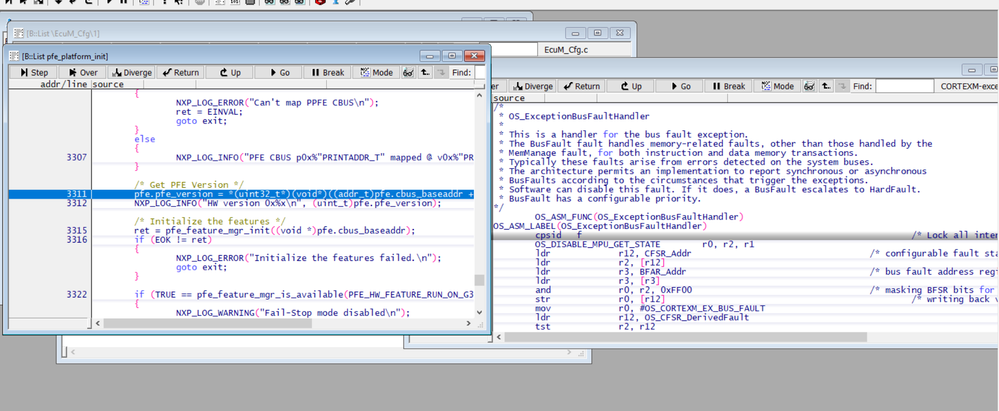

The issue that I mentioned earlier has been resolved. The issue was related to MCU Clock Configuration. Now we are facing other error while trying to read the pfe version from pfe_platform_init. You can see the images. While trying to read the pfe version , bus fault exception is triggering from the Os. we are not using the core partition and we don't have a memory mapping in the linker script at the moment, as we are in the beginning stage of  the project. Is the issue is related to missing of proper memory mapping? you can see the screen shot from lauterbach  and tresos configuration below.
Request your support.

Daniel-Aguirre
Thanks for the information. We will provide this additional information to our internal team to confirm if the memory mapping inside the linker file is needed for this situation.

Daniel-Aguirre
We have received the following information from our internal team:
"I would suggest to check following steps before loading PFE driver
And then please suggest to follow PFE MCAL driver integration manual to complete PFE driver integration. It should be careful about PFE memory allocation which is descripted in Chapter 8."
