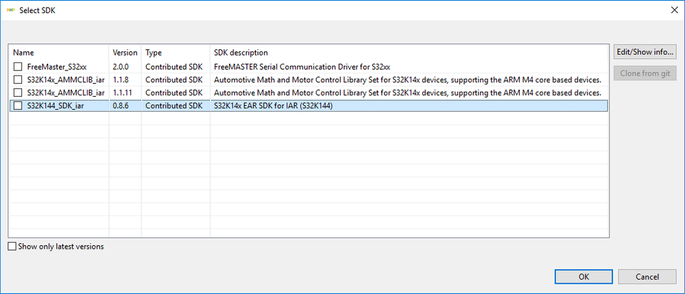

I am using latest version of S32 DS , I have created one application project with IAR compiler setting after clicking finish I can't able to see processor export means its not generated with processor export file . is their any option availed to enable processor export

may be you are facing the same issue like on this thread - https://community.nxp.com/thread/480465  no SDK present in your project.

Pls find the following attachment ..when I select IAR compiler their is no option to select SDK ....when I select default S32 tool chain that time I can able to see different SDK options

Make sure you have installed all of the updates and have installed the SDK. The SDK does not come with the base S32 Design Studio for ARM installation. If you install the latest update, S32 Design Studio for ARM 2018.R1 - Update 6 available , then you'll have everything you need.
Then, when you create your new application project using the wizard, you should have options similar to this for toolchain:
I have IAR EW 8.1, the options listed may vary depending upon which version of IAR you have. Please see the release notes (ex. C:\NXP\S32DS_ARM_v2018.R1\S32DS\S32SDK_S32K14x_RTM_2.0.0\ReleaseNotes.pdf) for more details.
Then, when you will see some options, depending on which IAR Toolchain for ARM version you chose.
For legacy, 7.x:
For 8.x:
Hope it helps,
Mike
