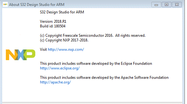

hi kral Thanks for reply
pls find the above images

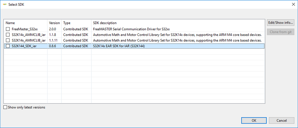

Then, when you create your new application project using the wizard, you should have options similar to this for toolchain:
I have IAR EW 8.1, the options listed may vary depending upon which version of IAR you have. Please see the release notes (ex. C:\NXP\S32DS_ARM_v2018.R1\S32DS\S32SDK_S32K14x_RTM_2.0.0\ReleaseNotes.pdf) for more details.
Then, when you will see some options, depending on which IAR Toolchain for ARM version you chose.
For legacy, 7.x:
For 8.x:

jiri_kral
what is your S32DS Version?
Jiri
4,178 Views
rajesh057
Latest version 1.0
4,178 Views
jiri_kral
Well, I mean which S32DS type - for example S32DS for Power, for ARM or for Vision and which version - like v2017.R1 and so on.
