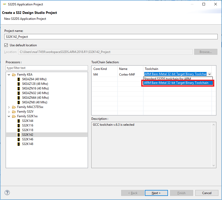

  • S3214x SDK RTM 2.0.0. This is a cumulative update - it includes all the content of previous updates (Update 1, Update 2, Update 3, Update 4, Update 5)
    • To select the new SDK in the New Project Wizard, the Toolchain must be changed to 'ARM Bare-Metal 32-bit Target Binary Toolchain'

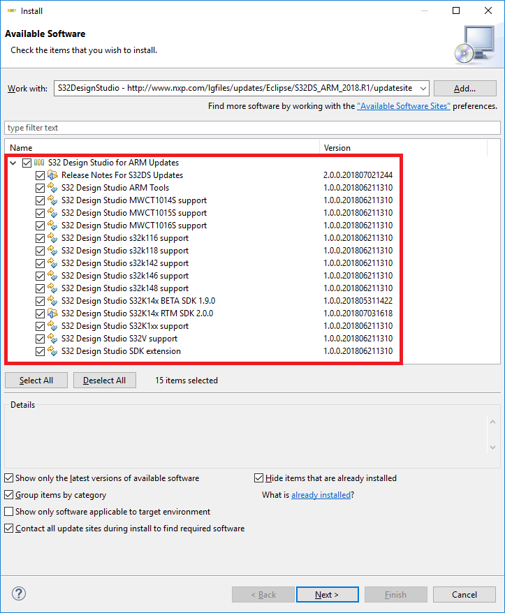

The update is available for online (via Eclipse Updater) or offline installation (direct download link)
  • offline installation:
    • go to S32 Design Studio for ARM product page -> Downloads section or use direct link to download the update archive zip filepastedImage_9.png
    • Start S32DS and go to "Help" -> "Install New Software..."
    • Add a new "Archive" repository and browse to select the downloaded update archive .zip file you downloaded in the previous step
    • Select all available items and click "Next" button.
This will starts the update installation process.
