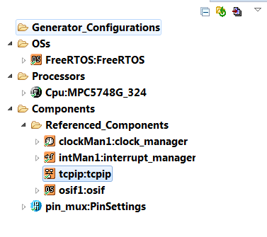

What is the difference between components and referenced components?What difference does it make to pin_mux:PinSettings if I put one of the components from Components folder to Reference Components?
Below is a snapshot of my Components Window for my project.

in the Referenced Components are components required by other components. For example - LPUART requires OSIF. When you add LPUART, OSIF component is automatically added into Referenced Components.
