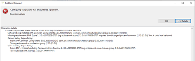

i tried to install IAR plugin into S32DS but get the following errors ,
Operation details
Cannot complete the install because one or more required items could not be found.
Software being installed: IAR Common Components 3.0.0.202011101213 (com.iar.common.feature.feature.group 3.0.0.202011101213)
Missing requirement: EMF Ecore 2.13.0.v20170609-0707 (org.eclipse.emf.ecore 2.13.0.v20170609-0707) requires 'bundle org.eclipse.emf.common [2.13.0,3.0.0)' but it could not be found
Cannot satisfy dependency:
From: IAR Common Components 3.0.0.202011101213 (com.iar.common.feature.feature.group 3.0.0.202011101213)
To: org.eclipse.emf.ecore.feature.group [2.13.0,3.0.0)
From: EMF - Eclipse Modeling Framework Core Runtime 2.13.0.v20170609-0707 (org.eclipse.emf.ecore.feature.group 2.13.0.v20170609-0707)
To: org.eclipse.emf.ecore [2.13.0.v20170609-0707

I don't know if it solved the problem, but there is no answer, so I answer.
In my opinion, what I used to do in the past seems to have changed some dependencies.
After seeing the missing EMF message, I accessed the Eclipse site and received the version of the emf package that caused the problem and installed it directly from S32DS.
Get the EMF-Updates-2.13 file from http://download.eclipse.org/modeling/emf/emf/builds/release/2.13/index.html
Select the compressed file downloaded from Install New Software -> Add -> Archive and install all EMF related files. So I solved this problem.
I hope you have good results too.

steven_zhang
Contributor V
it works ,thanks.

Was there ever a solution to this?  I am facing the same issue while trying to install S32DS Version 2018.R1 and IAR Embedded Workbench 8.30.1.  They worked great together on my previous laptop, but installing them on my new one using the same installers is producing the issue described above...  (and shown below in the snapshot.)

you are probably trying install unsupported IAR version - https://community.nxp.com/t5/S32-Design-Studio/IAR-Plugin-Issue-for-S32K-Design-Studio/m-p/1190948#M...

I tried the S32DS 2.2 get the same error.
9,887 Views
jiri_kral
here is step by step guide how to install lAR plugin - https://community.nxp.com/t5/S32-Design-Studio-Knowledge-Base/HOWTO-Install-IAR-Eclipse-plug-in-into...
