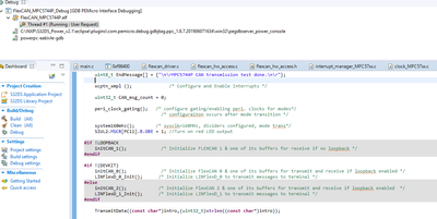

I'm trying to send and receive CAN signals periodically using the DEVKIT MPC5744P on the CAN0 port. The FlexCAN example program included with the S32 Design Studio for this DEVKIT sends signals on CAN2 with loopback. I've tried to modify the same code to send and receive on CAN0 since this port has the transceiver signals with CANH, CANL and Gnd output pins with which I can monitor the CAN communication. I'm trying to monitor the CAN bus using a Vector CANcase HW and Vector CANoe software. But all I see is error frames even though I've connected a termination resistance of 120 ohm across the CANH and CANL.
I'm not sure what is wrong with my code.
Could someone please share example code for the above scenario?
Also are there any hardware/jumper pin settings that need to be taken care on the DEVKIT?

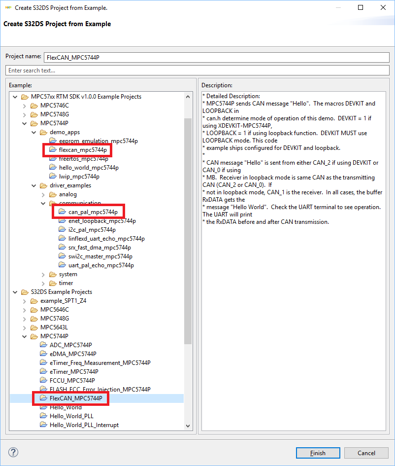

There are 3 possible examples that you could be working from. 2 are from the SDK, and one is without SDK.
Which example are you using as your reference?
Would you mind providing your project from the workspace so we could examine it?
If you are using the SDK, then perhaps there are some settings in the SDK which you need to change, but missed.
There's no jumpers which directly affect the CAN. You can check for yourself.  https://www.nxp.com/downloads/en/schematics/SCH-29333.pdf

I made some progress - the directions are incomplete.  I found the 4 jumpers and was able to debug with the usb little connection while using the 12V source for the analog.  But this debugger isn't well behaved - can't reliably single step - jumps around, not good.

What about optimizations? If optimizations are enabled, the debug may behave in strange way.

Turning of optimizations helped.  Still no CAN0 working yet.  The sample project doesn't work either:
