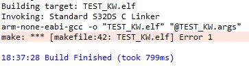

My customer, Mando, installed the S32DS for ARM 2.2 and created a very simple application project with S32K144 SDK. When he tried to build it, he faced a build error below but it was shown on his laptop only.
I received his project file and tried to replicate it, but there was no build error. In addition, the issue was the same though he re-installed the S32DS and SDK, and there was no issue when he installed it on the laptop of his colleague, Would you please give me some advice for what we should check?
If you need further information or screenshot, please let me know.

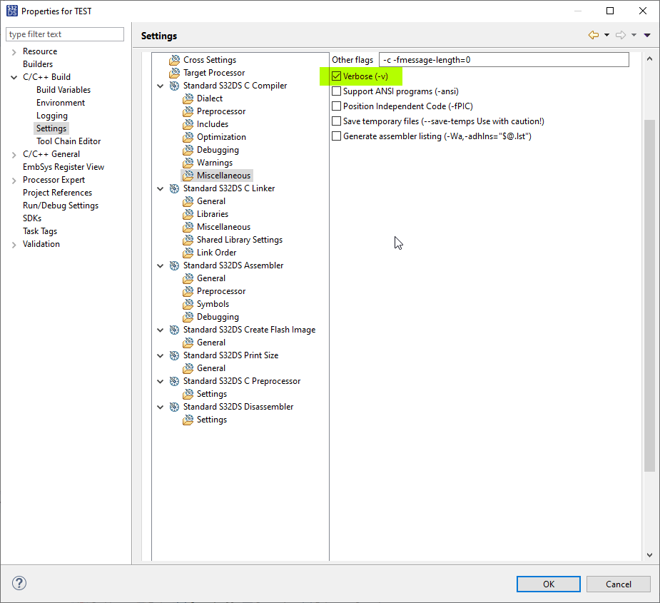

jiri_kral
Hi James,
I just imported customer's project into Workspace, but can't see any issue. Project is normally built. Please ask customer for full build console output with verbose mode:
Jiri
