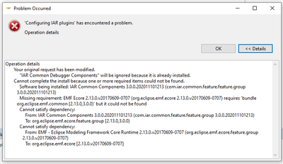

We followed same procedure as per HOWTO: Install IAR Eclipse plug-in into S32 Design... - NXP Community  and we are facing IAR plugin issue for S32 Design Studio. Getting below error.

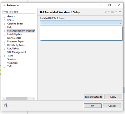

When I checked window->Preferences
then not getting IAR Embedded Workbench but it is already installed and all updated are also installed.

jiri_kral
what's you S32DS Version?

chaitanya_kalyani
Hello @jiri_kral ,
We are using S32K Design Studio 2018.
2,999件の閲覧回数
jiri_kral
this old S32DS supports IAR compiler v7.x and v8.11.2 . If you later IAR version, please use S32DS for ARM v2.2 - https://community.nxp.com/t5/S32-Design-Studio-Knowledge-Base/S32-Design-Studio-for-ARM-2-2-Windows-...
