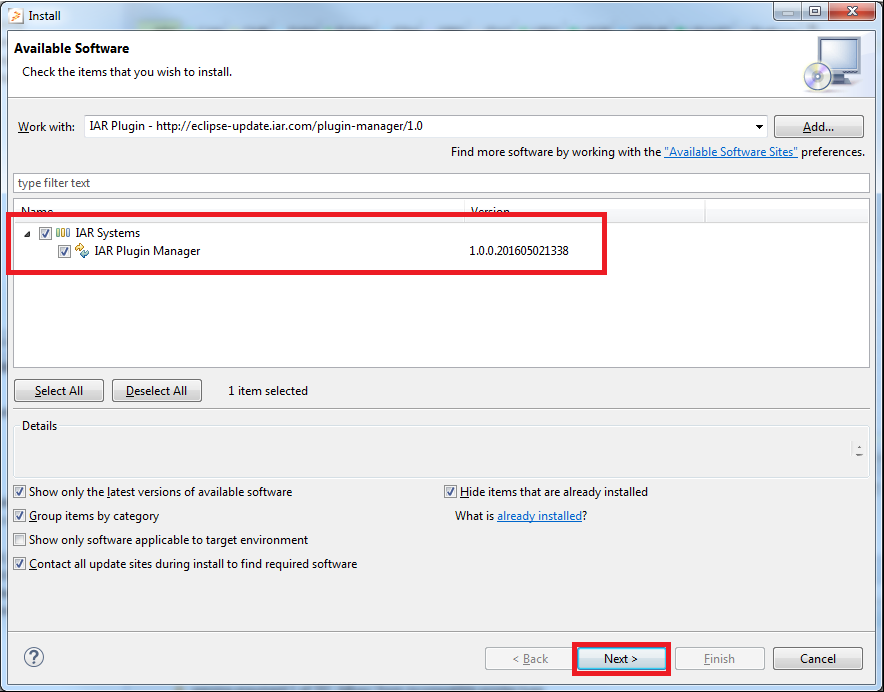

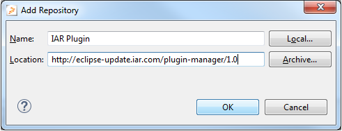

1. Install IAR Plugin manager

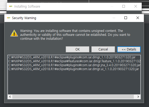

  • Tick " I Accept the terms of the license agreement" and click "OK" to accept unsigned content software
  • Finally you proceed to the installation. When the plugin is installed you will be asked to restart S32DS

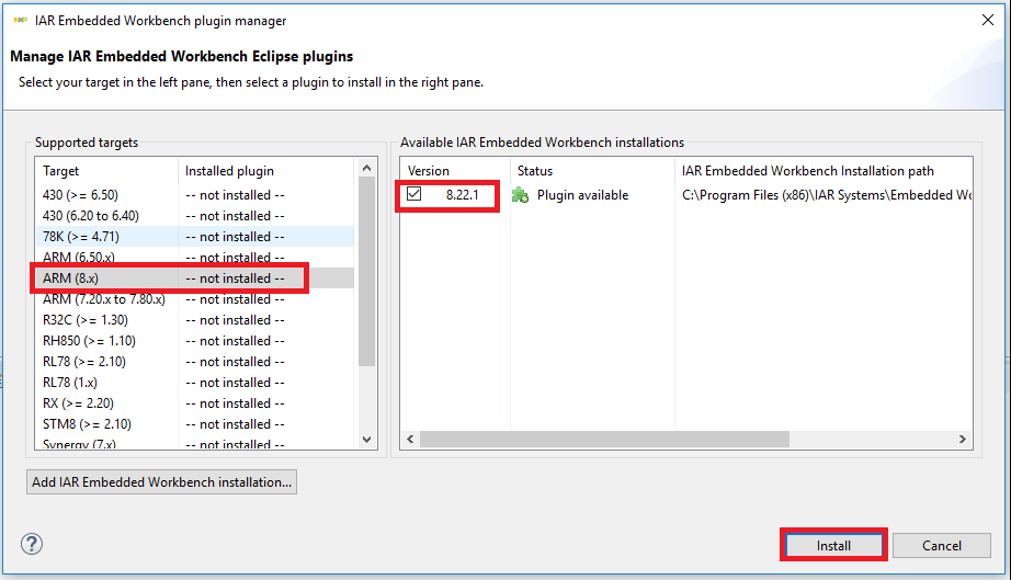

2. Configure IAR plugins in IAR Embedded Workbench plugin manager
  • Run IAR plugin manager (Menu "Help" -> "IAR Embedded Workbench plugin manager...")
  • Select the ARM version (8.x) and click "Install" button.

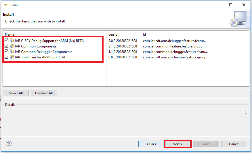

  •  Select all the IAR components displayed and proceed to installation by clicking "Next" button.

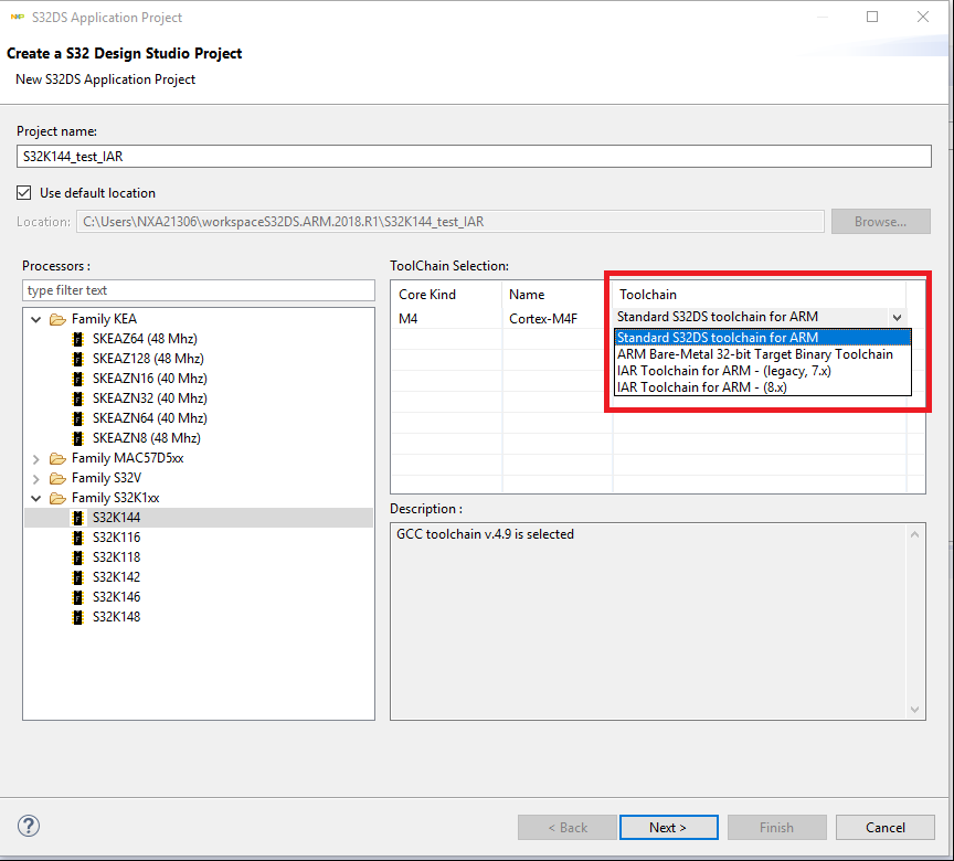

  • You can now create a new project in S32DS and select IAR toolchain for ARM instead of default GCC compiler.

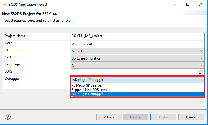

  • There should appear a new item it the Debugger selection - "IAR plugin Debugger". Please choose this option if you intend to debug using IAR supported probes (e.g. I-jet)

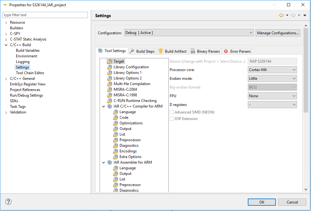

  • IAR specific panels and settings are now displayed in the project properties for a new S32DS project with the IAR options enabled (see above).

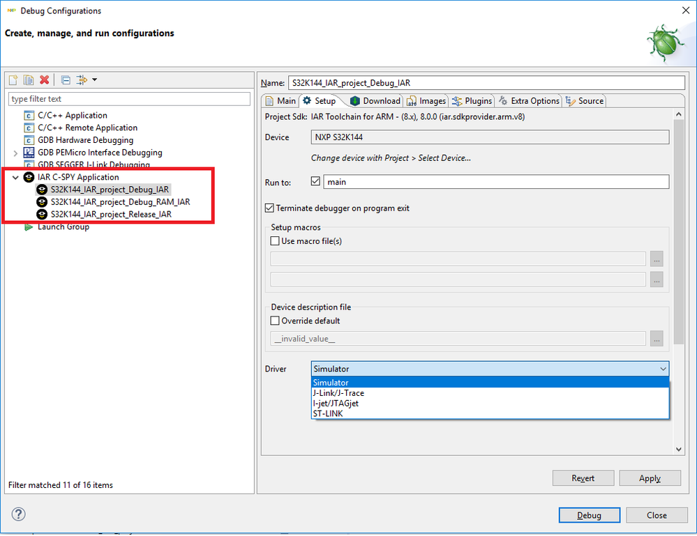

  • There is a new category "IAR C-SPY Application" in the debug configurations panel that contains all the debug configurations for projects with IAR debug plugin option selected.

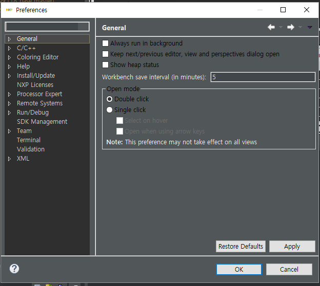

I want to use IAR compiler. so I install IAR Plugin manager like you.
But I encountered the following problem during installation.
Cap 2019-05-13 10-37-43-284.png\
After installation, I did check 'window->preferences'. but there is no 'IAR Embedded Workbench'
As shown in the picture below, I can not proceed with the installation any more.
Please check this problem.
