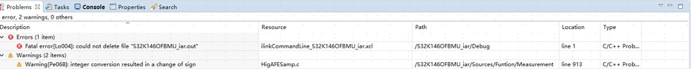

S32DS for ARM v2018.R1 After installing the IAR Eclipse Plugin, configure the output, output the IAR linker, output converter (Output Converter) to generate S19/HEX/BIN file, and compile error

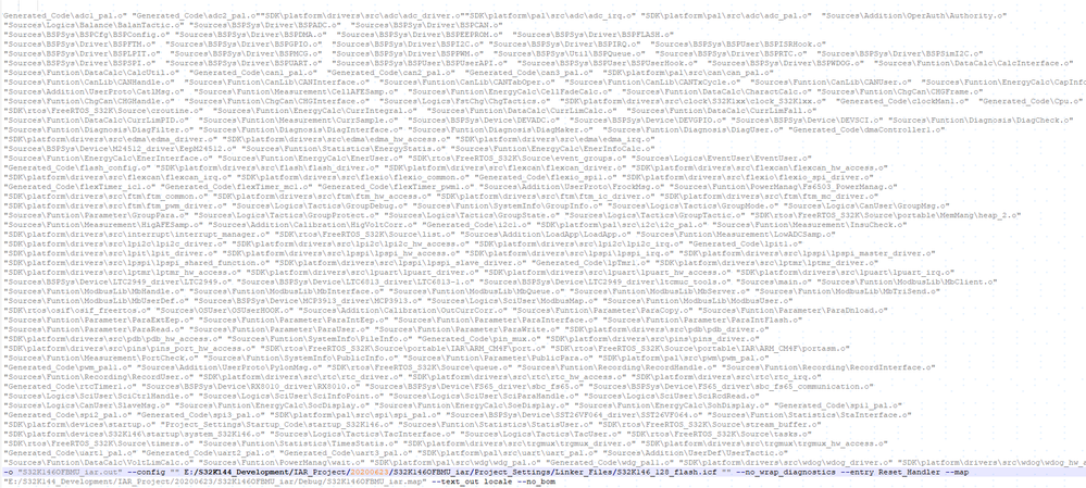

Hi, this is how I can close the problem after installing the IAR Eclipse Plugin, recreating a project, and then compiling the problem.
ilinkCommandLine_S32K146OFBMU_iar.xcl

it looks that your target - S32K146_OFBMU_iar.out is opened or in use by another application. Or you dont' have permissions to be able delete existing .out file.
