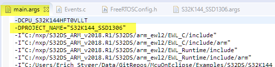

sounds really like a bug to me in the S32DS, and Jiri already created a ticket for it (thanks!).
I have found a workaround in the S32DS: just do it like this:
I hope this helps,
Erich

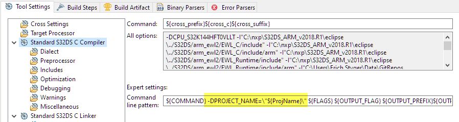

I'm using a very simply (and effective, imho) way: using Eclipse CDT variables which get passed to the compiler/application using -D (defines).
See  How to Use Eclipse CDT Environment Variables in C/C++ Code | MCU on Eclipse
That way any CDT or environment variable or information can be passed to the application and used there, including the name of the project or other things like if it is a 'release' or 'build' targer, or informatinon about the host operating system.
It is possible of course to use external script extra make files, but the above approach has worked for me for a very long time.
I hope this helps,
Erich

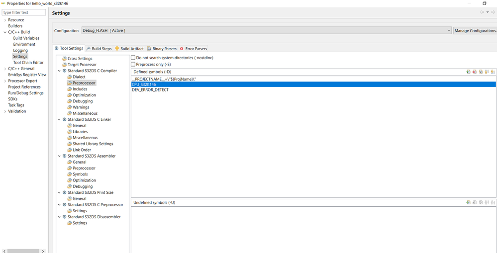

Hi Enrich,
Thanks for your response.

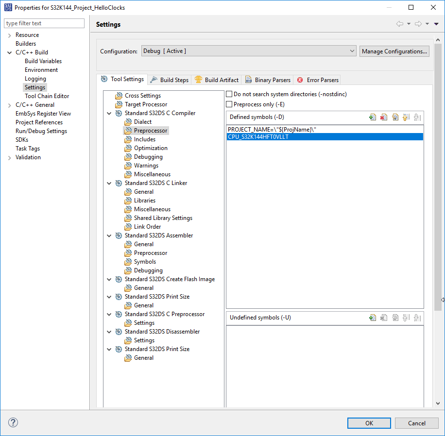

I moment I added the line __PROJECTNAME__=\"${ProjName}\" in preprocessor symbols I'm getting the errors as sjown in the below picture. Without that line I dont see any errors.
Do you think, there will be any additional settings to be made along with this. Kindly suggest

Hi Raju,
I doubt that the error messages are related to the -D addition. You must have changed/broken something else?
Please check (or post) the command line passed to the compiler and linker in the console view.
Erich

Hi Enrich,
The moment I erase the line __PROJECTNAME__=\"${ProjName}\" in -D, the build is successfull.
Also, I created a new project and checked. The result is same. Below shows the addition of CDT variables
Below is the console view during errors.

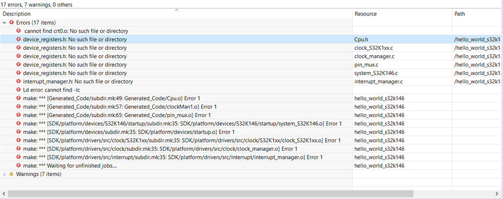

<command-line>:0:17: warning: missing terminating " character
In file included from ../Generated_Code/clockMan1.h:57:0,
from ../Generated_Code/clockMan1.c:39:
../Generated_Code/Cpu.h:58:30: fatal error: device_registers.h: No such file or directory
#include "device_registers.h"
compilation terminated.
In file included from ../Generated_Code/Cpu.c:53:0:
make: *** [Generated_Code/subdir.mk:57: Generated_Code/clockMan1.o] Error 1
make: *** Waiting for unfinished jobs....
../Generated_Code/pin_mux.c:42:30: fatal error: device_registers.h: No such file or directory
make: *** [Generated_Code/subdir.mk:49: Generated_Code/Cpu.o] Error 1
make: *** [Generated_Code/subdir.mk:65: Generated_Code/pin_mux.o] Error 1
C:/NXP/S32DS_ARM_v2018.R1/S32DS/S32SDK_S32K14x_BETA_1.9.0/platform/drivers/src/clock/S32K1xx/clock_S32K1xx.c:51:30: fatal error: device_registers.h: No such file or directory
make: *** [SDK/platform/drivers/src/clock/S32K1xx/subdir.mk:35: SDK/platform/drivers/src/clock/S32K1xx/clock_S32K1xx.o] Error 1
C:/NXP/S32DS_ARM_v2018.R1/S32DS/S32SDK_S32K14x_BETA_1.9.0/platform/drivers/src/clock/clock_manager.c:34:30: fatal error: device_registers.h: No such file or directory
make: *** [SDK/platform/drivers/src/clock/subdir.mk:35: SDK/platform/drivers/src/clock/clock_manager.o] Error 1
In file included from C:/NXP/S32DS_ARM_v2018.R1/S32DS/S32SDK_S32K14x_BETA_1.9.0/platform/devices/startup.c:62:0:
C:/NXP/S32DS_ARM_v2018.R1/S32DS/S32SDK_S32K14x_BETA_1.9.0/platform/devices/device_registers.h:327:6: error: #error "No valid CPU defined!"
C:/NXP/S32DS_ARM_v2018.R1/S32DS/S32SDK_S32K14x_BETA_1.9.0/platform/devices/startup.c:69:38: error: 'NUMBER_OF_CORES' undeclared here (not in a function)
static volatile uint32_t * s_vectors[NUMBER_OF_CORES] = FEATURE_INTERRUPT_INT_VECTORS;
C:/NXP/S32DS_ARM_v2018.R1/S32DS/S32SDK_S32K14x_BETA_1.9.0/platform/devices/startup.c:69:57: error: 'FEATURE_INTERRUPT_INT_VECTORS' undeclared here (not in a function)
C:/NXP/S32DS_ARM_v2018.R1/S32DS/S32SDK_S32K14x_BETA_1.9.0/platform/devices/startup.c: In function 'init_data_bss':
C:/NXP/S32DS_ARM_v2018.R1/S32DS/S32SDK_S32K14x_BETA_1.9.0/platform/devices/startup.c:212:23: warning: implicit declaration of function 'GET_CORE_ID' [-Wimplicit-function-declaration]
coreId = (uint8_t)GET_CORE_ID();
make: *** [SDK/platform/devices/subdir.mk:35: SDK/platform/devices/startup.o] Error 1
C:/NXP/S32DS_ARM_v2018.R1/S32DS/S32SDK_S32K14x_BETA_1.9.0/platform/devices/S32K146/startup/system_S32K146.c:63:30: fatal error: device_registers.h: No such file or directory
make: *** [SDK/platform/devices/S32K146/startup/subdir.mk:35: SDK/platform/devices/S32K146/startup/system_S32K146.o] Error 1
C:/NXP/S32DS_ARM_v2018.R1/S32DS/S32SDK_S32K14x_BETA_1.9.0/platform/drivers/src/interrupt/interrupt_manager.c:58:31: fatal error: interrupt_manager.h: No such file or directory
#include "interrupt_manager.h"
make: *** [SDK/platform/drivers/src/interrupt/subdir.mk:35: SDK/platform/drivers/src/interrupt/interrupt_manager.o] Error 1
09:50:10 Build Finished (took 7s.938ms)

ErichStyger
Specialist I
Hi Raju,
the problem is the way the DS32 is passing parameters to the build process, and that it seems to handle escape sequences in a wrong way. Just use plain double quotes in that case.
I hope this helps,
Erich

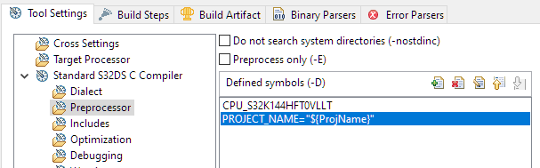

bjrajendra
Senior Contributor I
Hi Enrich,

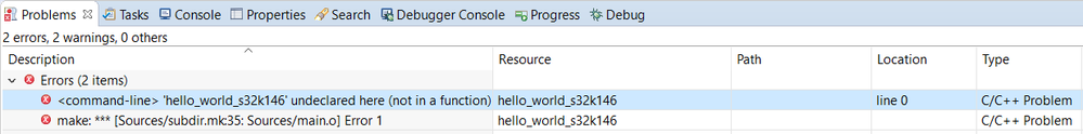

I tried keeping PROJECT_NAME="${ProjName}" in the -D and it built succesfully.
Now I tried using the accesing the project name using below.
static const char projectName[] = PROJECT_NAME;
Now If I build it shows an error as shown below.
Suggest where I went wrong in this
Raju

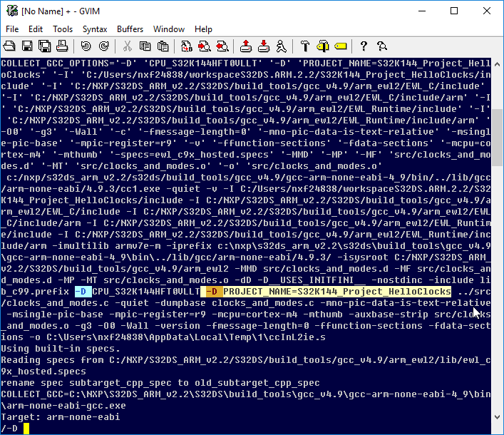

that's the very same error when I tried use IDE variable in preprocessor macro definition. I spend another time to figure out what's wrong - but no success.
May be Erich will have some comment. Here are expanded build command arguments:
-DPROJECT_NAME=\"S32K144_Project_HelloClocks\" -DCPU_S32K144HFT0VLLT -I"C:\Users\nxf24838\workspaceS32DS.ARM.2.2\S32K144_Project_HelloClocks/include" -I"C:\NXP\S32DS_ARM_v2.2\eclipse\../S32DS/build_tools/gcc_v4.9/arm_ewl2/EWL_C/include" -I"C:\NXP\S32DS_ARM_v2.2\eclipse\../S32DS/build_tools/gcc_v4.9/arm_ewl2/EWL_C/include/arm" -I"C:\NXP\S32DS_ARM_v2.2\eclipse\../S32DS/build_tools/gcc_v4.9/arm_ewl2/EWL_Runtime/include" -I"C:\NXP\S32DS_ARM_v2.2\eclipse\../S32DS/build_tools/gcc_v4.9/arm_ewl2/EWL_Runtime/include/arm" -O0 -g3 -Wall -c -fmessage-length=0 -mno-pic-data-is-text-relative -msingle-pic-base -mpic-register=r9 -v -ffunction-sections -fdata-sections -mcpu=cortex-m4 -mthumb -specs=ewl_c9x_hosted.specs --sysroot="C:\NXP\S32DS_ARM_v2.2\eclipse\../S32DS/build_tools/gcc_v4.9/arm_ewl2"
Jiri

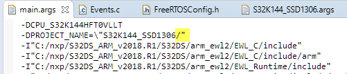

I would say it is a bug (or glitch, whatever) how the DS32 build system is dealing with macro expansions and the way the build tools are intergrated. The issue is that the DS32 is placing the wrong content into the .args file.
So
PROJECT_NAME=\"${ProjName}\"
gets transformed into
(side note: the DS32 does use such args files as interface to the build tools instead passing that on the command line).
The solution for the DS32 is to use normal double quotes like this:
Then it gets correctly placed into the .args file:
I hope this helps,
Erich

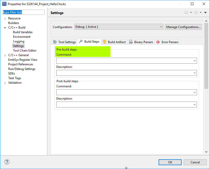

The intension of accessing the filename is to store this software image name within the device.
Do you have any .bat scripts which serve this purpose.
Raju.
9,552件の閲覧回数
jiri_kral
unfortunately don't have such batch file (actually - this is very first time when I met such requirement).
But writing such batch script should be easy. Here are some basics:
Output to file - How can I use a batch file to write to a text file? - Stack Overflow
Getting current directory - windows - Get current batchfile directory - Stack Overflow

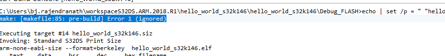

Dear Jiri,
As suggested I created a batch file & it generates the header file as well if it's manualaly run the batch file.
But when I added in pre-build steps it generates an error during build & doesn't created a header too. A console is as shown below.
10:47:40 **** Incremental Build of configuration Debug_FLASH for project hello_world_s32k146 ****
make -j8 pre-build main-build
"C:/Users/bj.rajendranath/workspaceS32DS.ARM.2018.R1/hello_world_s32k146/hello_world_s32k146/console.bat"
C:\Users\bj.rajendranath\workspaceS32DS.ARM.2018.R1\hello_world_s32k146\hello_world_s32k146\Debug_FLASH>echo | set /p= "#define MY_PROJECT_NAME " 1>project_header.h
C:\Users\bj.rajendranath\workspaceS32DS.ARM.2018.R1\hello_world_s32k146\hello_world_s32k146\Debug_FLASH>set MYDIR=\Users\bj.rajendranath\workspaceS32DS.ARM.2018.R1\hello_world_s32k146\hello_world_s32k146\
C:\Users\bj.rajendranath\workspaceS32DS.ARM.2018.R1\hello_world_s32k146\hello_world_s32k146\Debug_FLASH>set MYDIR1=\Users\bj.rajendranath\workspaceS32DS.ARM.2018.R1\hello_world_s32k146\hello_world_s32k146
C:\Users\bj.rajendranath\workspaceS32DS.ARM.2018.R1\hello_world_s32k146\hello_world_s32k146\Debug_FLASH>for %f in (\Users\bj.rajendranath\workspaceS32DS.ARM.2018.R1\hello_world_s32k146\hello_world_s32k146) do set myfolder=%~nxf
C:\Users\bj.rajendranath\workspaceS32DS.ARM.2018.R1\hello_world_s32k146\hello_world_s32k146\Debug_FLASH>set myfolder=hello_world_s32k146
C:\Users\bj.rajendranath\workspaceS32DS.ARM.2018.R1\hello_world_s32k146\hello_world_s32k146\Debug_FLASH>set /p = " "hello_world_s32k146" " 0<nul 1>>project_header.h
make: [makefile:85: pre-build] Error 1 (ignored)
Executing target #14 hello_world_s32k146.siz
Invoking: Standard S32DS Print Size
arm-none-eabi-size --format=berkeley hello_world_s32k146.elf
text data bss dec hex filename
5928 3408 3144 12480 30c0 hello_world_s32k146.elf
Finished building: hello_world_s32k146.siz
Also, Suggest how to reflect it in the project, as it requires the manual addition of the header file.
Raju
9,548件の閲覧回数
jiri_kral
It the project_header.h file contains line with your project definition - you can just include it in main.c (or in source, where you need it) for example. Also make sure, that Project knows path for this header file (or generate this header in /include folder):

Hi Jiri,
Thanks for the support.
Are you facing the similar issue with pre-processor build which shows as mentioned below.
Raju
