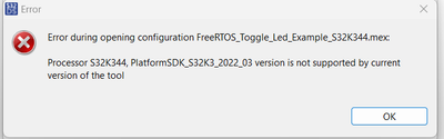

I am following the steps to test the software MR_CANHUBK3_IEEE1722 from the Getting Started with MR-CANHUBK344 Evaluation Board guide. I'm working with S32 Design Studio version 3.4
In section 4.2, S32 Pin Tool, it instructs to right-click on “MR_CANHUBK3_IEEE1722” in the project explorer, then select S32 Configuration Tools → Open Pins. Once in the S32 Pin tool view, I click 'Update Code' and confirm with 'OK,' expecting the driver configuration files to generate.
However, I encounter the following error: Error during opening configuration FreeRTOS_Toggle_Led_Example_S32K344.mex: Processor S32K344, PlatformSDK_S32K3_2022_03 version is not supported by current version of the tool.
Could anyone advise on how to resolve this error?

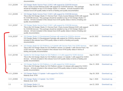

ars05
Versions SW32K3_S32DS_3.4.3_D2112.zip  SW32K3_S32DS_3.4.3_D2205.zip are not available:

Robin_Shen
Sorry for the inconvenience we bring you!
I didn't notice that SW32K3_S32DS_3.4.3_D2112.zip SW32K3_S32DS_3.4.3_D2205.zip are no longer available for customers who haven't downloaded them previously.
Please download SW32K3_RTD_4.4_2.0.0_DS_updatesite_D2204.zip and add it to S32DS Extensions and Updates.(refer to HOWTO: S32 Design Studio - Offline Install of Extensions and Updates) S32DS Extensions and Updates should then be able to install SW32K3_S32DS_3.4.3_D2205.zip as well.
