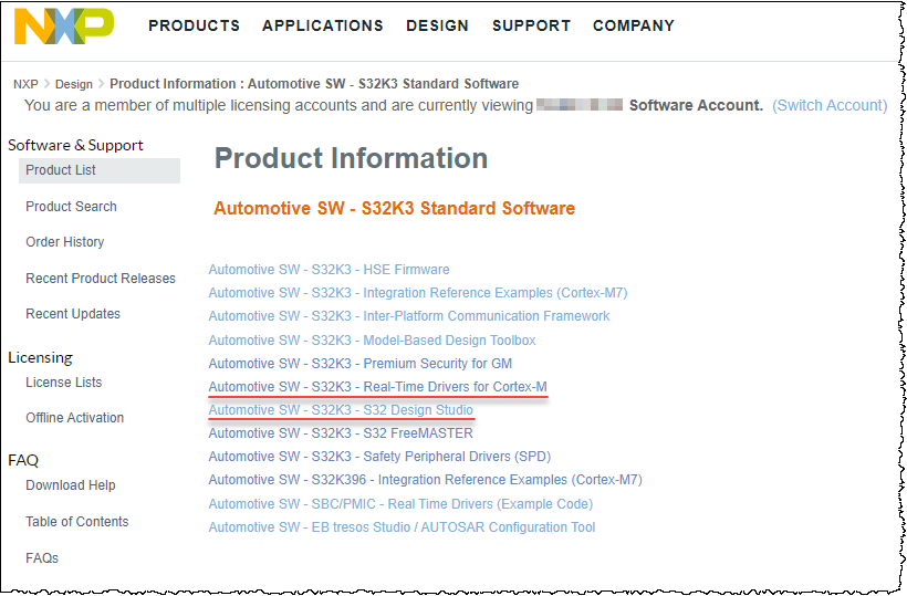

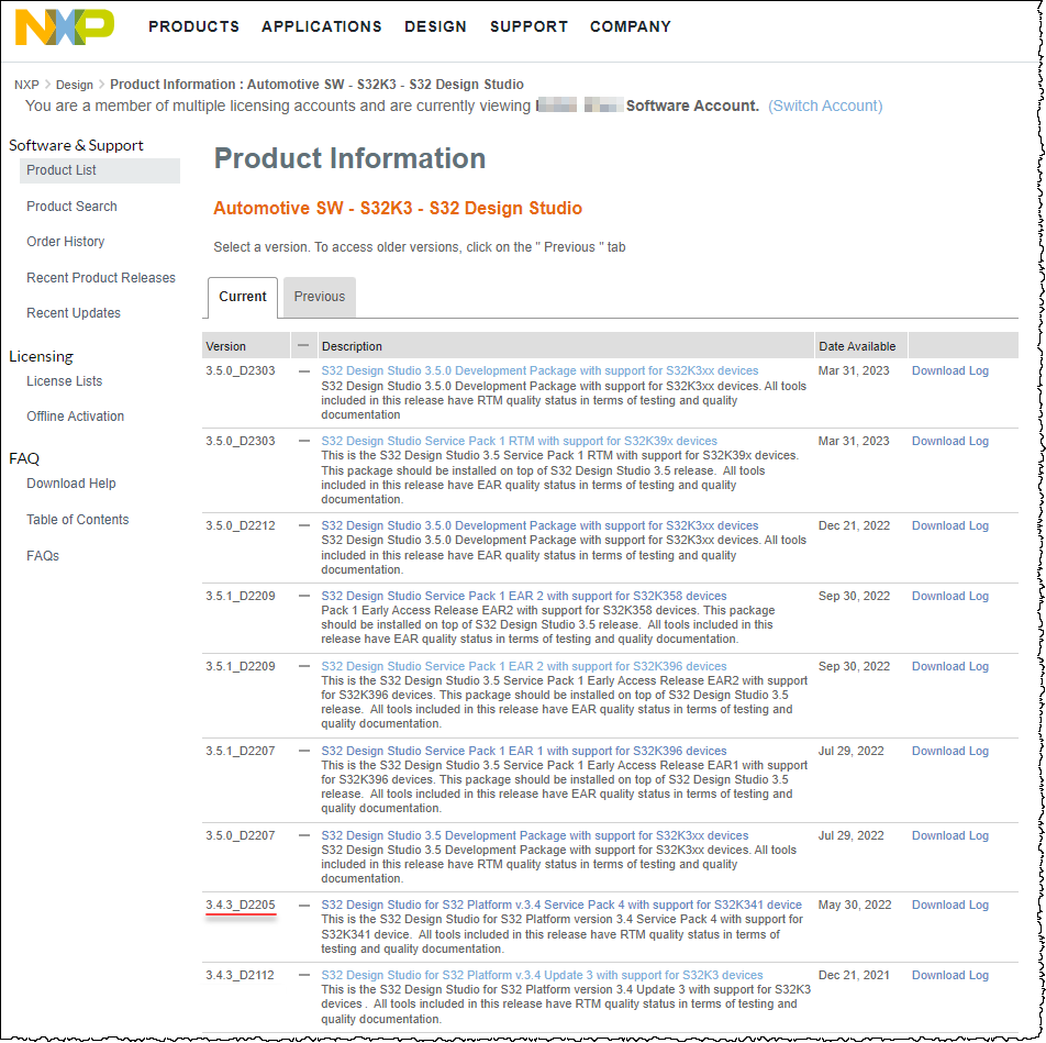

Please try Offline Package Installation Setup:
SW32K3_S32DS_3.4.3_D2112.zip  SW32K3_S32DS_3.4.3_D2205.zip
SW32K3_RTD_4.4_2.0.0_DS_updatesite_D2204.zip
Automotive SW - S32K3 Standard Software.pngAutomotive SW - S32K3 - S32 Design Studio 3.4.3_D2112.png
