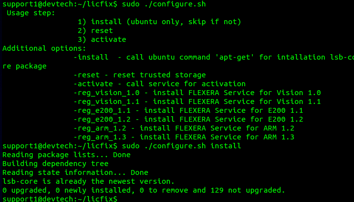

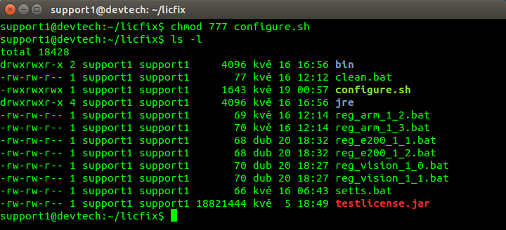

Linux (Ubuntu) users
  • Download and extract the attached archive file "licfix.zip" to your local machine (same package for Windows and Linux)
  • Add the executable right to configure.sh script
chmod 777 configure.sh
  • Run the script as admin with parameter "install" to install appropriate libraries
sudo ./configure.sh install
  • Run the script as admin with parameter "reset" to reset trusted storage into its initial state
    sudo ./configure.sh reset
  • Run the script as admin with parameter "activate" to proceed to activation process
    sudo ./configure.sh activate
  • Enter your activation ID for the product you need to activate
  • Select offline activation type and save generated "request.xml" file
  • Submit generated "request.xml" to your nxp.com account offline activation section and generate activation response "activation.xml"
  • After this step the script should be terminated without any error message.
Now you should be able to install S32 Design Studio on your computer.
