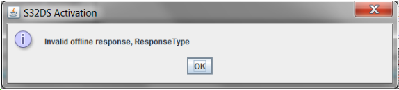

Problem description
When installing S32 Design Studio using the offline activation method (Offline activation on S32 ) the installer may pop up an error dialog: " Error: "Invalid offline response, ResponseType"." This typically occurs on the computers that have no previous installation of S32 Design Studio.
Affected versions
S32DS for ARM v1.1, v1.2, v1.3
S32DS for Power v1.1
S32DS for Vision v1.0
Newer versions should include the fix already.
Solution
Option A) Easiest solution is to use online method instead of offline. But in some cases it may not be possible (LAN restrictions, computer is not connected to the Internet or there is some other network obstacle etc.)
Option B) Apply the hot fix attached. See the instructions below how to proceed for Windows and Linux (Ubuntu) users

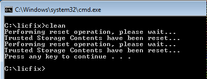

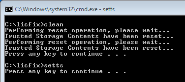

  • Run "clean.bat" to reset trusted storage
  • Run "setts.bat" to run the activation fix and enter your activation ID for the product you need to activate

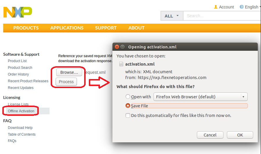

  • Submit generated "request.xml" to your nxp.com account offline activation section and generate activation response "activation.xml"

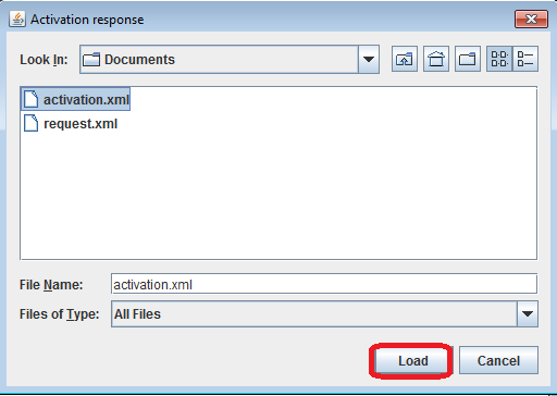

  • Save the created activation response, refresh the Activation response dialog and select the saved file
  • The script is then successfully terminated and now you should be able to install S32 Design Studio

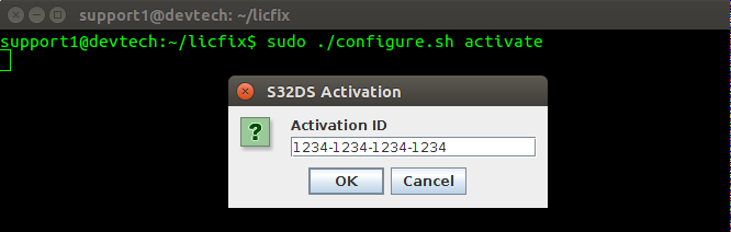

  • Run the script as admin with parameter "install" to install appropriate libraries
sudo ./configure.sh install
  • Run the script as admin with parameter "reset" to reset trusted storage into its initial state
    sudo ./configure.sh reset

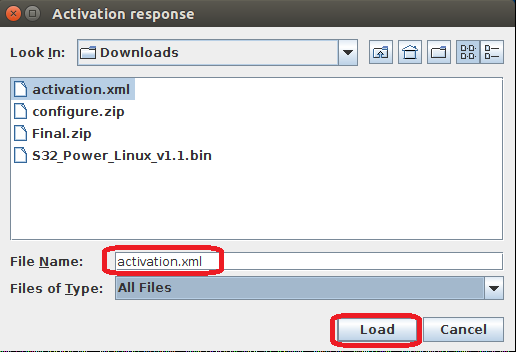

  • Run the script as admin with parameter "activate" to proceed to activation process
    sudo ./configure.sh activate
  • Enter your activation ID for the product you need to activate
  • Select offline activation type and save generated "request.xml" file
  • After this step the script should be terminated without any error message.

Hello Stan
I've tried this method,but it didn't work. It seems that the license can not be detected,and I still need to enter an activation code, but I got "Activation ID is already used on this station", could you help me?
Michael Von
Finally I solved this problem!
The ID I used before is unavailable,I ran licfix with ID:C699-XXXX-XXXX-E800 , after this process ,the installtion succeeded.
