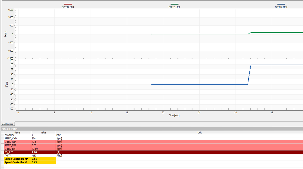

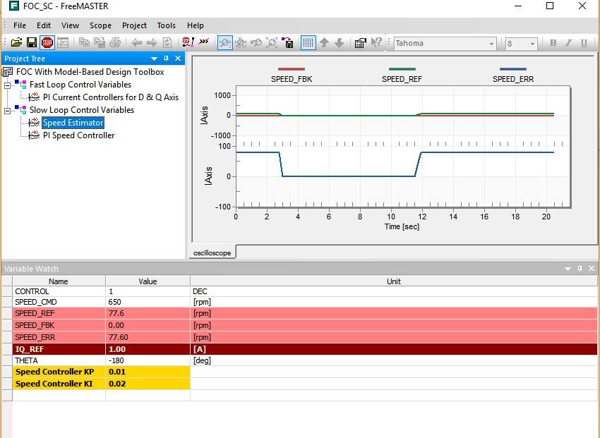

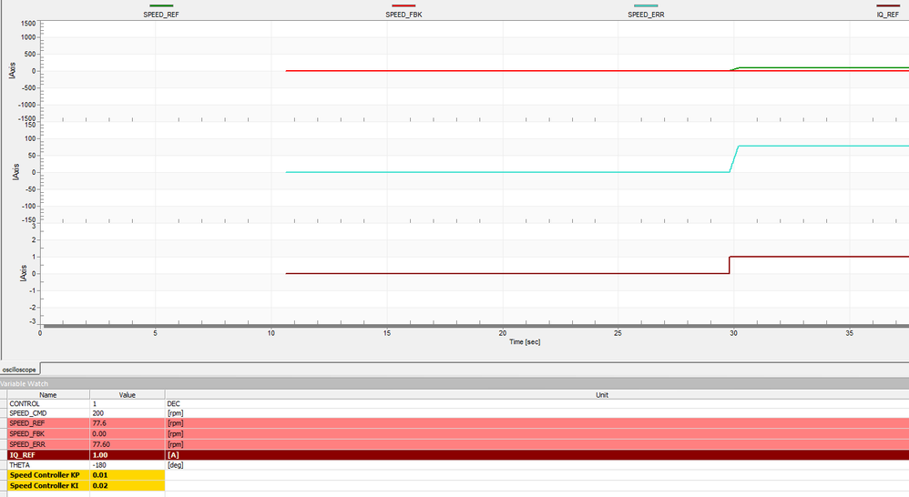

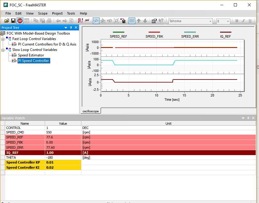

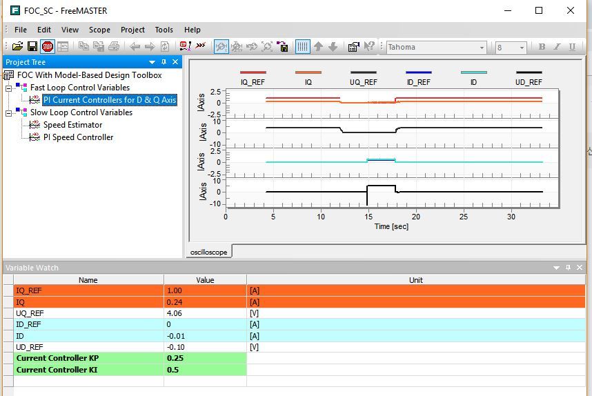

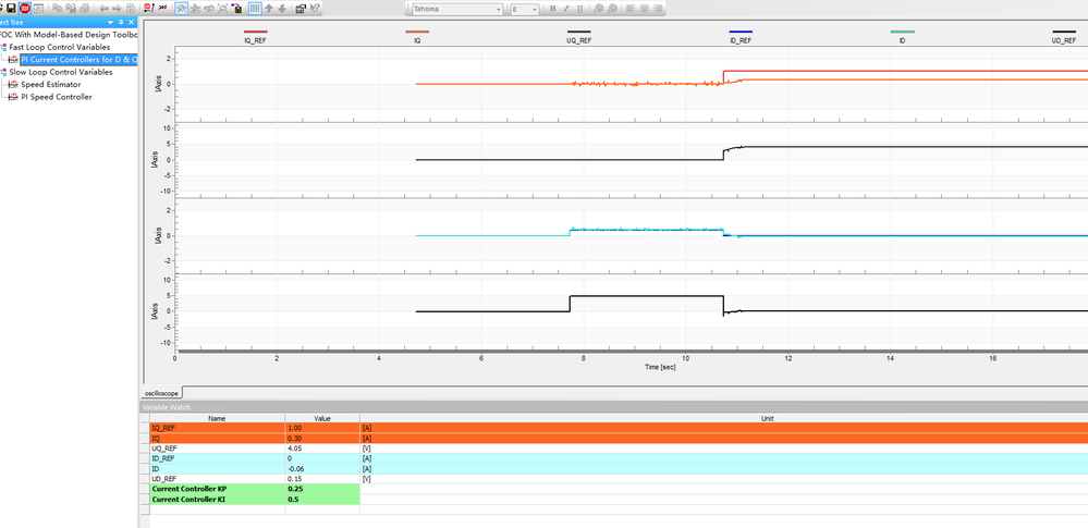

I have a same problem.
I downloaded M8 zip file and execute, but the motor is not spinning.
The LED is keep BLUE after blinking many times with GREEN color.
I am using same demo kit and LINIX motor.
How did you solve this problem.
I would like to know how did you solve this problem.
Thank you
Below is my FreeMaster images

Hi Pony Huang,
I see that the UQREF is saturated at 0.4. Are you sure you are using the last model. Can you try by downloading once again the model attached?
Also, before starting the motor, can you try with a lower speed - let say 250rpm. Does is spin ?

Hi Daniel,
     I download the model again and set SPEED_CMD at 250rpm,but the motor still does not spin.
