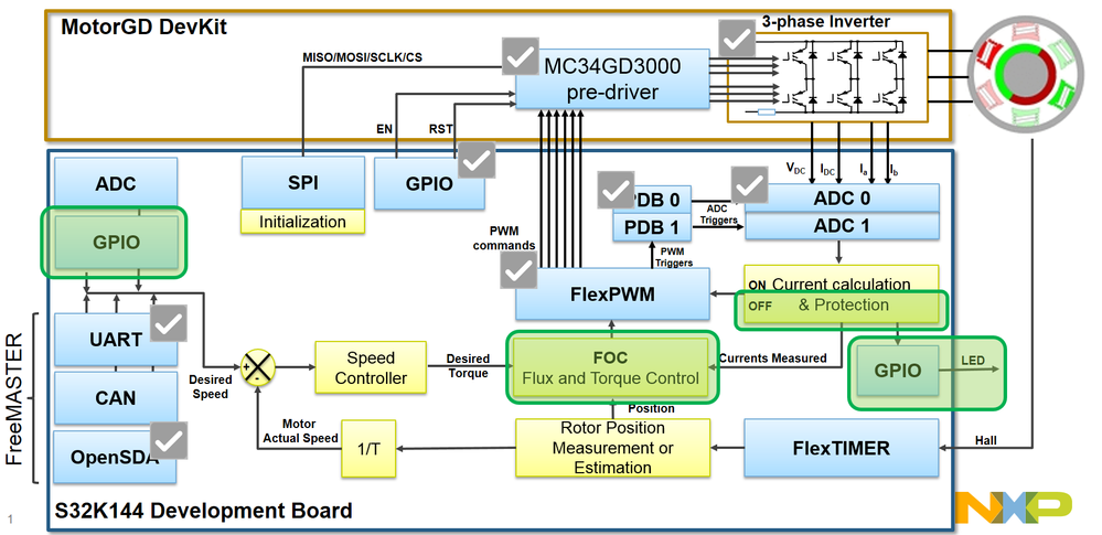

In Fig. 1, which represent the global application mapping diagram as discussed in Module 3: System Partitioning , are shown the new hardware blocks that are going to be configured and used to perform the PMSM FOC Torque Control highlighted in green relative to the ones already configured so far in the previous modules of this workshop. We are going to reuse and enhance the model developed in Module 6: Current Sensing (Part 1/2)  and Module 6: Current Sensing (Part 2/2) which will allow us to test the application in real time on S32K144 3-phase PMSM Development Kit|NXP . The interactions between host PC and hardware will be done via OpenSDA serial communication that will be used to download the code generated from MATLAB and to visualize various control signals with FreeMASTER. In addition, the user can start and control the motor speed from the SW2 and SW3 push button present on the S32K144 Evaluation Board|NXP . A three color LED will be used to signal the control states and faults.
Fig. 1:  Application Mapping -  new HW & SW modules used for FOC Torque Control are highlighted in green

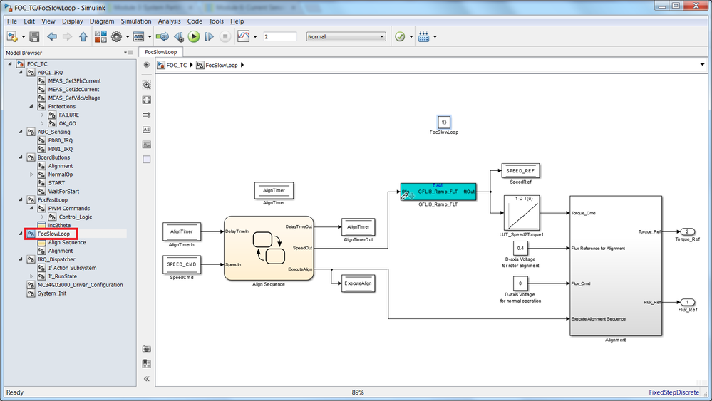

The block diagram of the functions implemented on SLOW CONTROL LOOP is shown in Fig. 3. At each startup, a special alignment sequence is executed in order to move the PMSM rotor into a particular well known position - rotor magnetic D axis is align with PMSM stator phase A. The rotor alignment is a key aspect in torque control since we want to produce the highest torque available and that can only be done if we maintain a 90 electrical degrees between Q axis and rotor magnetic flux axis D
Fig. 3: Slow Control Loop - Block diagram for Torque Control
The alignment is achieved by injecting a current into the D-axis, forcing this way the rotor magnets to align with the magnetic field produced in the stator. For the rotor alignment we need two parameters:
  • the magnitude of the current in the D-axis, which depending on the load it should be closed to the motor rated current or even a bit higher;
  • alignment time that gives the time period while the current is maintained thru stator coils ensuring the rotor is being dragged into the correct position;
Once the rotor alignment is completed the speed command is transformed into the torque command via a LUT similar with the method from Module 5: V/F Scalar Control
In the same time with torque reference computation, the actual electric angle increment is computed in order to rotate the motor.

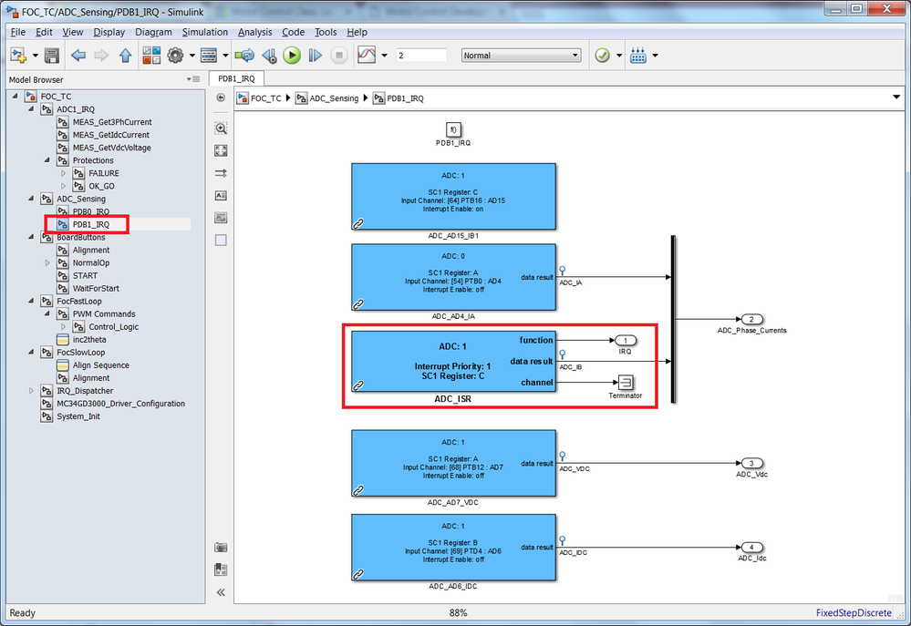

ADC Interrupts
Since we need the FOC software routines (SLOW CONTROL LOOP & FAST CONTROL LOOP) to be synchronized with the ADC measurements as it was shown in Fig. 9 from Module 6: Current Sensing (Part 1/2) we are going to modify the PDB1_IRQ to trigger a function call based on ADC conversion complete (COCO) interrupt that corresponds to the AD15 - PMSM Phase B current. For this we are going to use the ADC_ISR block that allows us to read the conversion results and trigger an interrupt in the same time.
Fig. 6: ADC Interrupt trigger for SLOW and FAST Control Loops

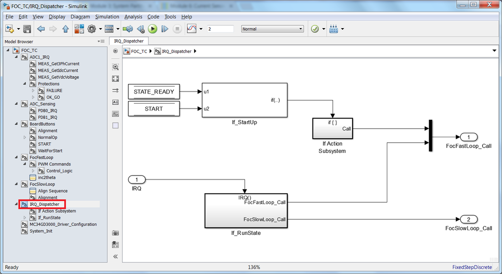

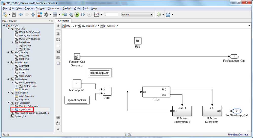

Interrupt Dispatcher
Because the ADC interrupts are synchronized with the PWM frequency, it means that we will get an interrupt at each 100 micro-seconds for a 10kHz switching frequency. That is OK for the FAST CONTROL LOOP which we want to be triggered at each 100 micro-seconds, but for the SLOW CONTROL LOOP that must be scheduled at each 1 mili-seconds we need to implement a sort of dispatching mechanism. This is done in the IRQ_Dispatcher subsystem as shown in Fig. 7.
Fig. 7: Dispatching interrupts to FAST and SLOW CONTROL LOOPS based on ADC HW COCO interrupt
This block implements a two stage logic:
  • StartUp sequence - when there are no ADC interrupts prior of enabling PWM but still need to execute the FAST CONTROL LOOP in order to configure the MOSFET pre-driver MC34GD3000
  • normal RunState - when ADC interrupts are active and we need to delay the triggers for the SLOW CONTROL LOOP leaving unchanged the timings for the FAST CONTROL LOOP in order to insure the 10:1 execution rate between FAST vs. SLOW loops.
The dispatching mechanism that keeps a relative execution rate of 10:1 is implemented as:
Fig. 8: Interrupt dispatcher implementation for execution rate 10:1 between FAST vs. SLOW loops
Slow Control Loop
This subsystem was modified as shown in Fig. 9, to allow:
  • rotor alignment during the startup sequence. This procedure is using an AlignTimer to count how many seconds the rotor should be kept under alignment.
  • speed to torque transformation via a dedicated LUT
As Fig. 9 shows, we have kept the same mechanism used for Module 5: V/F Scalar Control to generate the electrical angle profile and the the references for the (dq) system commands.
Fig. 9: SLOW CONTROL LOOP implementation

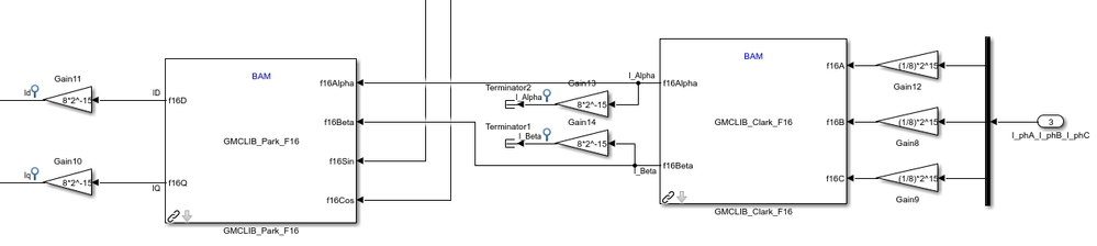

This subsystem was enhanced with two PI controllers for each of (dq) axis and the forward PARK and CLARKE transformations that are now used to compute the currents in (dq) reference system starting from the values measured from ADC.
As can be noticed, during the alignment process the PI controllers are bypassed while the commands from SLOW CONTROL LOOP are directly applied as voltage commands to the FOC transformations. This ensure a faster and stronger response, forcing the rotor to align more precisely into the correct positions without additional delays cause by the PI controllers.
Fig. 10: FAST CONTROL LOOP implementation

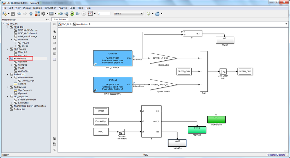

Board Controls
The subsystem shown in Fig. 11, implements the logic of reading the push buttons from the S32K144 Evaluation Board|NXP that allows us to change the motor speed manually and the mechanism of LED notification. The LED logic is implemented as:
  • after reset the GREEN LED is ON signaling the application is ready for receiving commands;
  • during the alignment the GREEN LED is toggling;
  • during normal operation the BLUE LED is ON signaling the application is operating normally;
  • if a fault occurs the RED LED is ON and the motor will stop automatically. The only way to get out of this state is by pressing the RESET button;
Fig. 11: I/O board controls

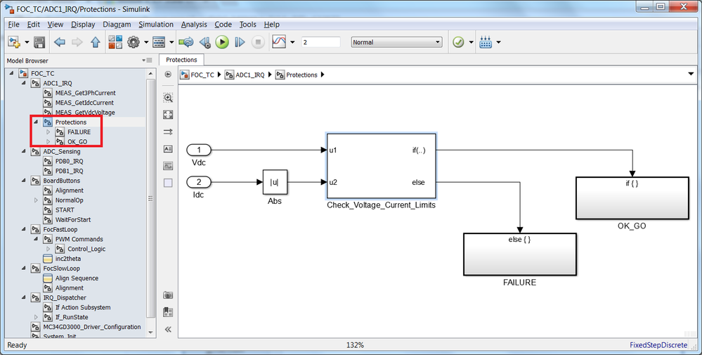

Protections
The motor and drive protections are implemented in the ADC interrupt routine immediately after the measurements in order to make sure that any fault is addressed as soon as possible. Currently there are three protections implemented but in next modules, additional ones will be added:
  • under-voltage protection if the DC bus voltage is below 8V;
  • over-voltage protection if  the DC bus voltage is above 18V;
  • DC link over current if the value of the current on DC link exceeds 4A;
If one of these conditions occurs the application will disable the PWM generation immediately and the application will not be able to be resumed until a RESET is issued by the user.
Fig. 12: Protections

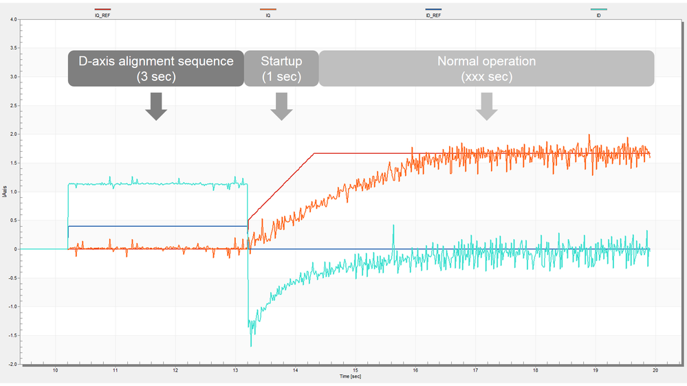

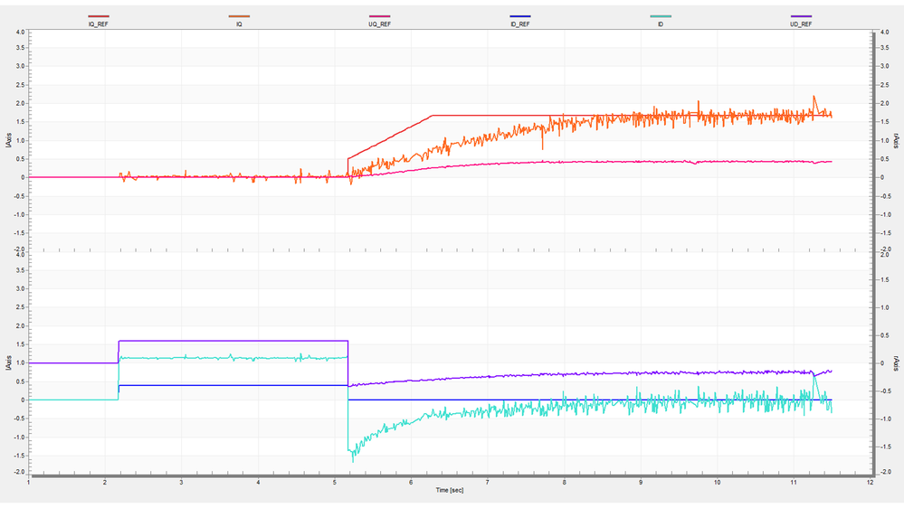

EXPERIMENTAL RESULTS
Using the FreeMASTER attached project we can check the system responses and tune the controllers to responds however we wish on the fly in real time. For demonstration purposes the controller are de-tuned in order to increase the respond time and have easy to understand pictures.

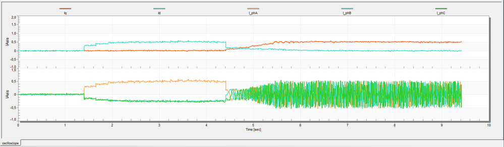

Fig. 13, shows the system response during the alignment sequence, startup and normal operation. You can see that the alignment sequence is lasting for 3 seconds. In this time interval ~1.1 amps are injected in the flux axis in order to force the motor alignment with stator phase A. The correspondence between the (dq) currents and the actual (abc) currents can be clearly observed in Fig. 14.
Fig. 13: Startup sequence: alignment, startup and normal operation showing:
- Torque reference (IQ_REF - red) and Actual Torque (IQ - orange)
- Flux reference (ID_REF - blue) and Actual Flux (ID - cyan)

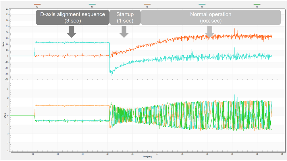

Fig. 14: Startup sequence: alignment, rump-up and normal operation comparison between the (dq) reference system and (abc) reference system
- Actual Torque (IQ - orange) and Flux Flux (ID - cyan) in the upper part
- Actual PMSM phase current Ia, Ib, Ic
Fig. 15, shows the PI controllers responses during startup and normal operation. As you can see in order to maintain almost 1.5 amps thru the motor we need only a small amount of control voltage (0.5 volts - on the right axis).
Fig. 15: PI Current Controller behavior: inputs vs outputs
- Torque axis response (upper)
- Flux axis response (lower)
Fig. 15, shows that there is plenty of room to play of current controller tuning parameters and improve the system response since the voltage reserve is not reached.

  I want to understand the lookup table named "LUT_Speed2Torque1",in FOC_TC\FoCSlowLoop subsystem How this was prepared. As far my understanding is that, for certain rpm torque of motor is constant. But in this LUT it increasing linearly.

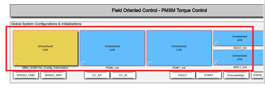

m_benderradji
Hello
I have download the "M7" model and i have the following issue:
Unresolved Link for all the blocks of S32K14x.
Refer to the following:
For your information, i have installed the MBDT for S32K 2018.R1 and i have MATLAB 2018A as version
I tried to build and download to the my board  the "BLDC_OpenLoop_s32k14x.slx" model : it work fine
Could you please tell me how i can resolve this issue.
49,742 Views
Daniel_Popa
Hi [email protected]‌,
I've updated the models to works with the latest release. Please download the new zip files marked ***2018.R1.zip. and let us know if it is working.
49,740 Views

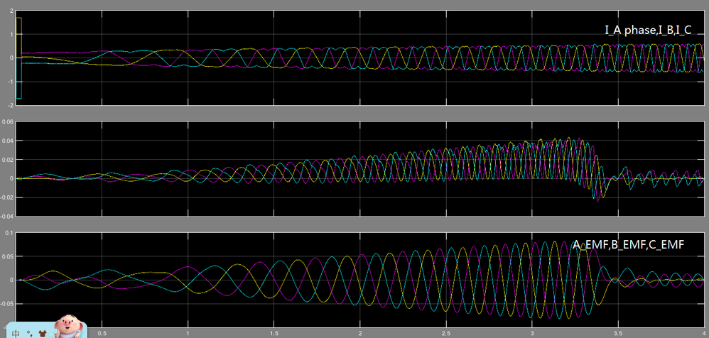

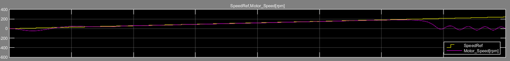

wangxuan
Hello dumitru-daniel.popa
    Long time no see because of delays by some things. After watching M7 I made a modification based on the M5 simulation model, added a current loop, and I had no motor so I tried to use your previous module.
    The purpose of my help is because the model is still wrong. It will suddenly become unstable before the motor speed reaches 200rmp. As a result, the speed will drop sharply and the back EMF will be abnormal, but the A, B and C three-phase currents seem to be correct. I Attempts to modify the parameters of the motor model are not successful. According to your mature experience, can you give suggestions for modification?
    If the motor is working, can you tell me what is the phase difference between the back-EMF and the phase current?
Should I close the speed loop with you to make the system work properly? If I change the Vdc once, the system is no longer normal and the motor parameters seem to be important.
    How to select the current loop parameters?
    I attached my model, thank you.
best regards!

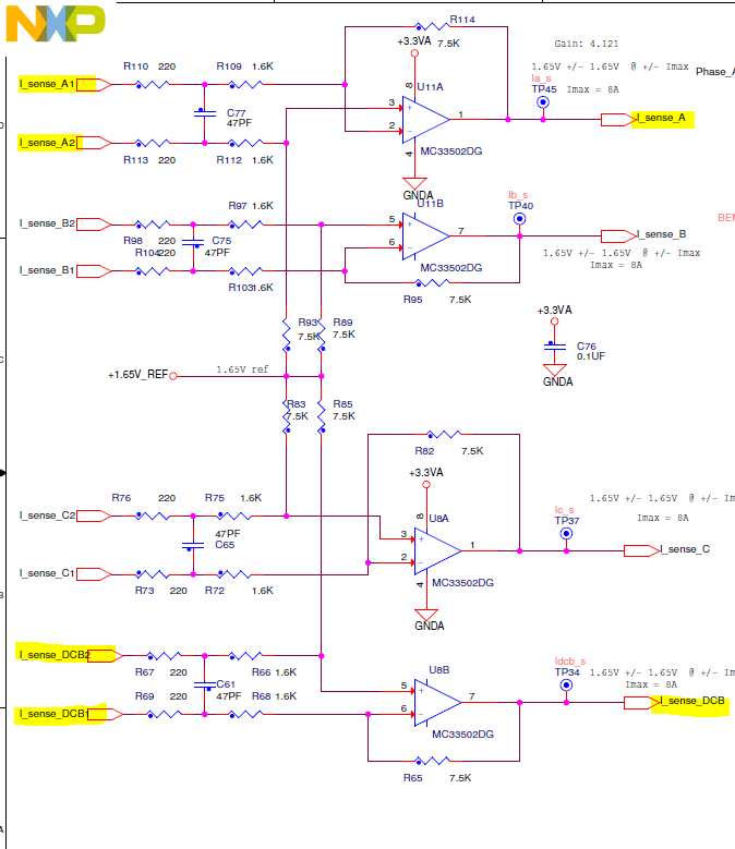

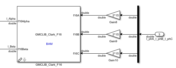

lethuer

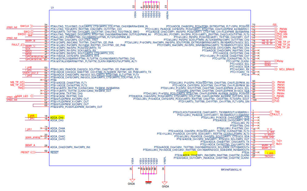

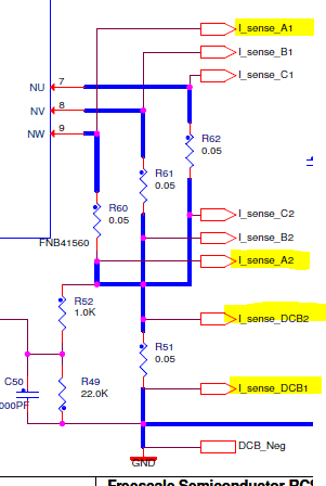

Contributor V
Hello dumitru-daniel.popa‌
Am I correct that during the alignment Operation the current I_phA should be eual to I_dcb ?
I was not able to read any value with the dc link shunt and it is 0 over all the time.
I think this is because the ADC is triggered in the middle of on time of the low side igbt's.
Do you have any recommendations ?
49,740 Views
Daniel_Popa
Hi Leon,
Not necessary. Think about what the inverter is doing ? It is basically a power source that takes as input the Vdc * Idc and outputs U*I
In case of alignment you have the current flowing thru phase A (Ia) and returning via phase B (-0.5Ia) and phase C (-0.5Ic)

Hello Daniel,
Exactly this you can see in this Image:
But for me it is not possible to measure any current with I_dcb shunt.
I have tried this with two HVP-MC3PH board (but with the same Controller Card)
Here you can see the config of my adc samples:
I don't understand why there isn't any value for I_dcb...
Do you have an idea or did I anything wrong ?
Leon

also for the Fast Loop I have a question.
The contained blocks GMCLIB_Park_FLT and GMCLIB_Clark_FLT from s32k should be replaced with GMCLIB_Park_F16 and GMCLIB_Clark_F16 from kv4x. Of course with some gains like in module 5.
In case of U_d and U_q from module 5 it works with gain 2^15 because U_d and U_q are always between 0 and 1.
Now for scaling the currents for GMCLIB_Clark_F16 this might don't work because they are not always between 0 and 1 A ?
How to make the currents suitable for the Clark_F16 block ?
Obviously there isn't a MLIB_Sub block for kv4x (for the PI Controller) ?
How should I replace the Sub block for KV4x ?
Leon
