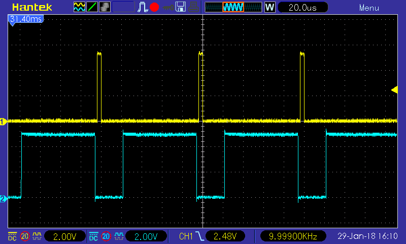

Lets start with Fig. 32, that shows the PDB interrupt triggered by the FTM PWM counter re-initialization. The interrupt is highlighted by a simple GPIO output pin toggle. Going further we have Fig. 33, that shows the phase A and B current variation. If we synchronize the PDB interrupt with the actual input to the ADC channel for one of the current and measure the waveform that corespondents to the worst case scenario as defined in Fig. 6, then we see that we might have up to 86us delay between the moment when the FTM is initialized and the moment when the lower transistor goes in conduction for the top speed we want to achieve. This is delay we want to consider for the PDB configuration.
Fig. 32: Synchronization between PWM command for the lower switch (cyan) and
PDB Interrupt (yellow) as result of FTM initialization trigger

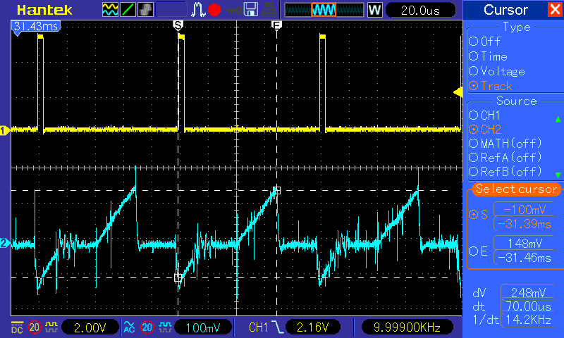

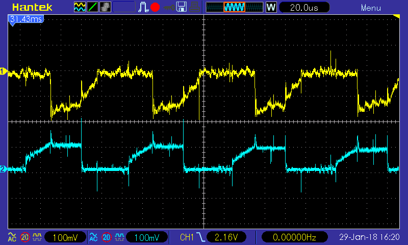

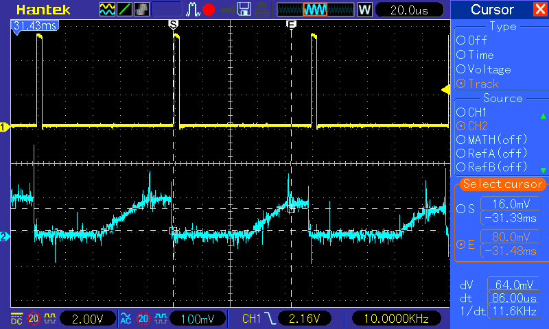

Fig. 33: Phase A (yellow) and Phase B (cyan) voltage drop on the current shunt resistors
Fig. 34: PDB interrupt (yellow) vs. phase current (cyan) at the highest speed we want to achieve. Note the 86us delay between FTM initialization trigger and the actual motor when the lower transistor goes in conduction
Furthermore, if we check the DC-link shunt voltage drop that corresponds to the current that is drown from the power supply we can see its variation and the delay relative to the beginning of the PWM period. That is another information we want to consider for the PDB configuration.
Fig. 35: PDB interrupt (yellow) vs the DC-link current (cyan) at the highest speed we want to achieve. Note the 70us delay between FTM initialization trigger and peak of the DC-link current

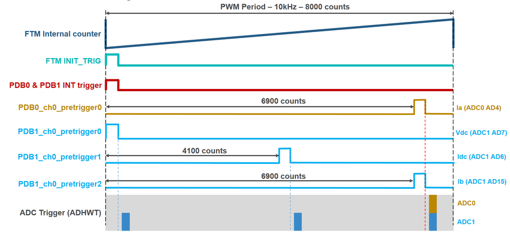

Based on the hardware measurement for the phase currents at high speeds and various experiments I've reached to the ADC triggering timings diagram shown in Fig. 36.
This diagram is valid for 10kHz PWM switching frequency only and shows how the ADC conversions are controlled via the PDB pre-triggers that are in turn delayed compared with the beginning of the PWM period. Please note that how the phase current ADC conversion are synchronized to happen in the same time for both ADC modules.
Fig. 36: FTM-PDB-ADC triggering timings diagram

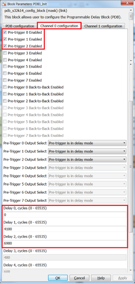

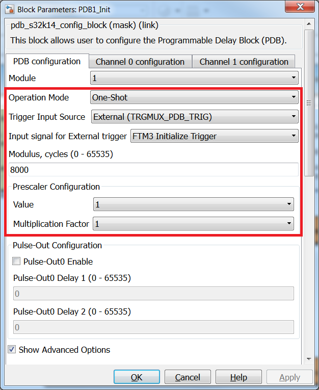

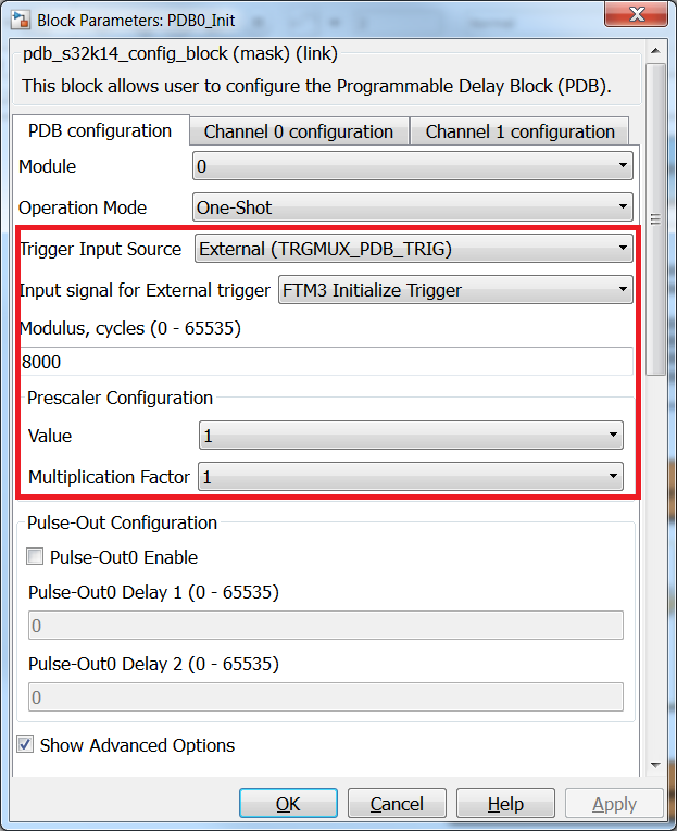

Based on the information shown in Fig. 36, we can configure the PDB0 and PDB1 instances directly from Simulink blocks
Fig. 37: PDB0 and PDB1 global configurations: trigger source, external trigger type and PDB counter value
Fig. 38: PDB0 and PDB1 ADC pre-triggers and delays configuration with the timings shown in Fig.36

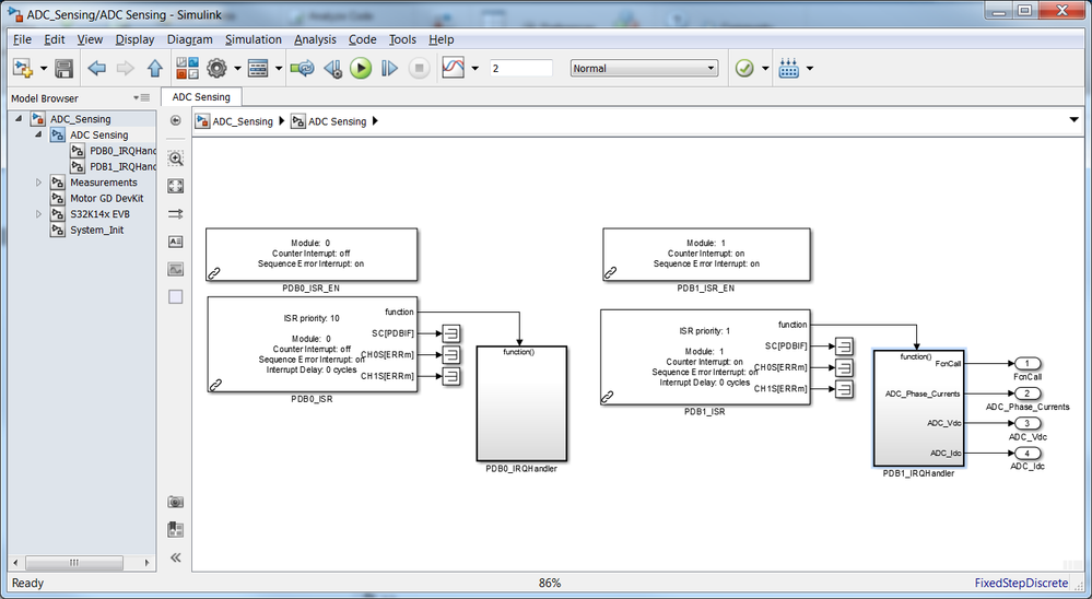

This way the PDB0 and PDB1 will trigger the ADC0 and ADC1 conversions at specific time intervals and all that remains for the CPU is to read those values and use them for FOC. To ADC0 and ADC1 conversion results are read on PDB1 interrupt handler that is triggered each time the PBD counter is re-initialized.
Fig. 39: PDB0 and PDB1 interrupt configurations

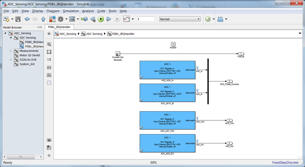

Fig. 40: ADC conversion reading based on PDB interrupt
For the moment the ADC conversion are read based on the PDB interrupt. This will be later on changed to read the values as soon as the last ADC hardware conversion is ready. This will ensure a minimal delay between the moment when the phase current are acquired and the moment when the next commutation sequence is updated.

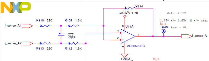

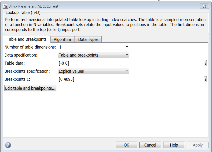

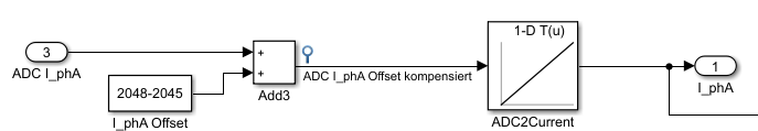

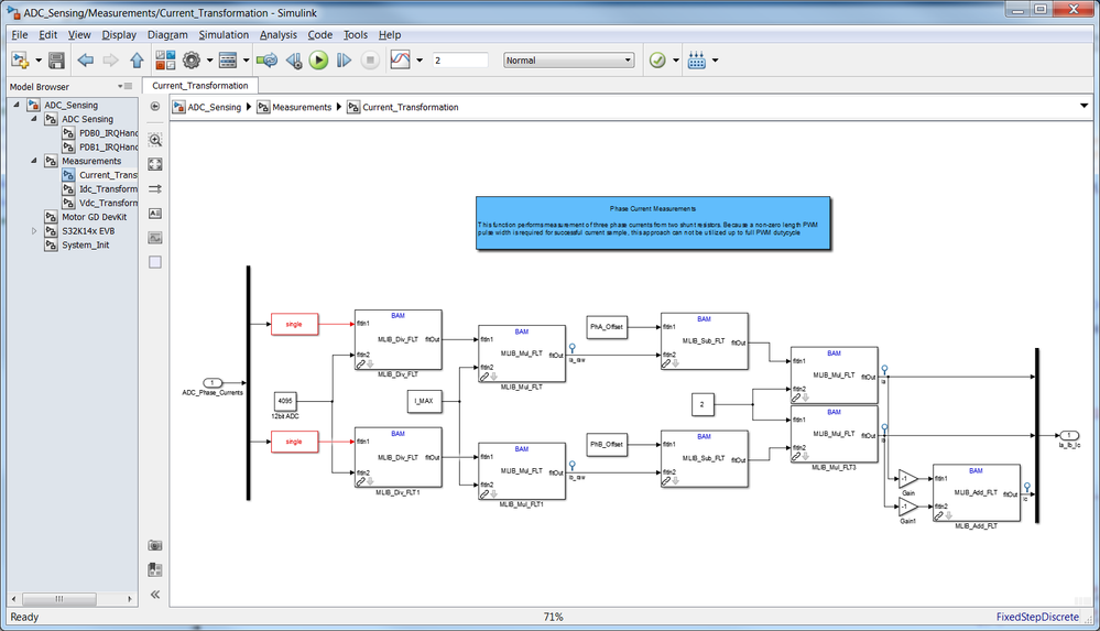

Once the ADC conversion are ready we need to transform those into actual currents and voltages by applying various scaling factors and offset compensation. We are not going crazy with explanations about how the ADC conversion works and how the read hardware implements the shunt voltage drop scaling. If you wish to get more information about this subject you may consult the Motor Control Class: Lecture 3 - Input Commands
The PMSM phase current measurement model is shown in Fig. 41. All you need to know is that the ADCs were configured to use 12bit precision and the shunts resistors can measure an instantaneous AC currents with the peak-to-peak amplitude of 31.25Amps
Fig. 41: Phase current measurements - scaling and offsetting

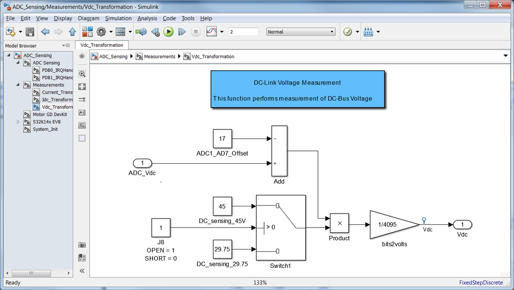

The DC-link bus voltage measurement Simulink model is shown in Fig. 42. Depending on the MotorGD DevKit jumper settings the DC voltage that can be measured via the voltage resistors divider network is up to 45Volts DC.
Fig. 42: DC-link bus voltage measurement Simulink model

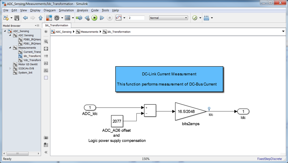

And finally for the DC-link current the Simulink model used to covert the ADC acquisitions into actual Amps is shown in Fig. 43.
Fig. 43: DC-link current measurement Simulink model

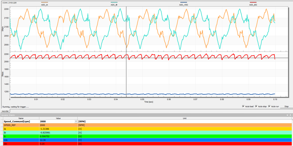

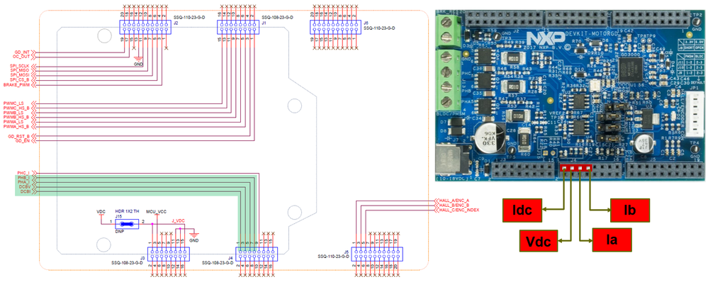

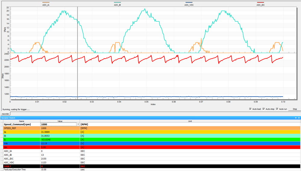

If you reached to this point - then congratulations - it is now time to build the model and flash it into the MCU memory.
Using the FreeMASTER project attached ADC_Sensing.pmp we can visualize in real time the results of ADC conversions and validate the results.
Fig. 44: ADC conversion raw data: (yellow) - phase A current, (cyan) - phase B current, (red) - DC link current, (blue) - DC bus voltage

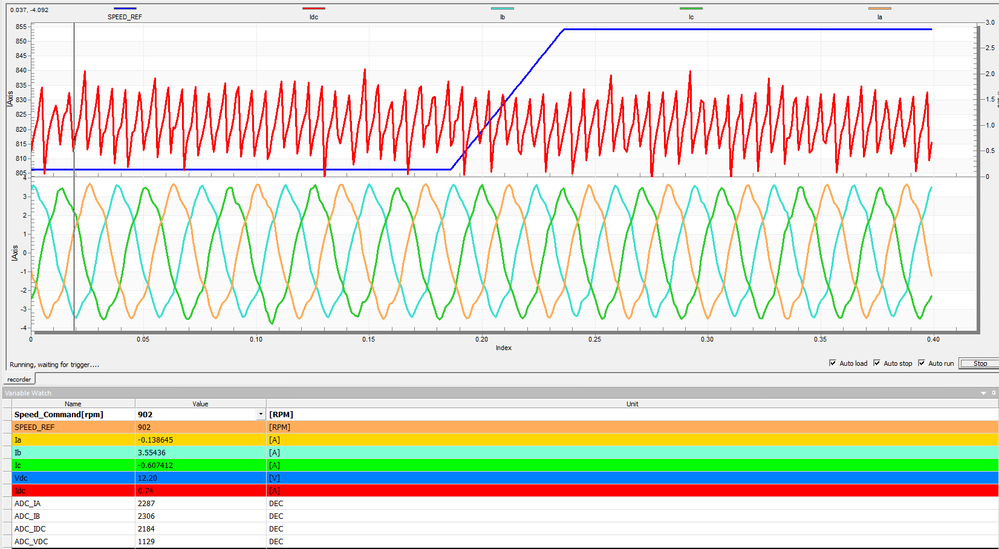

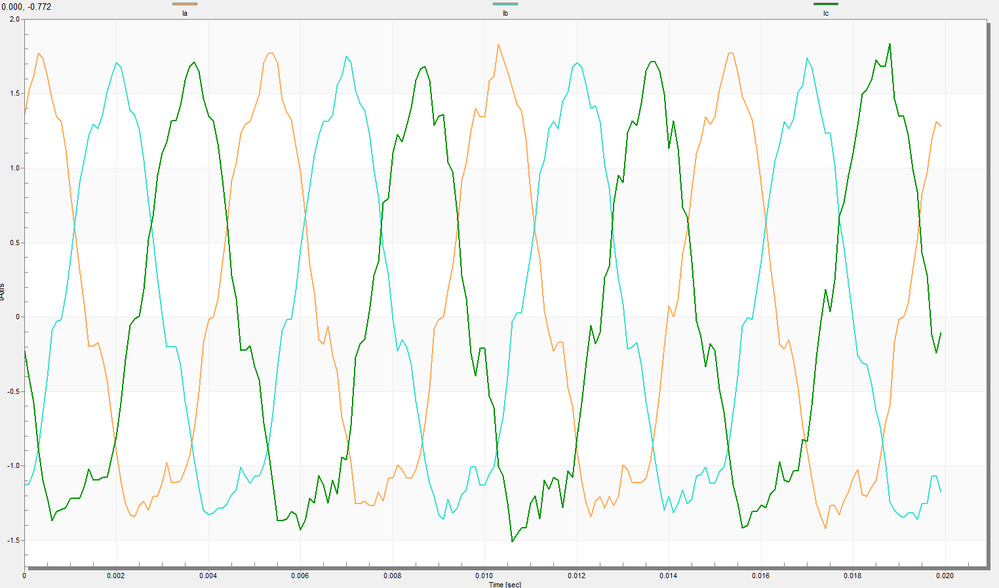

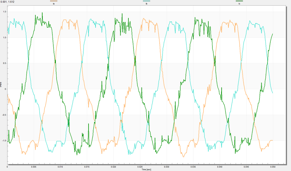

Fig. 45: 1000RPM PMSM phase currents: (yellow) - phase A current measured, (cyan) - phase B current measured,
(green) - phase C current computed
Fig. 46: 3000RPM PMSM phase currents: (yellow) - phase A current measured, (cyan) - phase B current measured,

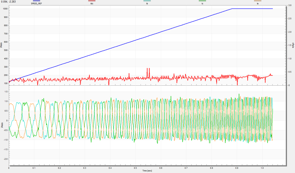

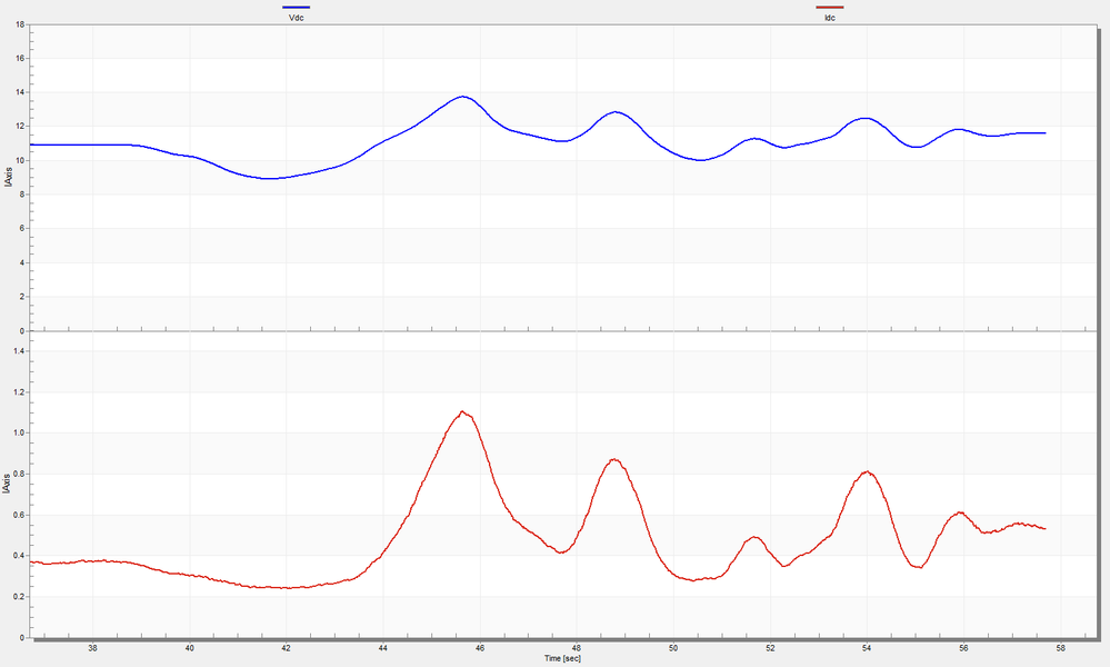

For DC bus values acquisitions we are going to modify the power supply voltage levels. The ADC acquisition from the target shall follow those variations.
Fig. 47: (blue) - DC bus voltage and (red) - DC bus current acquisitions
Due to the scalar control method that keeps constant V/f ratio the DC-link current is going to follow the variations in the DC bus voltage.
As a final validation we can check the PMSM startup sequence and how the values of the currents are changing over the time.
Fig. 48: PMSM open loop V/f scalar control start-up sequence

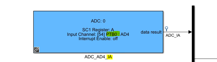

Hello dumitru-daniel.popa‌,
I downloaded the M6_2018.R1 file and i had to reroute the ADC Instance for current A from SE4 to SE2 because the SE4 instance is used by the LSPI Config Block and at 20 KHz PWM i got the following results ADC_Sensing.jpg
i tried the same procedure for 10 KHz with the same data that you used for PDB0 and PDB1 configurations but the motor didn't turn at all.
A second issue was with the torque Control model i did the same rerouting for Phase A but the board keeps going into the fault mode (Red LED).
Is there a way to avoid the LSPI block ? or did this rerouting caused the error with the torque Control?

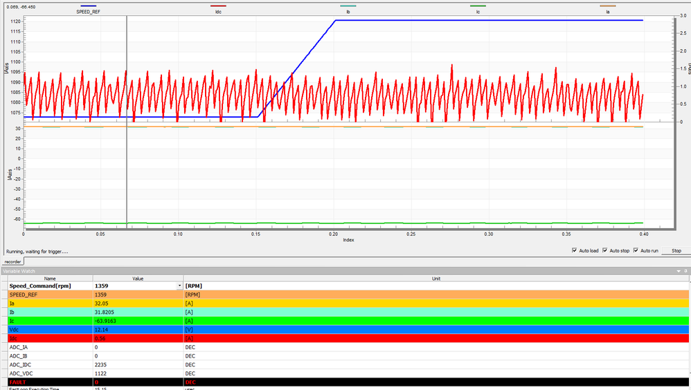

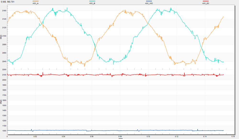

I am currently working with the MTRDEVKSBNK144 development kit, using MATLAB 2018b. I downloaded M6_2018.R1.zip and I had it uploaded on S32. I did apply the Cumulative Patch found in the HotFix thread beforehand (The "Replace All" message appeared) .
Unfortunately, I cannot succeed in making it do the right thing. I posted below my FreeMaster resultspastedImage_1.png
(This warning comes out every time I build the model, but I don't think this is the cause)
Ia, Ib and Ic are supposed to be sine waves.
Regarding the picture containing the ADC_IB and ADC_IB, the phase shift seems good, but the amplitude of ADC_IA is too low. Also, isn't the ADC_IDC shape odd?
Thank you in advance.
Andrei Cador
14,178 Views
Daniel_Popa
Hi [email protected]‌,
Indeed the current reading are wrong.
Have you set the MTRDEVKSBNK144 to operate in the PMSM mode (J11/J10/J09)?
Are you absolutely sure you have installed:
- Toolbox: https://community.nxp.com/docs/DOC-341052
- Patch: https://community.nxp.com/thread/489947#comment-1106251
The text and the screenshots from the article was written for a slightly older toolbox. In the latest toolbox we have changed a bit the UIs. The models with *_2018.R1* were tested and validated before being uploaded here.
14,179 Views
andreicador13
Thank you very much for your fast response, dumitru-daniel.popa‌.
Seems like I did not change those jumpers for PMSM operating mode. I thought it was the default mode and I did not go through that part of the guide.

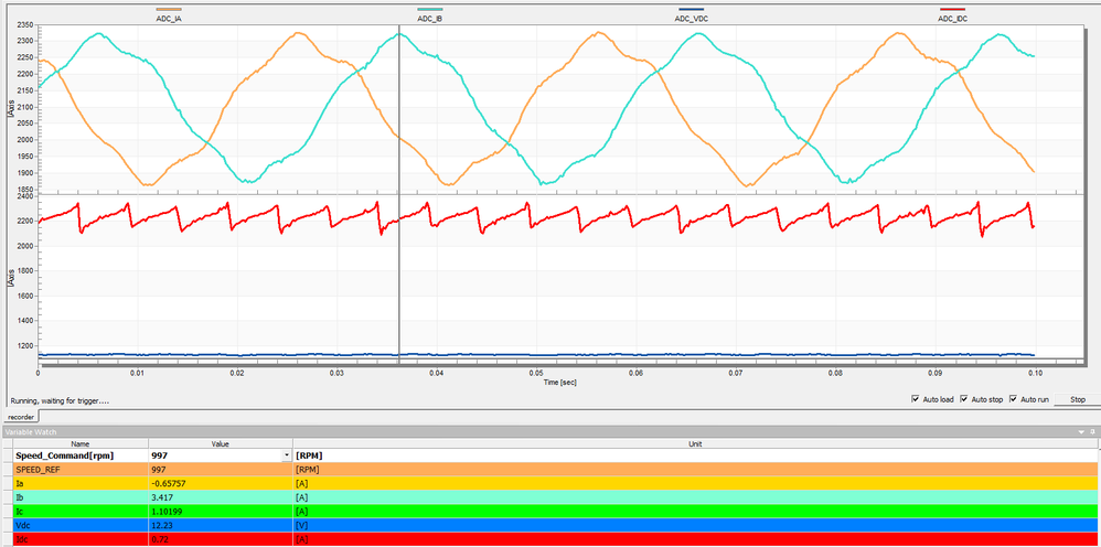

I wish to add one more question to be sure that my motor is functioning the way it should.
Are the measurements for 2000RPM regime too noisy? I think it's important to mention that 2000RPM is the biggest value I can set, providing the fact that Fig. 46 showed 3000 RPM.
Andrei Cador
14,180 Views
Daniel_Popa
The motor which is part of the kit is a BLDC motor (the back-emf waveform is square). Also, keep in mind that the motor max speed is 4000 rpm @ 24V. The DC bus voltage used on the kit is only 12Vdc hence you can't drive the motor stable for more than 2000rpm.
These are some aspects that you need to consider when you drive this default motor. If you have a change to change the motor with a more reliable 12V motor with sine back emf waveform, then please do it - the quality if the currents will be drastically improved.
Hope this helps!

Daniel_Popa
Hi sohyunjang‌,
I might not be the best person to answer these questions - but for the sake of convenience since the topics are somehow related with the subject of this article - i'm going to give it a try.
1. For sensing the DC link voltage, DC link current, Phase voltage,
 PDB_DRV_SetTimerModulusValue (INST_PDLY0, HALF_PWM_MODULO);
 Is there any reason to set 2000 to 4000 instead of Full PWM?
When setting to HALF_PWM, I want to know if AD conversion is possible for 0 ~ 2000 and AD conversion is not possible for 2000 ~ 4000.
The SW you are using is a reference design from NXP and if you check the fast control loop execution you will see that the current measurements are performed at every other second PWM update.
The FTM3 PWM module which triggers a whole “chain” of peripheral blocks FTM3_initialization->PDB0/1->ADC0/1 has an operating frequency of 20 kHz (you want to have the PWM as high as possible to eliminate audible noise and limit the EMI)
Since in Sensorless mode you need to perform a lot of computations in the fast control loop (10kHz) - which is in sync with the ADC measurements - you need to make sure you have enough time to finish you computation before being interrupted by other tasks (slow loop, data aquisition, etc) that also need to be executed.
Therefore, NXP has employed a trick - skips one PWM update interrupt and measure the ADC signals at every second one.
In addition there are 2 other aspects we need to count for:
  1. the motor phase currents are read with shunts resistors that are mounted in the lower part of the inverter
  2. the PWM signals are generated based on center-aligned method
These 2 aspects ensure that in the middle of the PWM (2000)  out of full PWM (4000) we will find the lower transistor in conduction and we will be able to measure the motor phase current.
Since the PBD is triggered at every other second PWM initialization event, then the PDB counter is set to count only till the half of the PWM period.
Of course you can measure values like DC bus voltage at any point between 0-4000 but the phase current can only be acquired in a specific points when using shunt resistors in lower inverter legs.
2.  At present, the information of other sensors is required, so it is necessary to add about 4 channel ADC.
Therefore, the PDB delay must be add in AD sequence.
I want to know the minimum PDB delay time for other AD conversions after one AD conversion in PDB_DRV_SetAdcPreTriggerDelayValue().
There is no problem in adding additional ADC triggered conversions. Now the delay depends on your particular system. You can see my analysis here: Module 6: Current Sensing (Part 1/2)
For the beginning you can start by adding a 200-300 range PDB delay for each of the triggered ADC conversion.
Keep in mind that you can also tweak the ADC settings in order to make if faster but will consume more power.

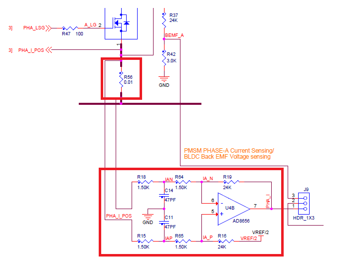

Hi dumitru-daniel.popa‌

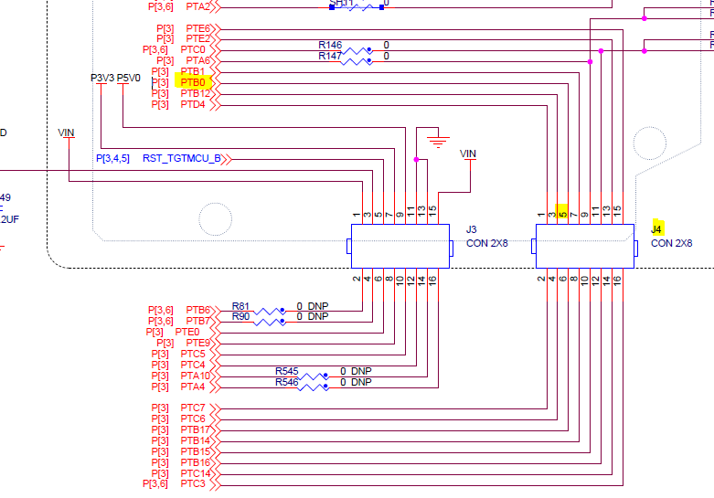

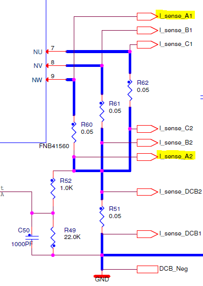

Where did you found this Information of 31.25 Peak-to-Peak Amplitude ?
For the Motor GD Kit I only found 5A phase current (RMS) in the overview.
https://www.nxp.com/support/developer-resources/hardware-development-tools/ultra-reliable-mcus-devel...
I didn't found a schematic.
14,180 Views
Daniel_Popa
Hi Leon,
Indeed, the schematics of the MotorGD DevKit are not yet available on the website. I've made a note to NXP persons responsible for uploading the documentation. I do not have a public approved version therefore i can't share it here.
What i can share is how the current measurement is implemented. PHA_I goes directly on MCU ADC pin just like the other signals for the B and C phase currents.
I'm not an electronic engineer, but apparently if you do the math, that's the theoretical range.
Hope this helps!
14,180 Views
lethuer
Contributor V
thank you for the image. If I'm correct the J9 is connected between pin 1 and 2.
Then J9 pin 2 should be connected with J4 Pin 5 in the image below ?
Motor GD
S32K
J4 Pin 5 is then connected on s32k PTB0
PTB0 you have configured in the adc block.
If this is correct then the + terminal of the Operation amplifier is connected to the upper side of the shunt (PHA_I_POS) while the - terminal is connected to the lower side of the shunt.
Here is a difference to the High Voltage Development Platform !
MC3PH
Here the + terminal of the Operation amplifier for current measurements is connected to the lower side of the shunt while the - terminal is connected to the upper side.
So with MC3PH here the Inversion of the sign is already done and I do not need to consider this in Software?
The note in the schematic "1.65V +/- 1.65V @ +/- Imax" would be okay !
On the Basis of my previous model for measuring the currents I have configured a LUT like this:
