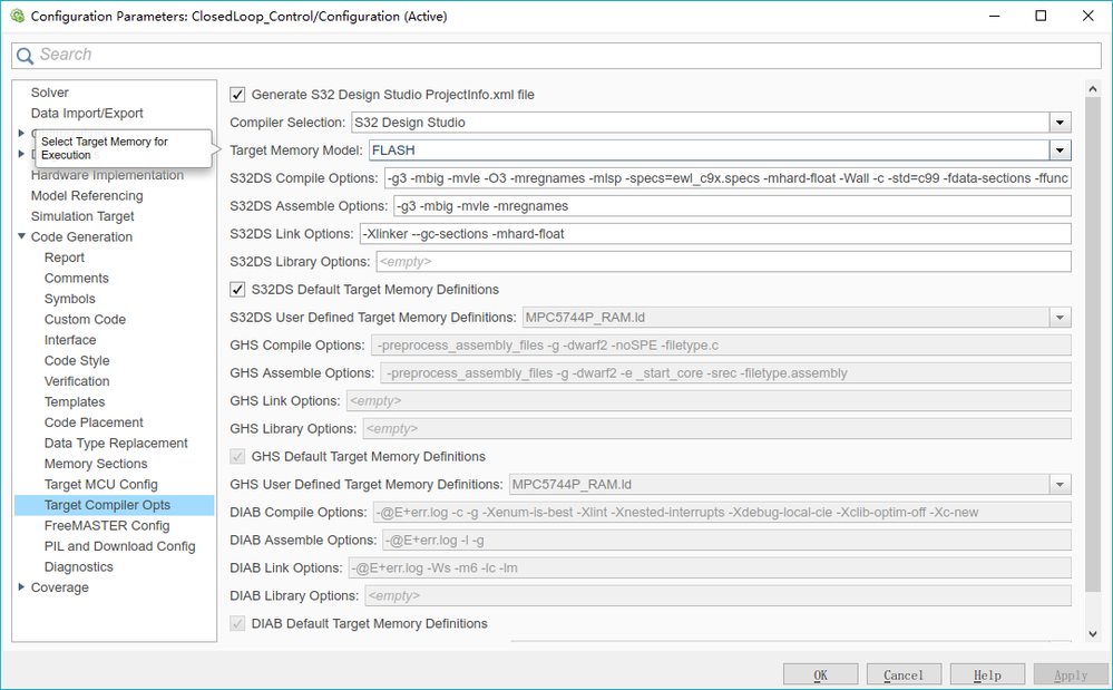

#1: make sure the HotFix_4 is installed successfully and the "Generated S32 Design Studio ProjectInfo.xml file" option is visible and selected

#3: Open S32DS for PA and select Import/S32 Design Studio/ProjectInfo.xml Importer
#4: Press Next and select the ProjectInfo.xml from the location used to generated the C-code for the Simulink model. Also, select the E200 Executable option
#5: Click on Finish button to have the project imported into the S32 Design Studio workspace.
#6: Applicable for S32DS v1.2 (due to a bug in IDE): Open the Project Properties and go to Settings/Target Processor and select "generate code for E200Z4" as Target Processor and re=select the option shown near the Libraries Support. These will force the IDE to update the toolchain properties correctly. These limitations will be addressed in the newer versions of S32DS for PA.
#7: Build the project
Expected result: The executable file should be produced without any errors. In case of errors - please recheck #6.

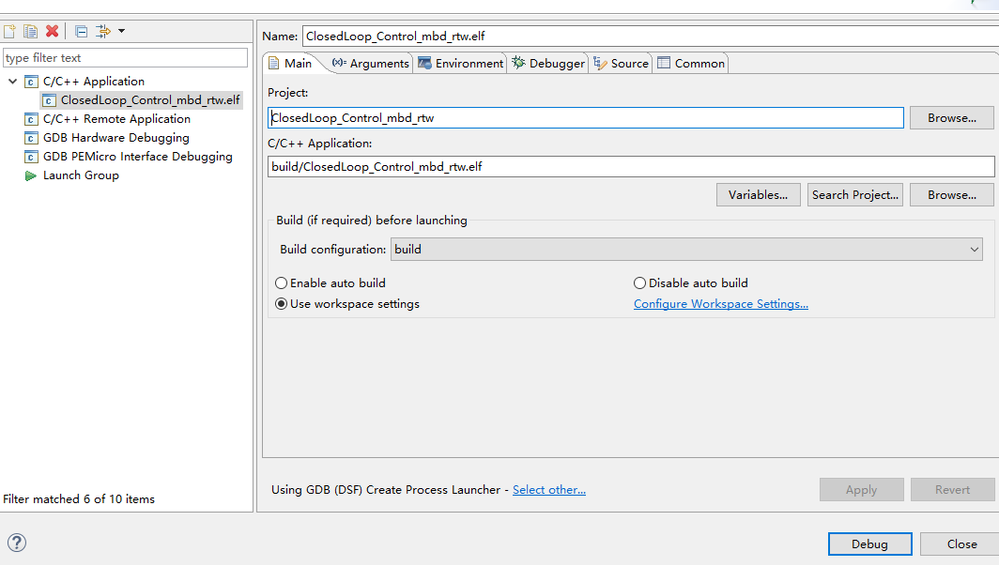

     Though having completed the whole process and builded the project sucessfully, the error ocurrs when I try to debug the project.The error message is as follows.Do you know the reason?
Thanks!

Hi hjhjhj
The easiest way to create a debug configuration is to start from an S32DS stationery project and then simply change its existing GDB debug launch configuration to debug the elf/project you wish to investigate.

Hi hjhjhj‌,
Check this thread https://community.nxp.com/thread/454916 .
There is a bug in S32 Design Studio for Power v1.2, you need to set the GDB Executable to ${cross_prefix}gdb${cross_suffix}

Hi@Paul Vlase
      There isn't the option "GDB Executable" in the debug configuration page and it seems different  between the project generated by S32DS and project generated by simulink.And I can't find "GDB Executable"in any other place as well.Can you help me find it?
Thanks!

Hi hjhjhj,
Try to set GDB debugger property to ${cross_prefix}gdb${cross_suffix} .

Hi@Paul Vlase,
     Setting GDB debugger property to ${cross_prefix}gdb${cross_suffix} works,but another error occurs .
Thanks!
