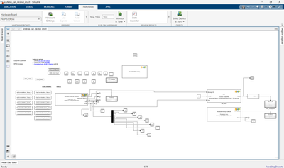

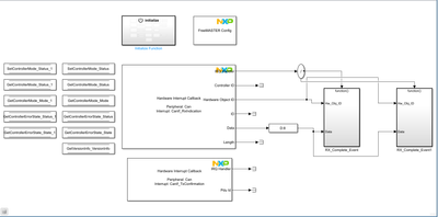

Hello NXP team,
Currently we are working in can transmit and receive messages in S32K344 our customized board.

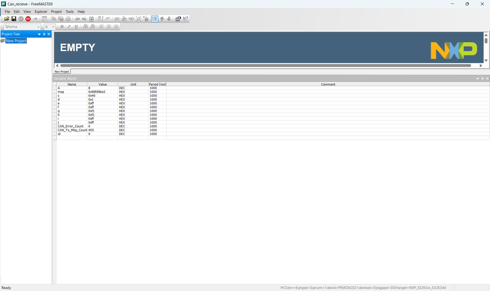

And we can be able to receive CAN messages and able to read the messages using freemaster.
Right now, we are facing the issue in transmitting the can messages.
We are able to configure the can_tx with the help of Can_transmit examples for S32k344.
But the messages we are trying to transmit is not getting transmitted (we are also verified with bus master that the messages are not getting transmitted).
Kindly help us to resolve this issue.
I have shared the model and configuration with this post.

If you are using the Serial FreeMASTER, what you are seeing are the global variables, that store the data from the CAN messages, being sent through UART communication to the PC.
Please try first to get one CanController working. Then use from this CanController two separate CanHarwareObjects for transmission and reception of CAN messages respectively, both in the same Simulink model.
Once this step is passed you can split the transmission and reception on multiple CanControllers based on your application needs.

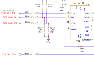

- Make sure that the Transceiver associated with the used CanController is correctly initialized. In case of TJA 1043 only pin EN needs to be set to HIGH and pin STB needs to be set to LOW. Here's an example schematics on how the pins from the transceiver are connected to the microcontroller
In total at least 4 pins need to be connected between the microcontroller's CanController and its corresponding CAN transceiver: CANn_TX, CANn_RX, CANn_EN, CANn_STB.

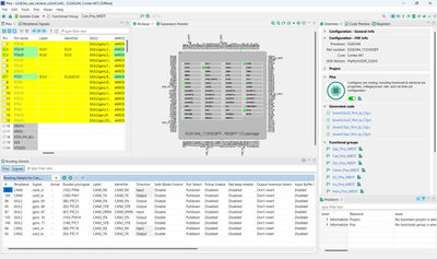

1. We can be able to receive the messages using both can controller (CAN 0 & CAN 2) and both Can hardware objects.
These are the pins we configured with EN as high and STB as low, 

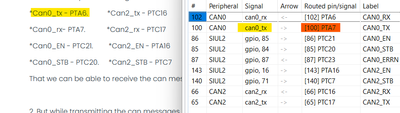

*Can0_tx - PTA6.          *Can2_tx - PTC16
*Can0_rx- PTA7.           *Can2_rx - PTC17
*Can0_EN - PTC21.        *Can2_EN - PTA16
*Can0_STB - PTC20.     *Can2_STB - PTC7
That we can be able to receive the can messages in both the can channel.

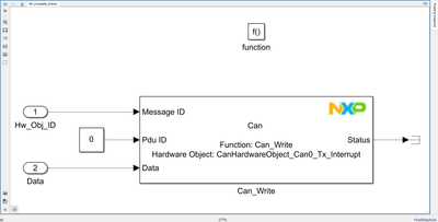

2. But while transmitting the can messages, we referred the examples
Communicating over the CAN Bus - NXP Community but the can messages we are trying to send, we can't be able to read into bus master.
we tried troubleshooting the hardware pins that we can be able to see that Can2 transceiver EN pin is getting high so we can be able to understand that initialization is working correctly but the messages is not getting transmitted.
So, we have a doubt that we are missing some configuration parameters that to be done for can transmit.
Kindly can you able to check our Can model and its Configuration for transmit is done correctly or not?

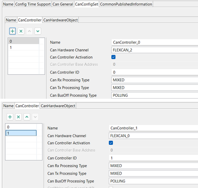

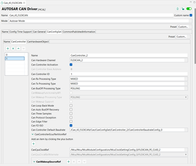

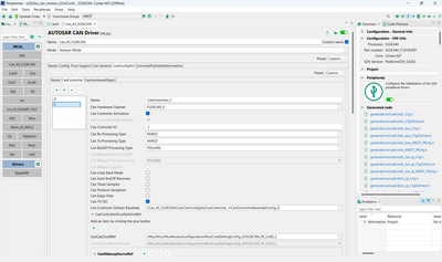

3. In the configuration file from can_test_hw.zip attachment I see that CanController_0 is mapped to FLEXCAN_2 and CanController_1 to FLEXCAN_0. This is confusing but not necessarily incorrect.

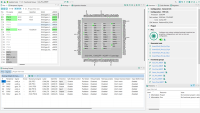

4. I cannot check if the pin mapping is correct as you have a "customized board".

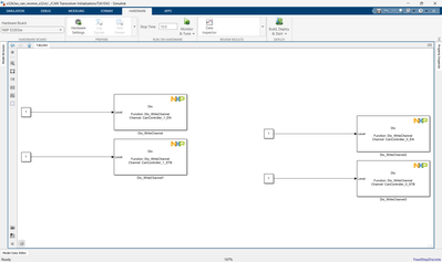

But I do see some inconsistencies: Can0_tx and Can0_rx seem to be mixed up; same issue for Can2. Please check again the pins connected to the transceivers.Adrian_Gherca_1-1722601634716.pngAdrian_Gherca_1-1722601634716.png

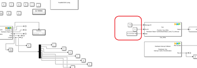

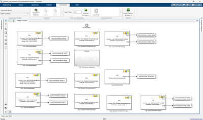

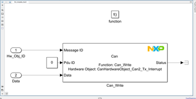

5. Having block inputs connected to line Terminators may be a problem. Try updating the model like this:
I connected an array of constant values [1 2 3 4 5 6 7 8] to the Data input of the Can_Write block.
6. Please check that a CAN termination resistor is connected at the end of the physical CAN bus.

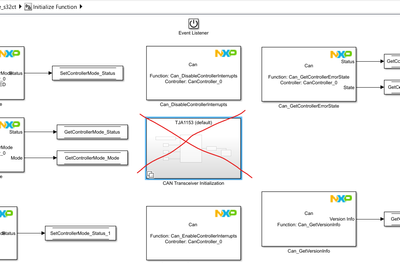

7. Please remove the initialization for TJA1153 transceiver since you only use TJA1043 for all CanControllers:
8. I made a mistake about the microcontroller pin connected to the TJA1043 STB input. The value of this pin needs to be HIGH, not LOW.

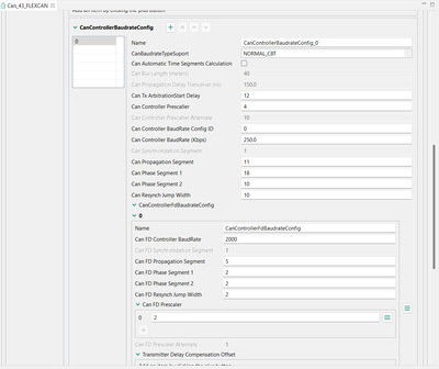

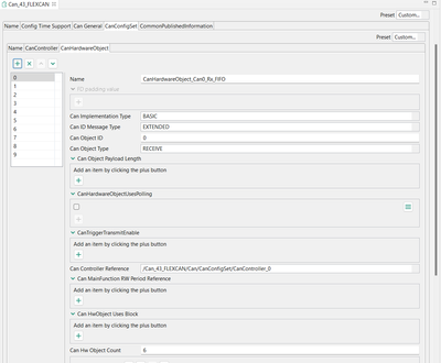

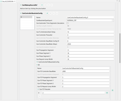

I have attached the configuration pictures with this post below,

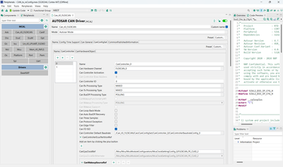

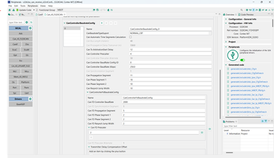

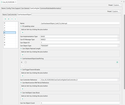

Esakki_1-1723450329096.pngEsakki_1-1723450329096.pngEsakki_2-1723450345534.pngEsakki_2-1723450345534.pngEsakki_3-1723450359588.pngEsakki_3-1723450359588.pngEsakki_4-1723450378226.pngEsakki_4-1723450378226.pngEsakki_5-1723450395018.pngEsakki_5-1723450395018.pngEsakki_6-1723450408600.pngEsakki_6-1723450408600.pngEsakki_7-1723450421163.pngEsakki_7-1723450421163.pngEsakki_8-1723450445969.pngEsakki_8-1723450445969.pngEsakki_9-1723450466016.pngEsakki_9-1723450466016.pngEsakki_10-1723450523054.pngEsakki_10-1723450523054.pngEsakki_11-1723450538977.pngEsakki_11-1723450538977.png
We referred that can transmit and receive examples and Communicating over the CAN Bus - NXP Community
but we doubt that we are making some little issue with this configuration that we can't able to find.

-->> "And we can be able to receive CAN messages and able to read the messages using freemaster."
Are you using Serial FreeMASTER  or  CAN FreeMASTER ?
3,680件の閲覧回数
Vijay98
Hello Adrian,
We are using serial freemaster(PE micro universal JTAG debugger) to read the Can messages.
Thanks & Regards,
Esakki

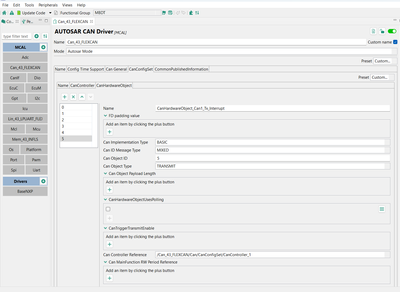

Adrian_Gherca

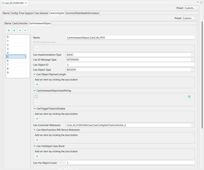

In the picture you provided, the selected CanHarwareObject is "CanHarwareObject_Can1_Tx_Interrupt" which has as Controller Reference "CanController_1". Is it your intention to use CanController_1 instead of CanControler_0 ?

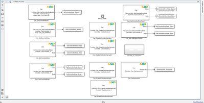

In the "initialize" block from the model you provided I see no initialization for this Can Controller nor for the Can transceiver which is used by this controller.
Please identify the corresponding transceiver (TJA1153, TJA1043, etc) and initialize both the Can Controller and its associated transceiver similarly to our MBDT Can exemples.

Vijay98
Hello Adrian,
1. Yes, for receive the can messages we are using cancontroller_0 instance and for transmitting the can messages we are using cancontroller_1 instance.
2. In initialization, we are initialized both can controller instances with the corresponding transceiver selection i.e., TJA1043.
but we can be able to read the can messages using freemaster,
and for transmitting that same can messages through Cancontroller_1 instance, we can't be able to read those messages in bus master.
