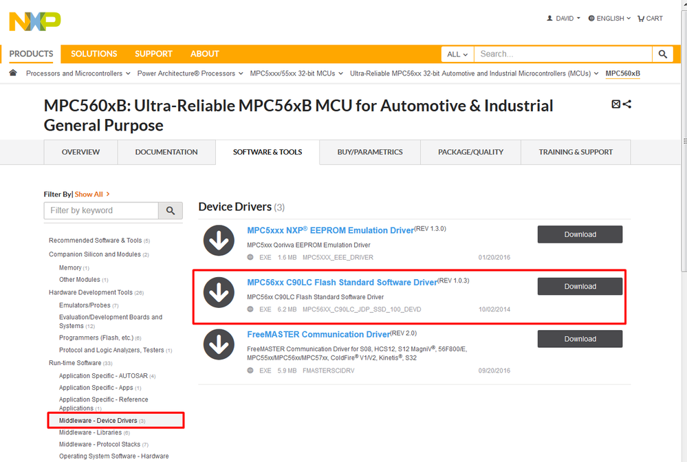

I had to  configure the flash;please offer me the sample code;
thanks a lot;
2,250 Views
davidtosenovjan
I could recommend to see following example codes, it shows simple non-SSD flash programming codes:
Example MPC5643L Flash_program_simple CW210
Example MPC5675K Data_flash_program_simple CW210
Better solution is to use SSD driver, example codes you may then find in installation package:
2,250 Views
martin_kovar
all available sample codes are include in MPC5 example list. Please check the link below:
https://community.nxp.com/docs/DOC-329623
