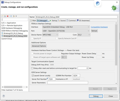

Greetings,
I am new to NXP platform and trying to flash  LED blink example on MPC5748G-DEVKIT. I followed following steps. I see this error.
Error in services launch sequence
PEmicro GDB Launch Failure : The GDB Server was not able to establish a connection to the target processor. Please check your connections and power. Verify that the launch settings in the Debug Configuration are accurate.
Debugging settings look like:
Kindly help me to resolve this issue. Also if anyone can provide any debugging steps to make sure the board I purchased is in good shape would be a great help.

lukaszadrapa
Hi Himateja,
I would try to update the OpenSDA firmware. The procedure is described here:
https://community.nxp.com/t5/S32-Design-Studio-Knowledge-Base/HOWTO-Update-OpenSDA-Firmware-on-EVB/t...
Latest version is 1.10.
Please let me know if it doesn't help.
Lukas

Vkatrenikona
Hi Lukas,
Updating hardware did not help me to resolve the issue. Apologies for delay in my update.
