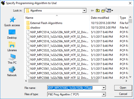

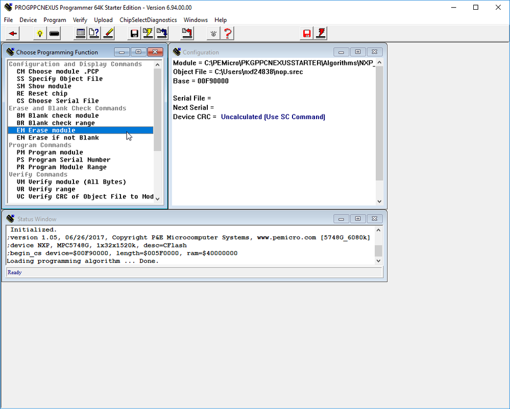

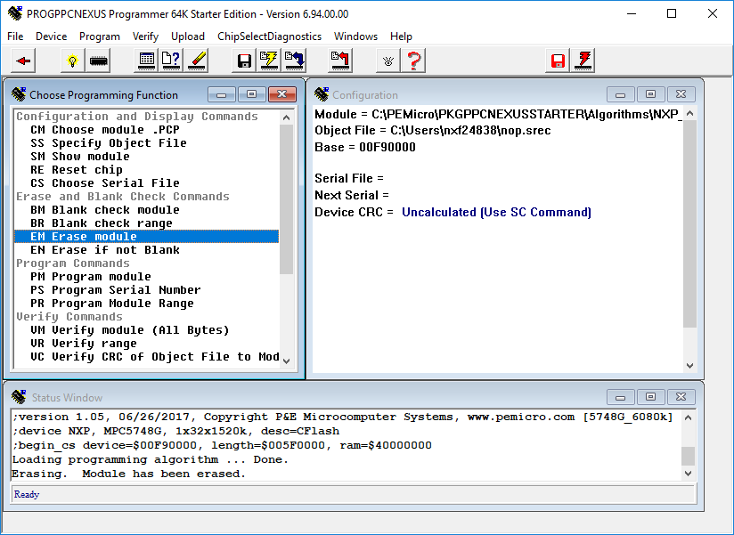

I tried reproduce your issue, but my board is working okay. You already found this thread - DEVKIT MPC5748G S32DS download problem,blocking at Verifying object file CRC-16 to device ranges  - you can try to erase flash. PKGPPCNEXUS  free version supports OpenSDA:
Connect to target, select programming algorithm:
And erase module:
Hope it helps.
Jiri

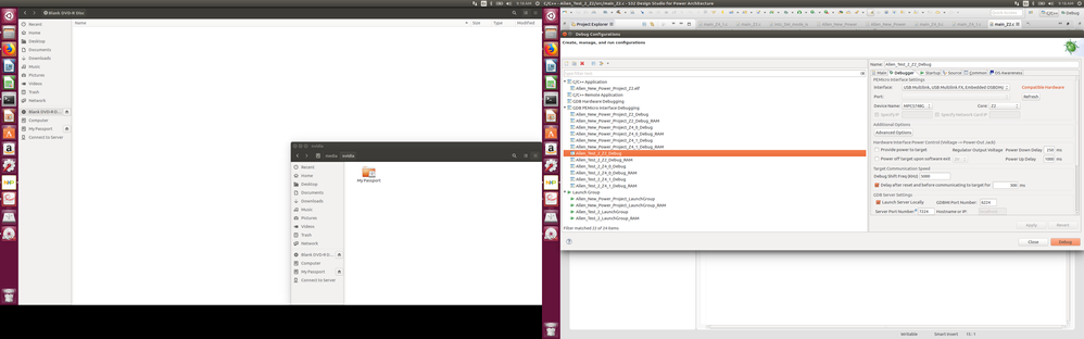

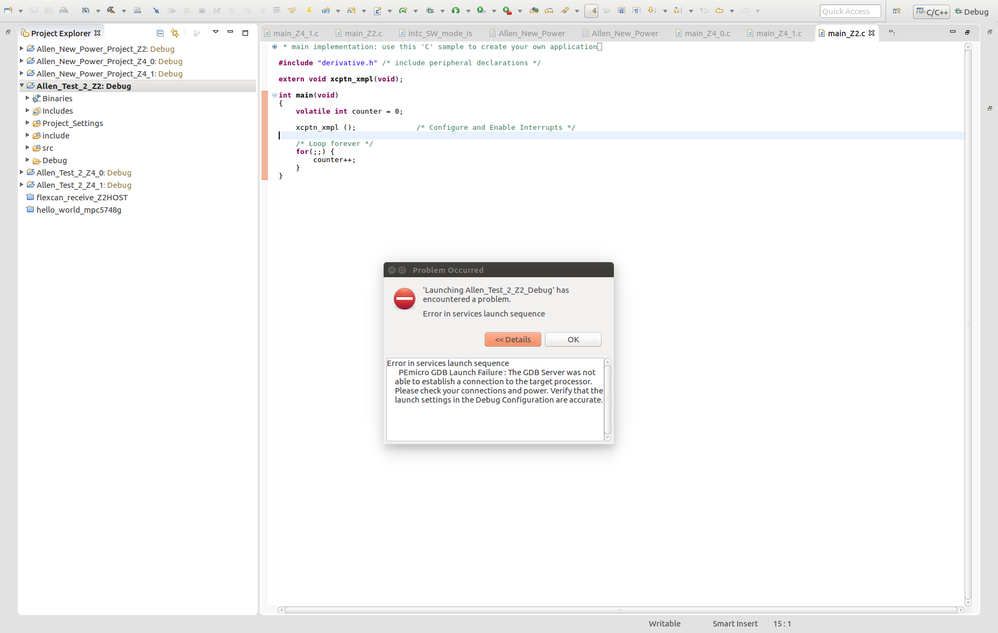

allen_khorasani
Hello ,I had the same problem , we just got a MPC5748G dev kit, and I followed this thread, updates the firm ware ,
HOWTO: Update OpenSDA Firmware on EVB
and updated the debug app from reading the PDF  Updating the OpenSDA Firmware.pdf and now I see this issue ,regardless of which core setting  I choose. Please see the attached screen shots. Any help will be appreciated.debug2.pngDebuf1.png

veeresh_ambe
Hi Jiri,
It worked! Thanks for the big help.

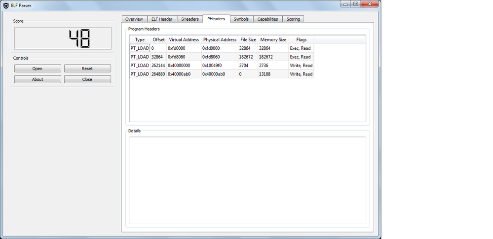

veeresh_ambe

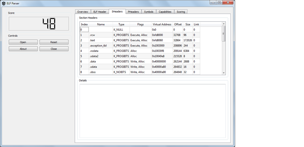

Well I cannot share the source code of the project since we have a NDA agreement with the customer. However I was able to download and test the same elf file earlier. So I dont think the problem is with the source code.
If it is of any help, I have provided some info about the elf file. If there is any other info you require please let me know. TIAlin_elf_details_phead.pnglin_elf_details.png

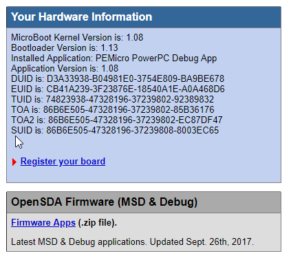

jiri_kral
quick update - I tested three MPC5748G EVBs - and the only one which is not working is EVB with OpenSDA app firmware v1.08:
Second EVB has v1.09  and last one v1.10. Unfortunately - the official latest firmware is v1.08.
Can you please check you FW version? Switch to EVB to bootloader mode - remove OpenSDA USB cable -> press and hold SW3 switch (that one bellow RESET switch) reconnect OpenSDA cable and release SW3 switch. You can see new removable drive named BOOTLOADER on your PC Machine. There is SDA_INFO.HTM file. Double click on int brings up PE Micro page with version info (like on screenshot above).
Jiri

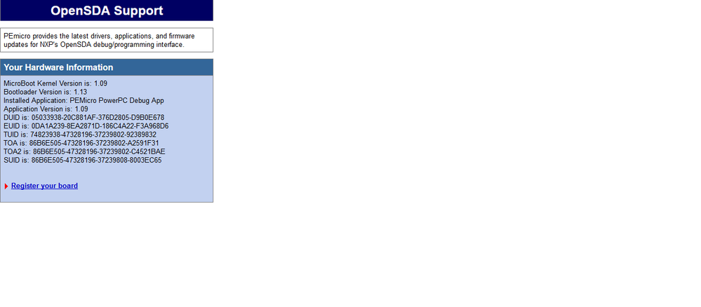

veeresh_ambe
Hi Jiri,
Thanks for the update. The firmware version is V1.09. I have attached the screenshot. firmware_version.png

jiri_kral
for me is working update to OpenSDA to v1.10 https://community.nxp.com/docs/DOC-340263
