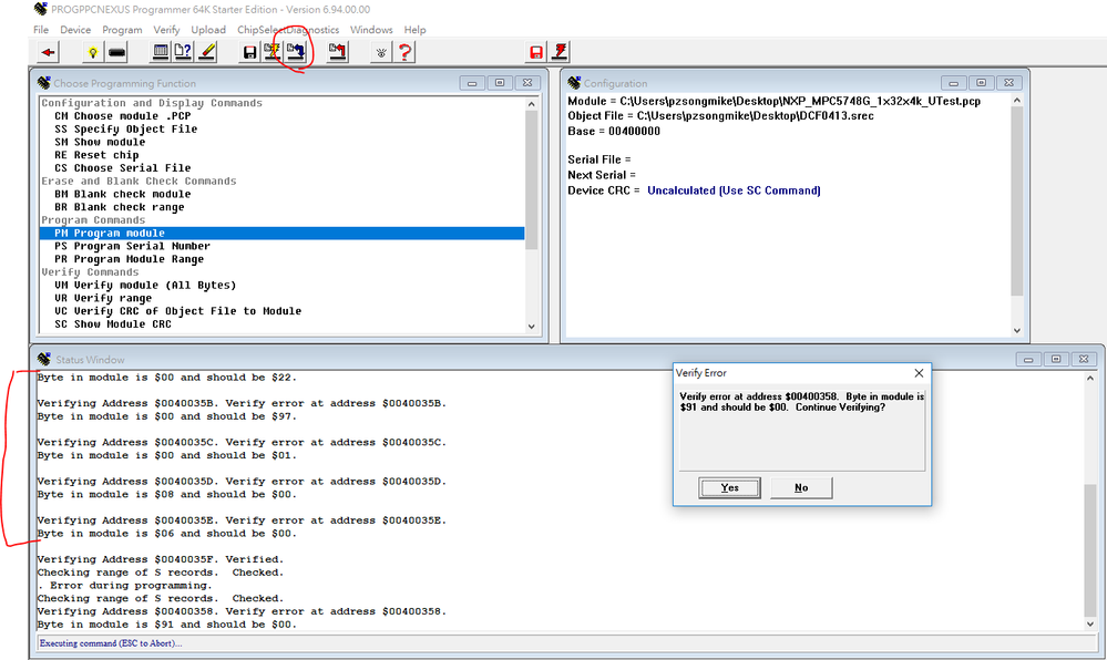

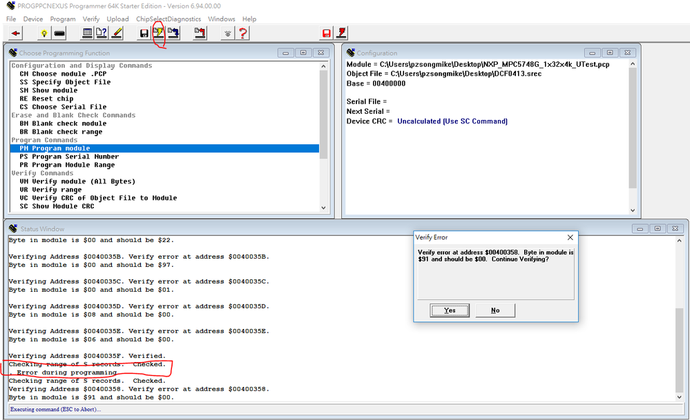

klimmmike123456
I use the mpc5748G board.
I tried the method provided by Jiri, but it didn't work.
Screenshot in the following:
    If I press the verify module
So I still can't write DCF to mpc5748g until now.
Can you help me solve this problem?
by the way
This is my S32 record:  S30D0040035800002297010000009D
(For my SRecord i use this Excel sheet:https://community.nxp.com/docs/DOC-341540)
I am using this flash programming algorithm: NXP_MPC5748G_1x32x4k_UTest.pcp

12,686 Views
jiri_kral
I can reproduce your issue - it looks like that PE micro still didn't fix UTest flash algorithm. I already created ticket for this issue on May 04, 2018 and this ticket is still "In Progress" state.
I'll try find workaround and let you know.
Jiri
