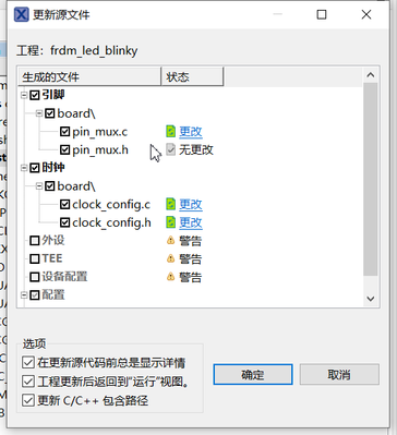

limit1995
It is failed to set break point when debugging with following MCG configuration.
It run well without debugging.
const mcglite_config_t mcgliteConfig_BOARD_BootClockRUN =
        .outsrc=kMCGLITE_ClkSrcExt,             /* MCGOUTCLK source is external clock source */
        .irclkEnableMode = MCG_IRCLK_DISABLE,     /* MCGIRCLK disabled */
        .ircs = kMCGLITE_Lirc8M,                  /* Slow internal reference (LIRC) 8 MHz clock selected */
        .fcrdiv = kMCGLITE_LircDivBy1,            /* Low-frequency Internal Reference Clock Divider: divided by 1 */
        .lircDiv2 = kMCGLITE_LircDivBy1,          /* Second Low-frequency Internal Reference Clock Divider: divided by 1 */
        .hircEnableInNotHircMode = false,         /* HIRC source is not enabled */
Error report
My board is FRDM-MCXC242.
How to deal with the problem?

Hello @limit1995
Could you please show me where you set the breakpoint? And which demo did you use? I will help to check on my side. Thank you.

limit1995
Dear @Alice_Yang
I set the clock configuration based on demo app led_blinky.
Then update the source files.
And step-by-step dubugging caused error like below.
The part of the automatically generated clock_config.c is as follows:

Hello @limit1995
In MCG control register 1, it changes the clock source for the main clock. It cannot be debugged when the clock source is changed.

limit1995
Dear @Alice_Yang ,
It is ok to step-over BOARD_InitBootClocks() with HIRC mode.
But it is failed to step-over BOARD_InitBootClocks() or to set break point with EXT mode. Debugging is not possible at all.
Why?
And I want to know how to debug with EXT mode.
