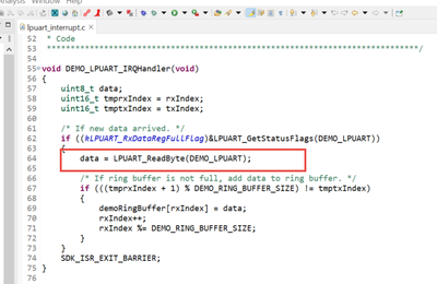

Hello @andrtnnr
Thanks for your question.
Do you want to use Interrupt mode or Polling mode? If interrupt, please refer to lpuart_interrupt_transfer under SDK demo. It calls RX read flag (kLPUART_RxDataRegFullFlag) .
Alice

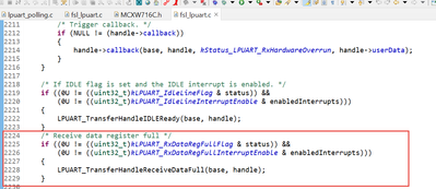

Hello @andrtnnr
The demos "lpuart_interrupt_rb_transfer" and "lpuart_interrupt_transfer"
use  LPUART_TransferHandleIRQ(). You can refer to.
Alice
3,634 Views
andrtnnr
Hey @Alice_Yang,
That seems to work. Thanks for the help.

Hello @andrtnnr
In this demo, it will call the function LPUART_ReadByte() to read data from the receiver register after receiving one dataword.
Alice
