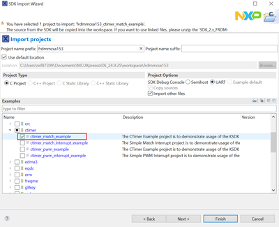

Harry_Zhang
Hi @syedhashmiraza
The MCXA153 does not include an MRT peripheral. To achieve similar functionality, you can use the CTIMER available on the MCXA153.
CTIMER can operate in various modes, including timer mode, which is suitable for generating delays or triggering events like the MRT.
You can refer to the MCXA153SDK ctimer example.

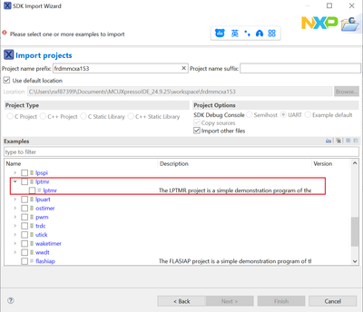

syedhashmiraza
"Hello, can I use LPTMR as a replacement for MRT?"
2,773 Views
Harry_Zhang
Hi @syedhashmiraza
If you want to use LPTMR,
You can refer to the SDK LPTMR examples.
Harry_Zhang_0-1735783088744.pngHarry_Zhang_0-1735783088744.pngHarry_Zhang_1-1735783175769.pngHarry_Zhang_1-1735783175769.png
Harry
