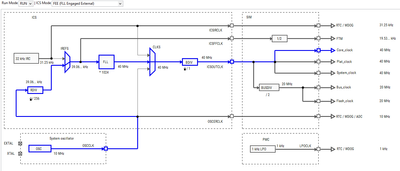

I think that you are making reference to the Core clock frequency.
According the KE02 RM chapter 20 internal clock source, the internal clock is selected, since FLL Engaged Internal mode is automatically selected out of reset. Using MCUXpresso Config tools (Clocks Tool) and after selecting this FLL mode I have obtained 32 MHz of core clock frequency.
If  you are using the MCUxpresso SDK, after running the BOARD_InitBootClocks();  the MCU is running with  internal clock mode in FEE mode , core clock is 40 MHz.
However, I recommend you use the fsl_clock API, to determine any clock frequency from several IP's, including the Clock frequency.

Thank you for your response. I appreciate your help. But I have a question about your answer below. If the crystal's frequency is 10MHz, how can the KE02 core clock run at 40MHz? Doesn't the crystal set the maximum frequency of operation for the uC?

The internal FLL (frequency lock loop) generates a 40 MHz Core clock frequency by multiplying a reference clock by 1024, that way we are able to operate the MCU at a higher frequency than the one generated by the 10 MHz oscilator.
