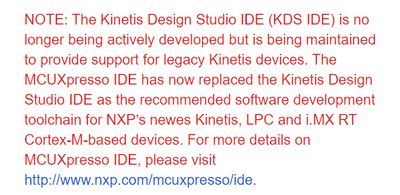

Hi JiHood:
Current MCUXpresso SDK does not have KDS support.
In old version such as KSDK 2.0, it has KDS support.  I will update you when I find one demo with KDS.

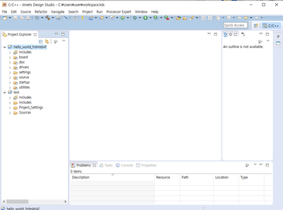

danielchen
Please import SDK_2.3.0_FRDM-K64F\boards\frdmk64f\demo_apps\hello_world\kds into KDS IDE.
12,297 Views

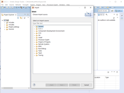

JiHoon1
What should I choose from the picture above?
12,295 Views
danielchen
File>Import>Existing Projects into Workspace > Next > Browse > SDK_2.3.0_FRDM-K64F\boards\frdmk64f\demo_apps\hello_world\kds

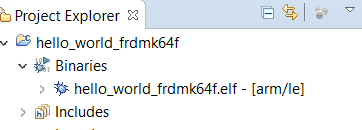

JiHoon1
Binary file not found.
12,284 Views
danielchen
After compile, you will see binaries.
Please refer to KDS USERS guider for more details
12,281 Views
JiHoon1
I found it. Thank you.

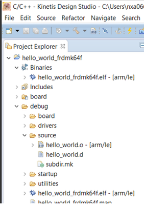

JiHoon1
Where is the compile menu?
12,276 Views
danielchen
click the hammer
