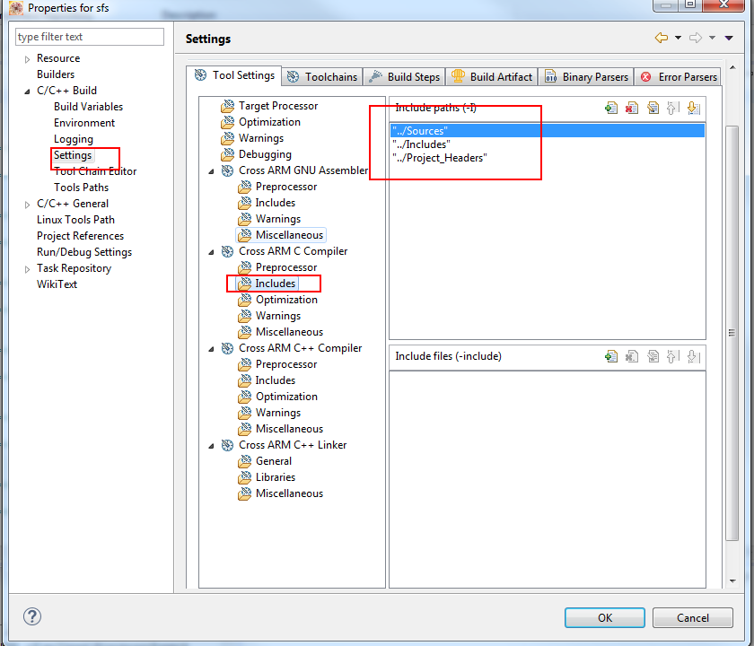

I want to port this example project in CodeWarrior which I have attached here to KDS 3.2. ? Please check it on your side and provide me a working KDS project of the same explaining the changes that you have done.

Hi VIGNESH,
Sure , i create one new KDS project ,then copy your file ,
then add the "Includes paths" :

I have configure it , please check the attachment .

Hi Alice,
            Thanks a lot.I am able to build and compile with the project and add things easily.
1)Can you please tell me what changes you have done compared to project which I gave you?

Hi VIGNESH,

Hi Alice,
             Instead of the two dots specifying the path.Can I use ${ProjName} Variable? in the linker includes path???
