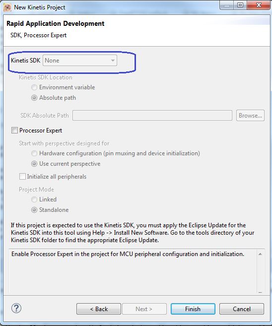

    How to create a normal KDS project without KSDK in KDS 3.2??? Please provide me documents for it?

Hello VIGNESH
To create a Processor Expert in KDS without SDK, please select ‘File’ menu-> New->Processor Expert project.
If you would  not like using Processor Expert either, you can create a new project from ‘File’ menu-> New->Kinetis SDK 1.x project, and after select your processor, please choose ‘None’ for ‘Kineits SDK’ option.
The user manual of KDS can be found under KDS installation folder:
C:\Freescale\KDS_v3\doc
