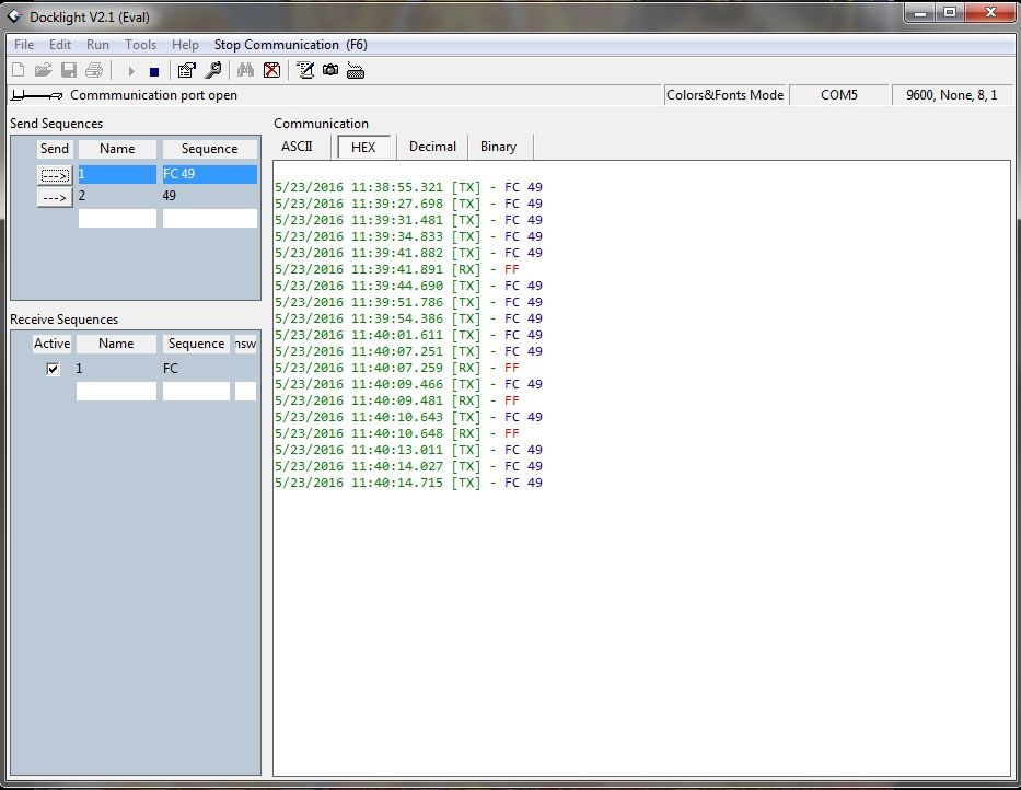

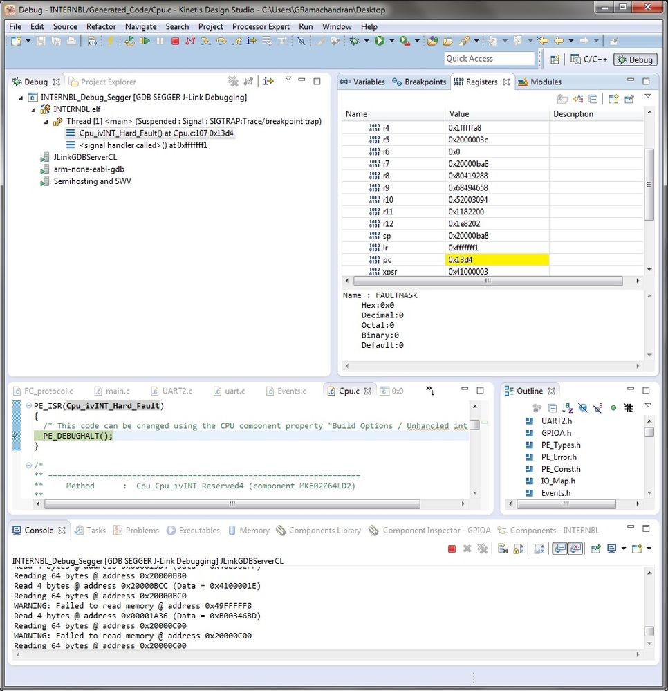

As shown in the screenshot above. I am getting this hardfault problem when I try to debug the UART Boot loader code -AN4767 (whose features I slightly modified according to the Board and the Controller I am using) on a custom board fitted with MKE02Z64VLD2. I am using Docklight v2.1 for serial communication.
The Problem Is,
I debug the code. It debugs fine.
Then I press the resume button in the Kinetis Design Studio IDE (Version 2). No problem occurs.
I open the Docklight and send some characters like this,
For the first time when I send FC 49 am receiving the character FF back. But when I try to send a character for the second or third or nth time. I am ending up with this Hardfault.
Then I re-debug the code, I send a character again, I am receiving a character back, but again when i try to send it the second (or any number of times) like previous attempts I am ending up with HardFault.
How to fix this ?

Hello Ganesh,
Could you set breakpoint to check when run to which place  , then it run to Hardfault ?
You'd better step by step to check when it crash , or you can also take screenshot about the steps.
And have you change the code ?
Another point , when it crash , please check the data of  "uiRepeatCount" ?
