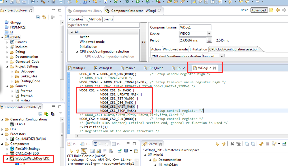

justusandjustic
In Processor Expert, I am unable to find a setting that will disable the debug mask register to enable the watchdog to work correctly in debug mode ("correctly" being "don't keep track of the passage of time during debug breaks").
Looking at the initialization code:
/* WDOG_CS1: EN=1,INT=0,UPDATE=1,TST=0,DBG=1,WAIT=1,STOP=1 */
  WDOG_CS1 = WDOG_CS1_EN_MASK |
             WDOG_CS1_UPDATE_MASK |
             WDOG_CS1_TST(0x00) |
             WDOG_CS1_DBG_MASK |        //<<<<THIS ONE HERE
             WDOG_CS1_WAIT_MASK |
             WDOG_CS1_STOP_MASK;       /* Setup control register */
I've gotten it to work by removing that line and disabling PE from updating the code, but that is not a very elegant solution.  Is there a way I can tell PE to use the debug mask settings I want?

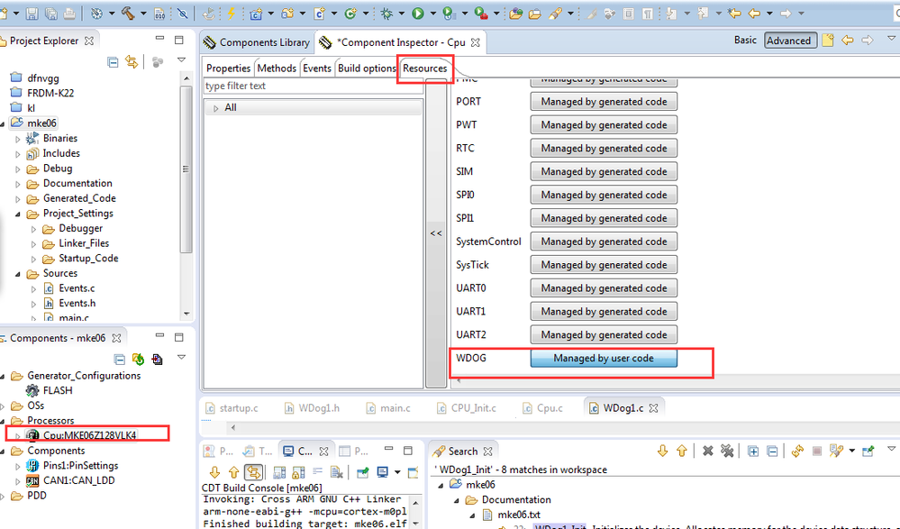

Hello Josiah,
- On one hand you can add the "WatchDog_LDD" component to configure:
- On the other hand , you can use your own code , in the resource part choose "Managegd by user code"
of "WDOG", then write your own code into project .
Hope it helps

5,104件の閲覧回数
justusandjustic
Alice,
I am already using the watchdog component.  The first screenshot you posted shows the exact location of the code I posted in my original question.  The problem is that whenever I build my project, the line:
WDOG_CS1_DBG_MASK |
is added in the init function.  If I remove it, it is re-added the next time I build.  I was hoping there was a setting in the component to let PE know I don't want that line added.  Something like "disable debug mask".  I expected such a setting to exist, but have been unable to find it.
How can I get PE to build the init function without turning on the debug mask?
-Josiah

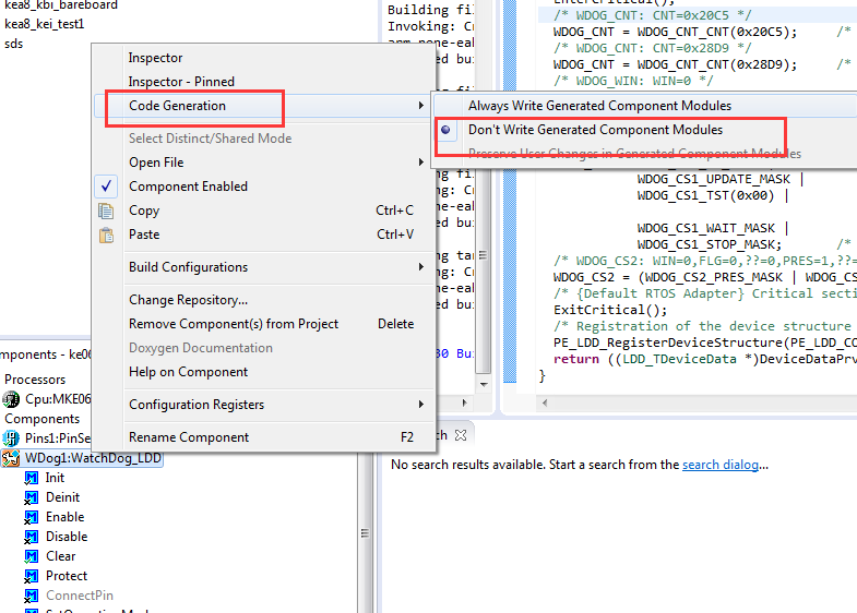

Hello Josiah,
There is a method to don't add that line after you delete it .
After change the code, please right lick the watchdog_LDD component , then choose
"Don't Write Generated Component Modules":
Hope it helps
TIC

justusandjustic
Alice,
As I said before:
"I've gotten it to work by removing that line and disabling PE from updating the code, but that is not a very elegant solution.  Is there a way I can tell PE to use the debug mask settings I want?"
So you're saying that options to set those specific registers, including the debug mask register, don't exist?  That seems very strange.  That means the every time I want to change a different setting in the watchdog component, I need to re-enable code generation, build the code, disable code generation, and delete the line again.
Is it possible this feature will be added in the future?
-Josiah
