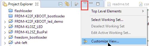

There is another option to filter files in the project view:
I hope this helps,
