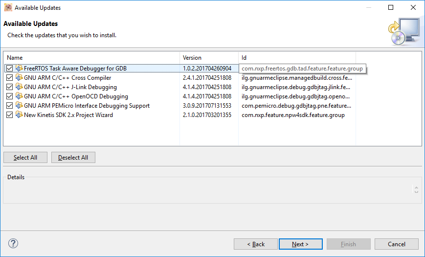

When I check for updates, KDS 3.2 says there are a few updates to things like PEMicro debugger and FreeRTOS debugging plugin.  When I try to update, I get this:
An error occurred while collecting items to be installed
session context was:(profile=DefaultProfile, phase=org.eclipse.equinox.internal.p2.engine.phases.Collect, operand=, action=).
No repository found containing: osgi.bundle,com.nxp.freertos.gdb.tad,1.0.2.201704260904
No repository found containing: osgi.bundle,com.nxp.npw4ksdk,2.1.0.201703201355
No repository found containing: osgi.bundle,com.pemicro.core,1.2.0
No repository found containing: osgi.bundle,com.pemicro.debug.gdbjtag.pne,3.0.9.201707131553
No repository found containing: osgi.bundle,ilg.gnuarmeclipse.core,3.4.1.201704251808
No repository found containing: osgi.bundle,ilg.gnuarmeclipse.debug.core,1.2.1.201704251808
No repository found containing: osgi.bundle,ilg.gnuarmeclipse.debug.gdbjtag,3.2.1.201704251808
No repository found containing: osgi.bundle,ilg.gnuarmeclipse.debug.gdbjtag.jlink,4.1.4.201704251808
No repository found containing: osgi.bundle,ilg.gnuarmeclipse.debug.gdbjtag.openocd,4.1.4.201704251808
No repository found containing: osgi.bundle,ilg.gnuarmeclipse.debug.gdbjtag.restart,1.3.1.201704251808
No repository found containing: osgi.bundle,ilg.gnuarmeclipse.managedbuild.cross,2.4.1.201704251808
No repository found containing: osgi.bundle,ilg.gnuarmeclipse.packs.core,1.1.3.201704251808
No repository found containing: org.eclipse.update.feature,com.nxp.feature.npw4sdk,2.1.0.201703201355
No repository found containing: org.eclipse.update.feature,com.nxp.freertos.gdb.tad.feature,1.0.2.201704260904
No repository found containing: osgi.bundle,com.nxp.sdkmanifest,1.0.0.201701180731
No repository found containing: org.eclipse.update.feature,com.pemicro.debug.gdbjtag.pne.feature,3.0.9.201707131553
No repository found containing: org.eclipse.update.feature,ilg.gnuarmeclipse.debug.gdbjtag.jlink,4.1.4.201704251808
No repository found containing: org.eclipse.update.feature,ilg.gnuarmeclipse.debug.gdbjtag.openocd,4.1.4.201704251808
No repository found containing: org.eclipse.update.feature,ilg.gnuarmeclipse.managedbuild.cross,2.4.1.201704251808An error occurred while collecting items to be installed

BlackNight
Hi David,
this could be a network connection issue. I  recommend you use the menu Help > Install New software and check for the upates from there, one after each other.
But there is for sure a possible problem with the GNU ARM (new MCU) Eclipse plugins: the update site is on SourceForge and starting with this year they extended the connection security settings which can lead to a failure. For this, you better get the update from Downloads
I hope this helps,
Erich

dsherman
That's unfortunate, so one has to write down  all that need updating, and install them all manually from this other site?  Here's what's balking.  I've tried installing them individually, but they all produce the same error.  The "install new software" approach doesn't work either.

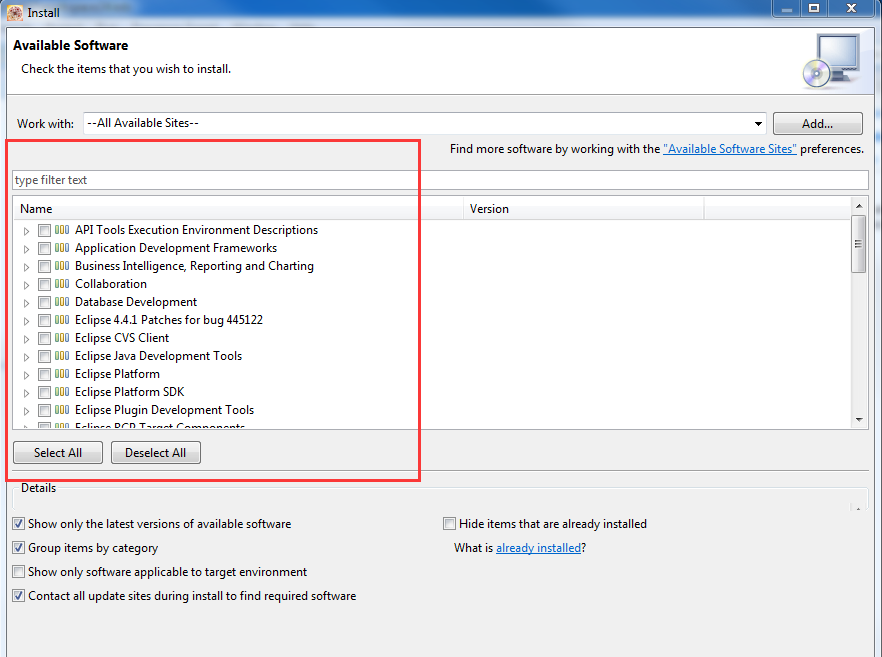

BlackNight
Hi David,
it seems something is interrupting your network connection or takes too long.
Can you try just to do the update for the Kinetis SDK v2 wizard. Make sure you uncheck 'Contact all update sites' (see Reduce Eclipse ‘Install New Software’ Installation Time | MCU on Eclipse ).
I hope this helps,
Erich

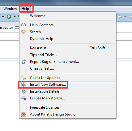

Hello David,
Please use the "Install New Software" as Erich said:
Hope it helps
