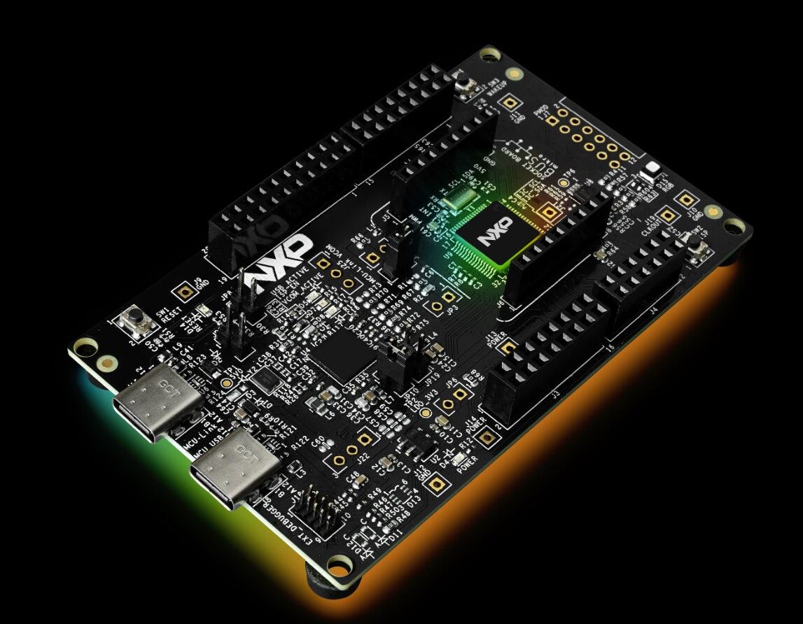

Whether you're a student, hobbyist, or professional developer, the FRDM Development Platform by NXP is your gateway to building powerful embedded applications—quickly and affordably. In this beginner-friendly guide, you’ll learn: What FRDM boards are and how they compare to other NXP evaluation kits Who the platform is designed for How to buy and get started with your first board What’s new in the latest FRDM series featuring MCX microcontrollers and i.MX processors How the FRDM ecosystem supports your development with modular hardware, software tools, and ready-to-use code examples
