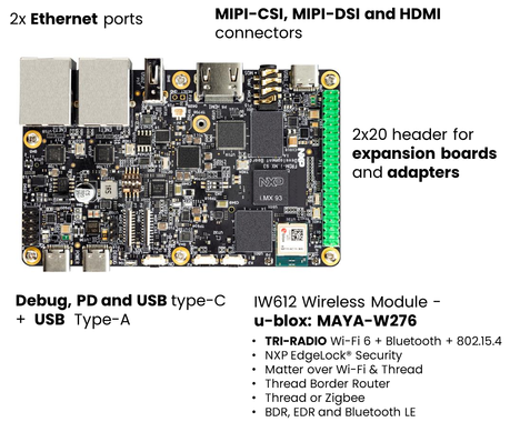

FRDM-IMX93 development boards are the first FRDM development board with i.MX MPUs and include Wi-Fi and Bluetooth modules and support for Debian, Yocto and GoPoint which will help you to develop your industrial and IoT applications quickly with NXP's developer experience.
FRDM-IMX93 Applications
Low-cost development board usage, Bi-annual BSP release for Debian
Yearly BSP release for Yocto.
Get to know FRDM-IMX 93 Development Board
Specifications
  • 2x Arm Cortex®-A55 + Cortex®-M33
  • Wi-Fi 6 + BT + 802.15.4 Module on-board, IW612
  • 2x GB Ethernet (1xETER, 1xTSN)
  • MIPI-CSI/DSI, HDMI
  • M.2 Connector
  • LPDDR4X 16-bit 2GB
  • eMMC 5.1, 32GB
  • MicroSD 3.0 card slot
  • 3x USB 2.0 Type-C connector (one for Debug, one PD only) + 1x USB 2.0 Type-A
  • RTC, Buttons and LED
Feature
FRDM-IMX93
eMMC
32GB
DRAM
Micron 2GB
PMIC
PCA9451A
WiFi Module
u-blox MAYA-W276 on-board
USB TYPE C
Type-C+Type-A
ENET
2xGbE
M.2 (Key E) SDIO WiFi / BT
Y (rework needed)
HDMI
IT6263/Y
MIPI DSI Panel
22 Pins FPC HDR
LVDS Panel
N
MIPI CSI camera
22 Pins FPC HDR
2x20 Expansion Interface
Y
CAN BUS
Y
MicroSD
Y
UART
Y
Audio
 MQS
Remote Debug
N
NXP Connector (CAN,ADC, I2C)
Y
Power Connector
Type-C
PCB layers
10
Base Board DIM
6.5x10.5cm
NXP Devices On-Board
PMIC
PCA9451A
USB PD TCPC PHY IC
PTN5110
High-Voltage USB PD Power Switch
NX20P5090UK
IIC  Extends  GPIO
PCAL6524/PCAL6408A
CAN Transceiver
TJA1051T/3
USB Sink & Source combo power switch
 NX20P3483UK
USB Type-C CC and SBU Protection IC
 NX20P0407
Real-time clock/calendar
PCF2131
Wi-Fi, BT, 802.15.4 Tri-Radio
IW612 (in u-blox Module)
Expansion Boards
FRDM-IMX93 web page
Getting Started Guide
  • Out of the Box
  • Get Software
  • Build and Run
  • Developer Experience
Projects and Tutorials
  • Debug Terminal in Linux & Windows
  • Cortex-M33 Enablement
  • Deploy ML models on NPU
  • Graphics
  • Security and Integrity
  • Fast Boot
Trainings
Documentation
FRDM-IMX93 Quick Start Guide
