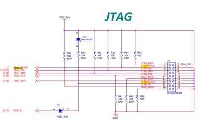

MCU : IMXRT1170-EVB
J-LINK , i want to use JTAG mode
swd mode works fine, but jtag mode is error.
I've referred to the posts below, but it doesn't work out.
help me please
https://community.nxp.com/t5/i-MX-RT/RT1176-connect-to-JLINK-with-a-warning/m-p/1599341
https://community.nxp.com/t5/i-MX-RT-Knowledge-Base/Using-J-Link-with-MIMXRT1160-EVK-or-MIMXRT1170-E...
1. i try j6,j7 jumper remove
2. Is there anything in the circuit that needs to be changed?

Hi @sukyeong ,
By default, the RT1170 silicon can use both SWD and JTAG modes using the Arm stitching sequence. For the RT1170EVK board, it defaults to use the SWD debug without any board modification. If you want to use the JTAG debug, solder out R187, R208, R195, and R78, because some JTAG signals are multiplexed with other functions.

Hi @sukyeong ,
Please try to remove R2152 and  R2038.

sukyeong
R2152, R2038을 찾을 수 없습니다..
자세한 내용을 알려주실 수 있나요?

jingpan
Hi @sukyeong ,
You can search to this doc.

jingpan
Hi @sukyeong ,
What is your board, EVK or EVKB?
Jing
7,518件の閲覧回数
sukyeong
My board is EVK.
sorry for the confusion
@jingpan
7,507件の閲覧回数
jingpan
Hi @sukyeong ,
