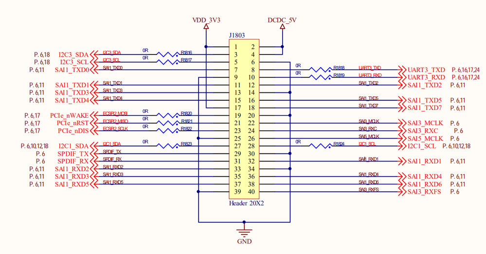

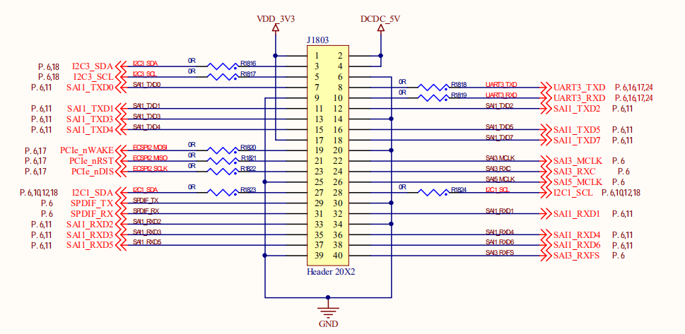

I want to change the default routing for the next three pins by configuring the device tree.
Because we now want to lead out 40 pins on the new board for users' independent development, including SPI,GPIO,UART,I2C device interface.
So,what I shound do through change dts.
Attached is the hardware schematic diagram of customer development board

Hello gaobo,
See below steps, please!
1. Remove these pins related to ECSPI2
    pinctrl_pcie1: pcie1grp {
        fsl,pins = <
            MX8MQ_IOMUXC_I2C4_SDA_PCIE2_CLKREQ_B        0x76 /* open drain, pull up */
            MX8MQ_IOMUXC_ECSPI2_SCLK_GPIO5_IO10        0x16
            MX8MQ_IOMUXC_ECSPI2_MISO_GPIO5_IO12        0x16
By default, on i.mx8mq-evk, above 2 pins are multiplexed as GPIO, both for PCIe port, so you should remove them, and then assign other 2 GPIOs for PCIe port if you also want to use PCIe.
2. Referring to eCSPI code in imx8mn-evk.dts, add ecspi of i.MX8MQ to your board dts.
Below is from imx8mn-evk.dts
        pinctrl_ecspi2: ecspi2grp {
            fsl,pins = <
                MX8MN_IOMUXC_ECSPI2_SCLK_ECSPI2_SCLK        0x82
                MX8MN_IOMUXC_ECSPI2_MOSI_ECSPI2_MOSI        0x82
                MX8MN_IOMUXC_ECSPI2_MISO_ECSPI2_MISO        0x82
        pinctrl_ecspi2_cs: ecspi2cs {
            fsl,pins = <
                MX8MN_IOMUXC_ECSPI2_SS0_GPIO5_IO13        0x40000
Change related pins to those of i.MX8MQ's, please!  then add code to your dts for i.MX8MQ.

Hi Wigros Sun:
Return the SPI problem.After configuring the device tree in your way.I should get two devices /dev/spidev1.0 and /dev/spidev1.1 because I have a chip selection pin,but now I just get a spidev /dev/spidev1.0.
Should  MX8MQ_IOMUXC_ECSPI2_SS0_GPIO5_IO13  is replaced by MX8MQ_IOMUXC_ECSPI2_SS0_ECSPI2_SS0
We look forward to your relpy!

你要连接2个device,当你的device tree里需要给spi节点2个chipselect了。你现在只有一个,那么就会只有spidev1.0。
(1)你的引脚定义的24/26脚,没有连接到ECSPI2_SS0上,那么也就是说上面的复用是无效的。你应该一个spidev都看不到的。
(2)你的CE0/CE1用的是SAI3_RXC和SAI5_MCLK,理论上复用为GPIO做应该可以做CS用。你可以试试行不行。

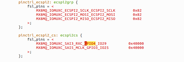

            fsl,pins = <
                MX8MQ_IOMUXC_ECSPI2_SCLK_ECSPI2_SCLK         0x82
                MX8MQ_IOMUXC_ECSPI2_MOSI_ECSPI2_MOSI        0x82
                MX8MQ_IOMUXC_ECSPI2_MISO_ECSPI2_MISO        0x82
            fsl,pins = <
                MX8MQ_IOMUXC_SAI3_RXC_GPIO4_IO29        0x40000    /*CS0*/
                MX8MQ_IOMUXC_SAI5_MCLK_GPIO3_IO25      0x40000   /*CS1*/

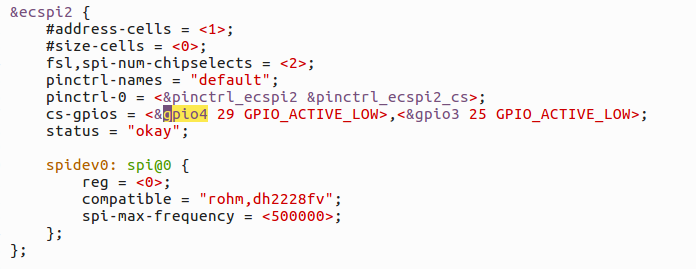

&ecspi2 {
    #address-cells = <1>;
    #size-cells = <0>;
    fsl,spi-num-chipselects = <2>;
    pinctrl-names = "default";
    pinctrl-0 = <&pinctrl_ecspi2 &pinctrl_ecspi2_cs>;
    cs-gpios = <&gpio4 29 GPIO_ACTIVE_LOW>,<&gpio3 25 GPIO_ACTIVE_LOW>;
    status = "okay";
/* code below is determined by what device is connected to eCSPI, change it to yours */
    spidev0: spi@0 {
        reg = <0>;
        compatible = "rohm,dh2228fv";
        spi-max-frequency = <500000>;
你试试上面的方法。

我按照您的方法对fsl-imx8mq-evk.dts设备树文件进行了配置,但是并没有生成设备节点。我猜想是不是SAI3_RXC和SAI5_MCLK的pad control reg 的值配置错误了,不应该是0x40000,寄存器的值应该是0x15或者0x5吧。

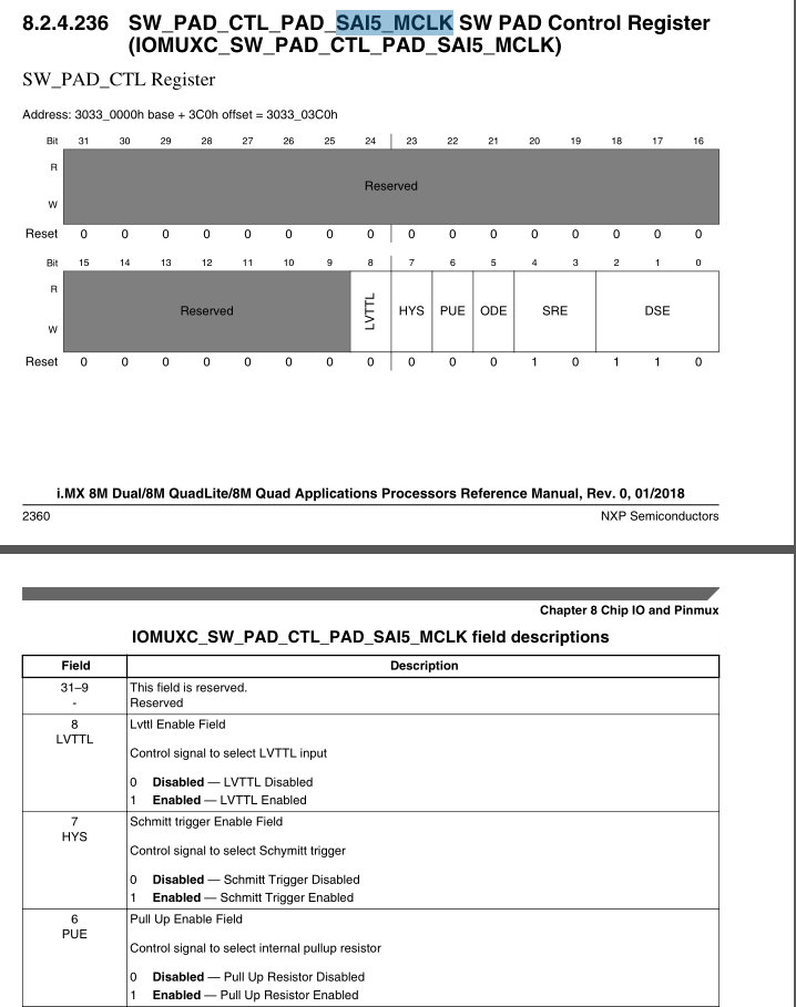

40,360 Views
gaobo

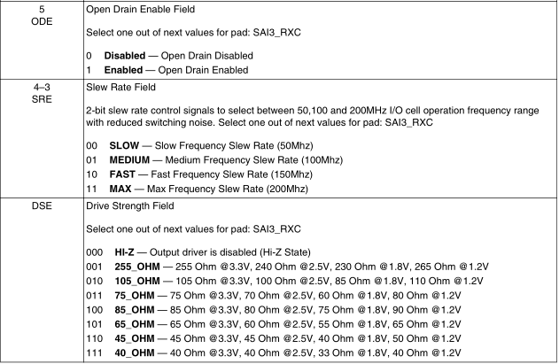

我根据您配置ECSPI2_SCLK、ECSPI2_MOSI、 ECSPI2_MISO三个管脚的控制寄存器的值,来配置了SAI3_RXC和SAI5_MCLK两个控制寄存器的值为0x82但是结果差强人意,还是没有出现相应的spidev,但是新添加的ecspi2节点应该是注册上了。
为了节约您的时间。我把SAI3_RXC和SAI5_MCLK两个管脚控制寄存器的datasheet放在下面,麻烦您帮忙解决一下。
40,360 Views
weidong_sun
DSE = 100
SRE = 01
ODE = 0
PUE = 0
HYS = 1
LVTTL = 0
凑起来就应该是:          1000 1100 -- >0x8C
你试试行不行。
Weidong

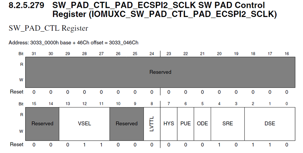

gaobo
Hi Wigros Sun:
Thanks for you advice.But I still have a question.Why ues 0x82 in node? When I modified GPIO earlier, I looked for the MUX register offset address in the include/dt-bindings/pinctrl/pins-imx8mq.h file.In pins-imx8mq.h I'm not find 0x82.
  #define MX8MQ_IOMUXC_ECSPI2_SCLK_ECSPI2_SCLK                                0x204 0x46C 0x000 0x0 0x0
  #define MX8MQ_IOMUXC_ECSPI2_MOSI_ECSPI2_MOSI                                0x208 0x470 0x000 0x0 0x0
  #define MX8MQ_IOMUXC_ECSPI2_MISO_ECSPI2_MISO                                0x20C 0x474 0x000 0x0 0x0
  #define MX8MQ_IOMUXC_ECSPI2_SS0_GPIO5_IO13                                      0x210 0x478 0x000 0x5 0x0
We look forward to your reply!Have a nice day!

weidong_sun
See below configurations, please!
            fsl,pins = <
            fsl,pins = <
                MX8MQ_IOMUXC_ECSPI2_SS0_GPIO5_IO13         0x40000
0x82 is value of it's PAD control register, for example: ECSPI2_SCLK's pad register is :IOMUXC_SW_PAD_CTL_PAD_ECSPI2_SCLK , page 1744, reference manual.
the register is used to tune driver strengh of the PAD.   you can change the configuration for you application.
For other pads, like ECSPI2_MOSI/ECSPI2_MISO/ECSPI2_SS0, they also have related pad control register.
they are all described in reference manual.
Have a nice day!

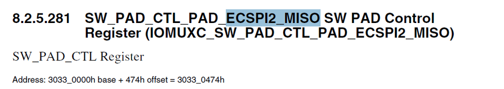

40,360 Views
gaobo
Hi Wigros Sun:
I see what you mean.I want to know how to select the pad register value of other pins in dts.The pins correspond to each other on the two pictures.
We look forward to you reply.
Have a nice day!
40,360 Views
weidong_sun
it means that 0x82 will be written to IOMUXC_SW_PAD_CTL_PAD_ECSPI2_SCLK. Not Read.
Read and understand each filed of the register. then configure (write value to the register) them.
Weidong
