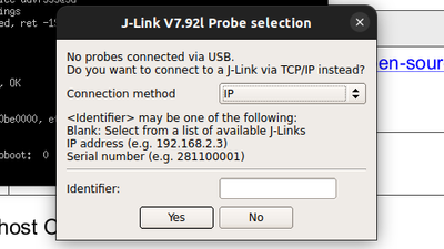

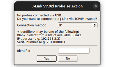

Hello all,
I have the imx8mp pevk boar and tried to start the debugger to flash/connect to the cortex m7 core.
No idee how to do it, installed vscode, can compile the demo software, but the debuggers do not connect to the board, the boar is connected to the PC, I can see uart logs from Linux.
mircea@chimen:~$ /usr/local/LinkServer_1.3.15/LinkServer probes
# Description Serial
mircea@chimen:~$ /opt/SEGGER/JLink/JLinkGDBServerCLExe -listprobes USB
SEGGER J-Link GDB Server V7.92l Command Line Version
JLinkARM.dll V7.92l (DLL compiled Oct 25 2023 15:20:43)
<ProbeList>
</ProbeList>
mircea@chimen:~$ /usr/local/pemicrogdbserver/pegdbserver_console -showhardware
P&E GDB Server for Arm(R) devices, Version 9.32.00.00
Copyright 2018, P&E Microcomputer Systems Inc, All rights reserved
Loading library /usr/local/pemicrogdbserver/gdi/unit_ngs_arm_internal.so ... Done.
Command line arguments: -showhardware
mircea@chimen:~$
Any ideea?
Br, Mircea

Does no work:
The board is not appearing for Jlink.
I read the documentation, I have experience with J-link/Segger, and well, looks to me I need some linux drivers. but again. Can you please test on your side that it works?
I saw a patch referenced in the doc, is it for linux?
Br, Mircea

Ahelion
I tried it on am windows machine also, same issue, no connection. Do you have special nxp drivers?

Ahelion
Tested on another windows 11 laptop, still no debug possible:
OS: Microsoft Windows [Version 10.0.22621.2861]
Drivers for what? I installed the segger thing both via vscode mxuespresso installer, and I also downloaded the it from segger:
All I see is com ports 1,2,3,4.
