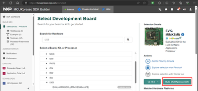

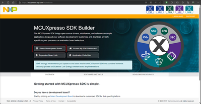

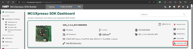

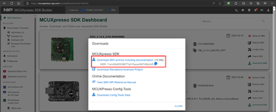

  1. Enter Welcome | MCUXpresso SDK Builder (nxp.com)
  2. Click on "Select Development Board"
  3. Select EVK-MIMX8MN (MIMX8MN6xxxJZ) from Boards -> i.MX -> EVK-MIMX8MN

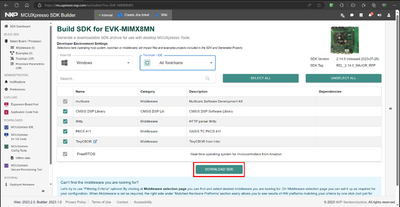

  4. Click on the Build MCUXpresso SDK button
  5. Click on Download SDK, you'll be redirected to the MCUXpresso SDK Dashboard
  6. Look for the i.MX 8M Nano SDK and click on Download SDK
  7. Click on Download SDK archive and documentation, accept the Software Terms and Conditions and the .zip file for the SDK will be downloaded.

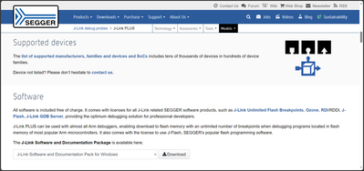

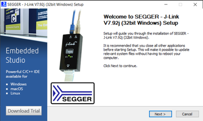

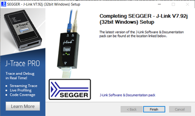

  1. J-Link Software and Documentation Pack for Windows
    1. Download J-Link Software and Documentation Pack for Windows (https://www.segger.com/products/debug-probes/j-link/models/j-link-plus/)
    2. Execute .exe file downloaded and then click on "Next"
    3. Follow the installation wizard with default parameters and click on "Finish".

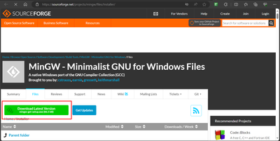

  2. MinGW
    1. Download the MinGW installer from MinGW - Minimalist GNU for Windows - Browse /Installer at SourceForge.net. Follow the installer instructions leaving all options in their default values.
    2. Click on Continue when the installer finishes.
    3. A MinGW Installation Manager window will pop up, select mingw32-base and msys-base from basic setup. Click on the Installation menu and select Apply Changes.
    4. On the next window, click on Apply and wait for the package to finish downloading.
    5. Add the appropriate item to the Windows operating system path environment variable. It can be found under Control Panel->System and Security->System->Advanced System Settings in the Environment Variables... section. The path is: \bin. Assuming the default installation path, "C:\MinGW". If the path is not set correctly, the toolchain does not work. Note: If you have C:\MinGW\msys\x.x\bin in your PATH variable (as required by KSDK 1.0.0), remove it to ensure that the new GCC build system works correctly.

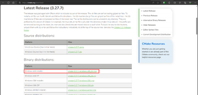

  3. CMake
    1. Download CMake Windows x64 Installer from  Download CMake. Scroll down to find the latest release for the installer:
    2. Run the installer and follow the instructions. Make sure to check the Add CMake to system PATH for all users option during the installation process.
    3. Restart your PC to apply changes.

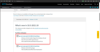

  4. GNU ARM Embedded Toolchain
    1. Download the GNU ARM Embedded Toolchain installer from Downloads | GNU Arm Embedded Toolchain Downloads – Arm Developer, scroll down to find the latest release for the installer:
    2. Follow the installer instructions and check the Add to PATH option at the end of the process.

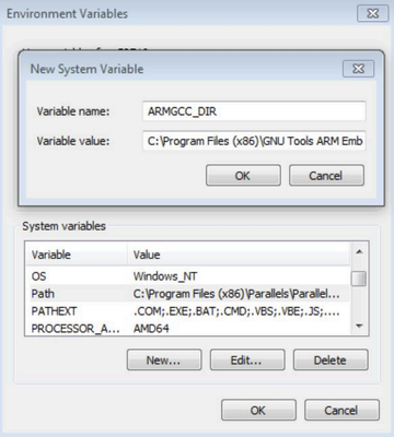

    3. Add a new system environment variable named ARMGCC_DIR with the GNU ARM embedded Toolchain installation path as its value
      ARMGCC_DIR=ARMGCC_DIR=C:\Program Files (x86)\GNU Arm Embedded Toolchain\10 2021.10​

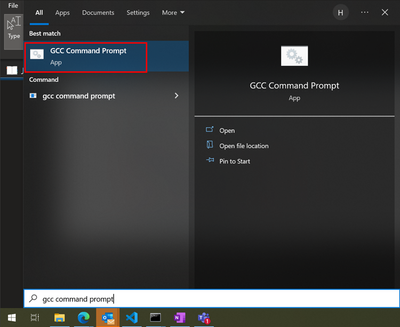

Build and example application

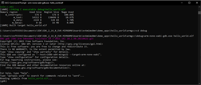

  1. Press the Windows Key and search for GCC Command Prompt and run it.
  2. Change the directory to the example application project directory (inside the armgcc folder), for example:
    C:\Users/<user>\Documents\8MNANO\boards\evkmimx8mn\demo_apps\hello_world\armgcc
  3. Type build_debug.bat on the command line or double click the build_debug.bat file (inside the armgcc folder of the application project) through Windows Explorer
  4. Wait for the building process to end and make sure no error messages are shown.

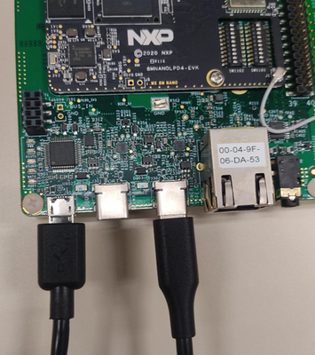

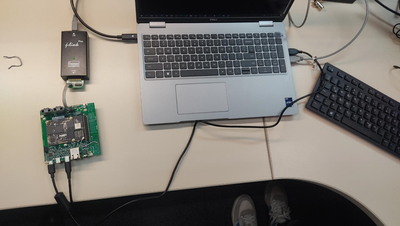

Target Setup

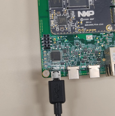

  1. Connect the debug cable (USB-UART) to the board and the other end to your PC.
  2. Connect the power cable to the second USB-C port and to a wall socket. Don't turn on the board yet.

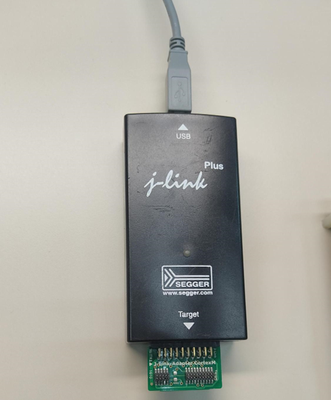

  3. Connect the JLink Plus to your PC with the USB cable.

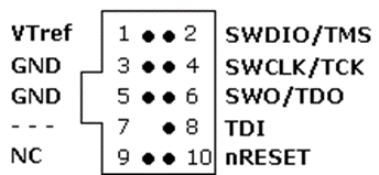

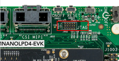

  4. Connect the JLink Plus to the JTAG of the i.MX 8M Nano EVK board
    In this part we will need to identify pin number 1 from the 9 Pin Cortex-M adapter and from the i.MX 8M Nano EVK board. For the first one identify pin 7 identifiable by a "Non-connect pin".
    For the i.MX 8M Nano, you can identify easily with a number 1 in one corner of the connectors.
  5.  The whole setup should look similar to this:

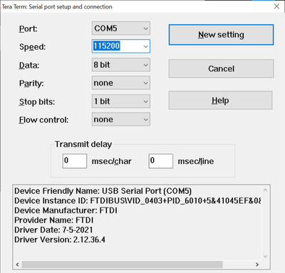

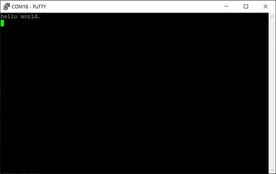

  1. Open a terminal application (TeraTerm, PuTTY, etc.) on your host PC and set it to the serial debug port with the lowest numbered port with the following settings:
    Speed: 115200
    Data: 8-bit
    Parity: none
    Stop bits: 1 bit
    Flow Control: none

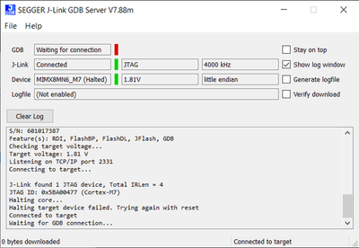

  2. Start SEGGER J-Link GDB Server.
  3. On section “Target Device” select MIMX8MN6_M7 and click “OK”.
  4. You will see the following window.

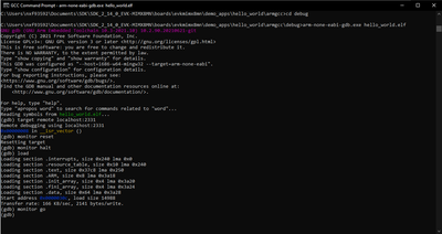

  7. Run the command:
    arm-none-eabi-gdb.exe <application_name>.elf.​
    Example:
  8. At this point you are in the GDB Command Prompt, run the following commands:
    target remote localhost:2331
    monitor reset
    monitor halt
    load
    monitor go
  9. The application will be now running and you can see the “hello world” on your terminal (PuTTY,Tera Term, etc.).
