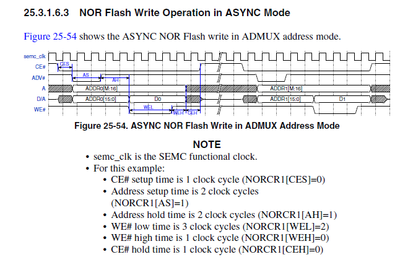

I want to interface parallel NOR flash (256KB*16) with IMXRT1062 but this processor have same port pins for address and data bus. So, I find that ADV#. What is use of this ADV# pin?
I have found this notes for SRAM. Is it same applicable for NOR flash also?
ADV# pin enables Address Path (ADQ=Address Buffer) by asserting ADV# input Low. When ADV# is High, Data Path is enabled (ADQ=I/O Buffer).

Omar_Anguiano
From the SEMC side, the data and address pins will be on MUX mode so it is not possible to have dedicated address/data pins for NOR flash. The communication will look like this:
Regarding using an external component to separate these signals. It looks viable however I cannot confirm if it is your adequate solution since it was not tested on our side.

Omar_Anguiano
Yes, the use of ADV on nor flash is similar to the SRAM.

VishalAvg
Ok, Thanks for help.
Please tell me one more thing.
How can I interface parallel NOR flash for separate address bus and data bus? Can we interface directly?
If I interface same terminal of imxrt1062 with NOR flash address and data pins then command will be transfered on both bus of parallel NOR flash.
I have attached one image.
I am thinking to add two 74LVC164245 IC in between imxrt1062 and flash chip. So that we can separate address/data transfer to flash chip.

Omar_Anguiano
