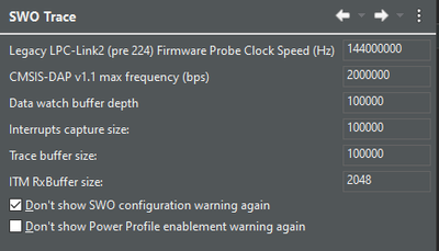

Configuration:
  • Main Clock speed: 528MH (#define BOARD_BOOTCLOCKRUN_CORE_CLOCK 528000000U)
  • Trace clock speed: 108MHz (#define BOARD_BOOTCLOCKRUN_TRACE_CLK_ROOT 108000000UL)

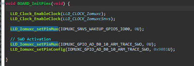

With this configuration, i am not using autodetect and set the Trace clock of 108MHz manually :

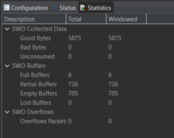

Configuration of the SWO:
Widgets working:
Basically all except SWO Datas so SWO Profile/Interrupts/Timer/Console is OK.

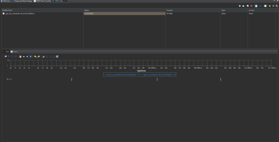

Widget which is not working:
SWO Data plot is quite buggy.
  • It is impossible to resize the plot and autosizing obviously does not work perfectly (see after)
  • we can't erase previous set of data between 2 runs
  • datas between plot and table tabs does not match (see after)
  • update frequency of the data should be quite slow for proper data update

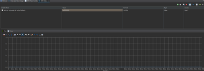

Plot stay at 0
While table is indicating value changed:
This bug does not happen on all data. In this example, i am monitoring a variable inside a structure. gst_my_scheduler is a pointer to the structure. Another variable from the same structure does not seem to have any issue while it is the same kind of variable (uint32_t). What is suprising is that the table does display correct data, it is really the plot that is not displaying proper data values.

Other captures for the differences between table and plot. Signal is basically a ramp up from 0 to 4 and data is updated every 1ms.It is basically as the plot is undersampling my signal compare to the table. Sometimes 0 and 1 is not displayed, sometimes it is 4 even if everything is correct on the table.
