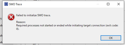

Is it possible to use SWO trace on this development environment conditions?
[condition]
  • MIMXRT1060-EVK
  • Debug using LinkServer proves
Checking the SWO trace status, it seems not working?
Do I need to configure something on the MCU?

kenji
Hi @jingpan -san
Thank you for the sample code.
But not works.
I get the same message with own project.
This is the message when press "resume data display" button.
Your code doesn't seem to have any special settings, right?
I'm using  LinkServer proves for debug. Can SWO be used with Link Server proves?

lpcxpresso_supp
Please take a look at the following article: https://community.nxp.com/t5/MCUXpresso-Community-Articles/Overview-of-using-the-MIMXRT1060-4-EVK-wi...
SWO is supported only by LPC-Link2 firmware, not by DAP-Link.

kenji
Hi @brendonslade -san
Thanks to you I could ran SWO.
However, port for SWO trace, has use same port for PWM in my application.
So I try to use "IOMUXC_GPIO_B0_13_ARM_TRACE_SWO" port instead of "IOMUXC_GPIO_AD_B0_10_ARM_TRACE_SWO" port, but not works.
Do you know how to use "IOMUXC_GPIO_B0_13_ARM_TRACE_SWO" port for SWO?
Or is it unusable?

jingpan
Have you set GPIO_B0_13 pin mux to swo? GPIO_B0_13 is a boot config pin. On RT1060 EVK, it is connected to VDD or GND.
