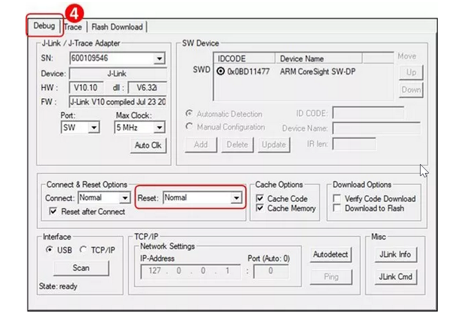

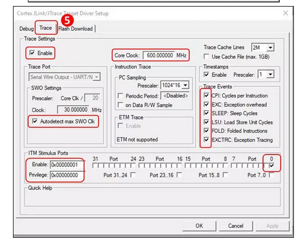

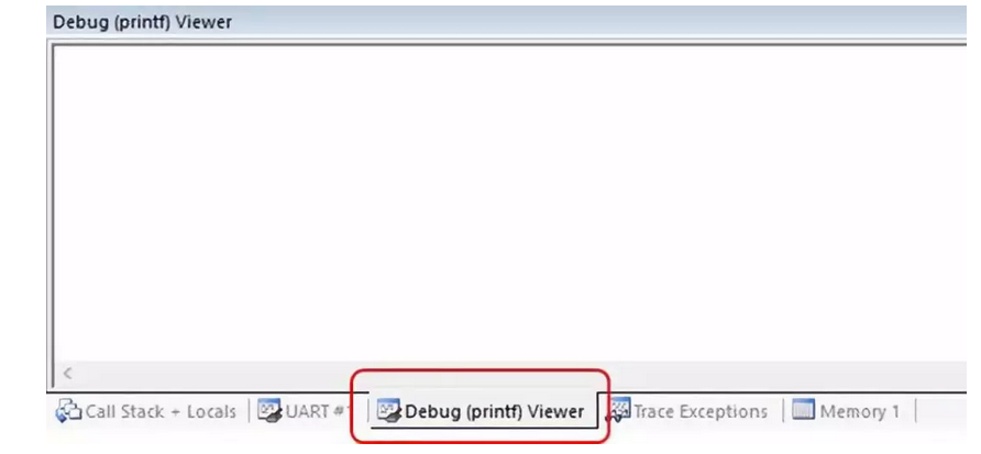

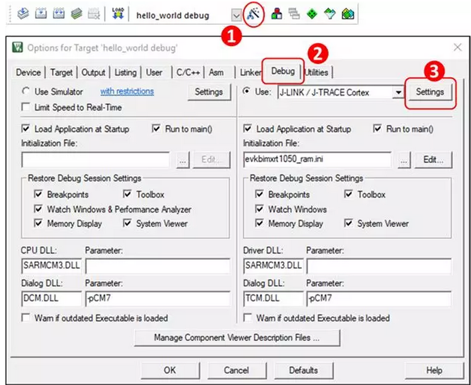

3. Configuration IDE:
enter debug mode, open View-> Serial Windows -> Debug(printf) Viewer :
4. add send code, for example :
while (1)
    ITM_SendChar('b');
    ITM_SendChar('C');
    ITM_SendChar('D');
