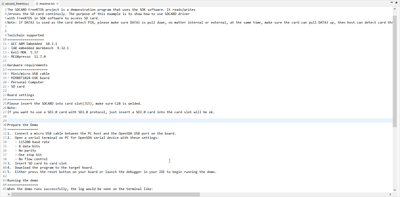

Regarding the issue, I do not have the exact clue on what's going on, but I am wondering if you have already tried to run the sdcard freertos example from SDK to try to read/write your SD and avoid the errors?
Here is a capture of the readme file so you can make sure to follow all the steps to run the demo and see if it is not a hardware issue.
Please let me know if this demo runs successfully on your board to discard HW issues.
