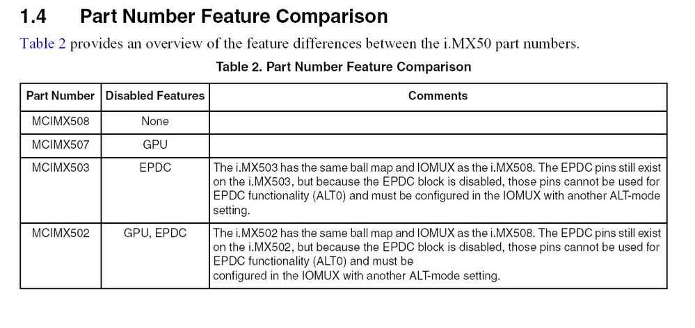

Hi Experts,
The product comparison link http://www.freescale.com/webapp/sps/site/taxonomy.jsp?code=IMX50_FAMILY&cof=0&am=0&mvf=p31~USB&eop=i... contains the column "Serial Interface Type" each of the parts specifying ethernet/USB/SPi.
What is the definition of the column provided ?

igorpadykov
Hi lyf
all parts are identical (link column provided is not accurate), differencies
are given in IMX50CEC p.8
igor
